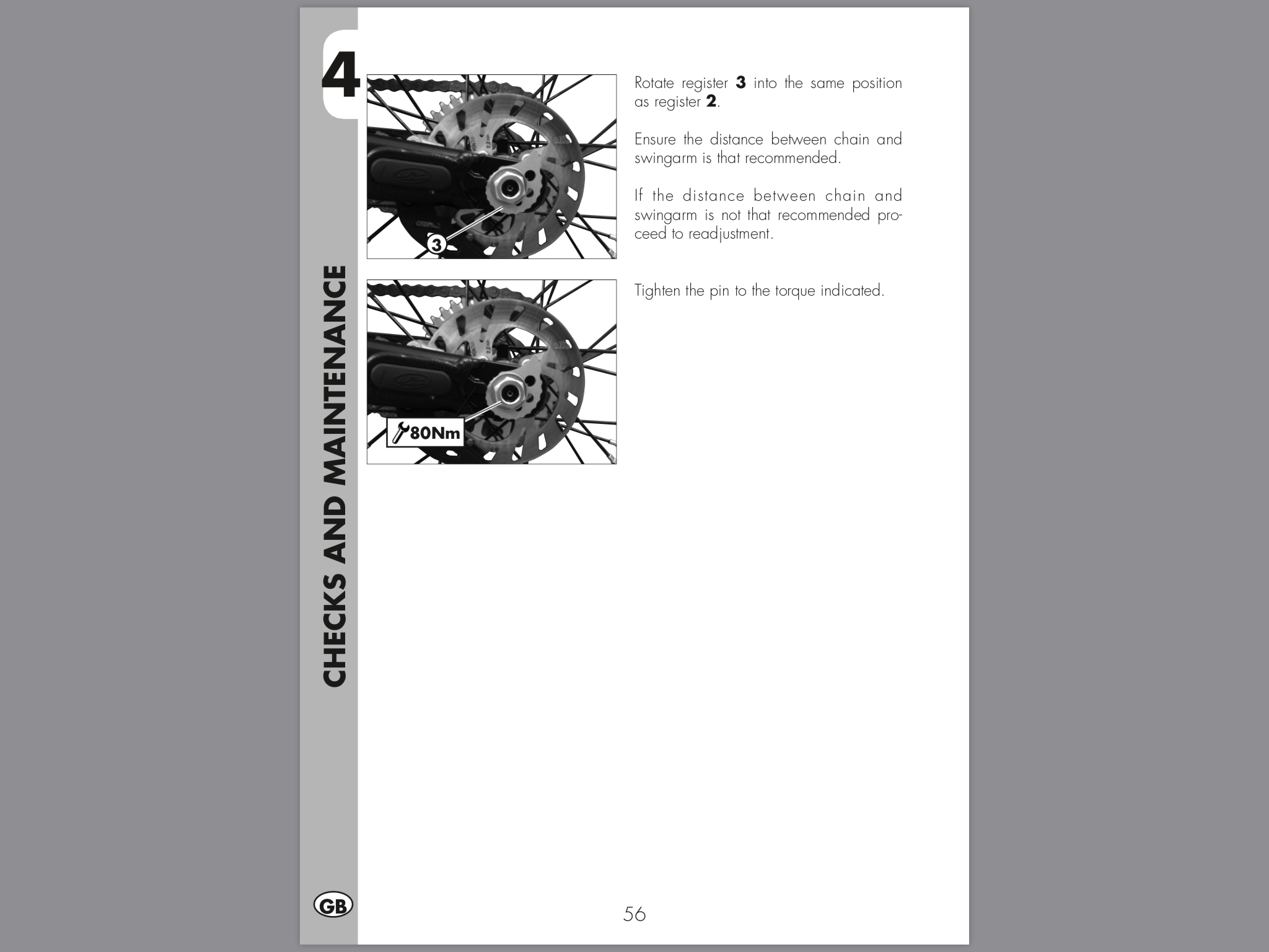

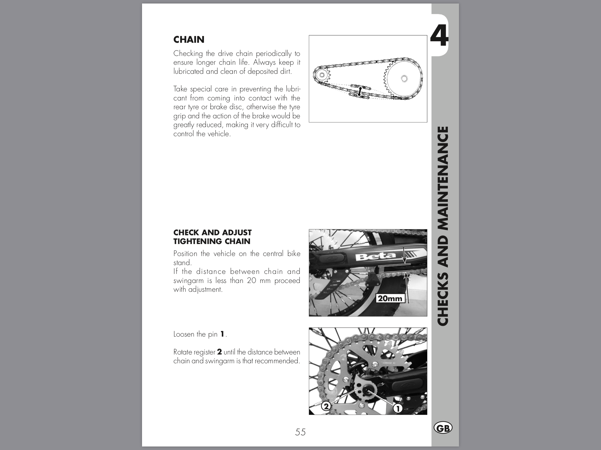

Hi! I would really appreciate if someone could help me at setting the right tension on my 2018 Beta Evo 200. I cannot find any video on it or pictures with comments. Thanks for your help!
As a rule of thumb (finger?) aim for a distance of two fingers width between chain and swinging arm mid-way along.
