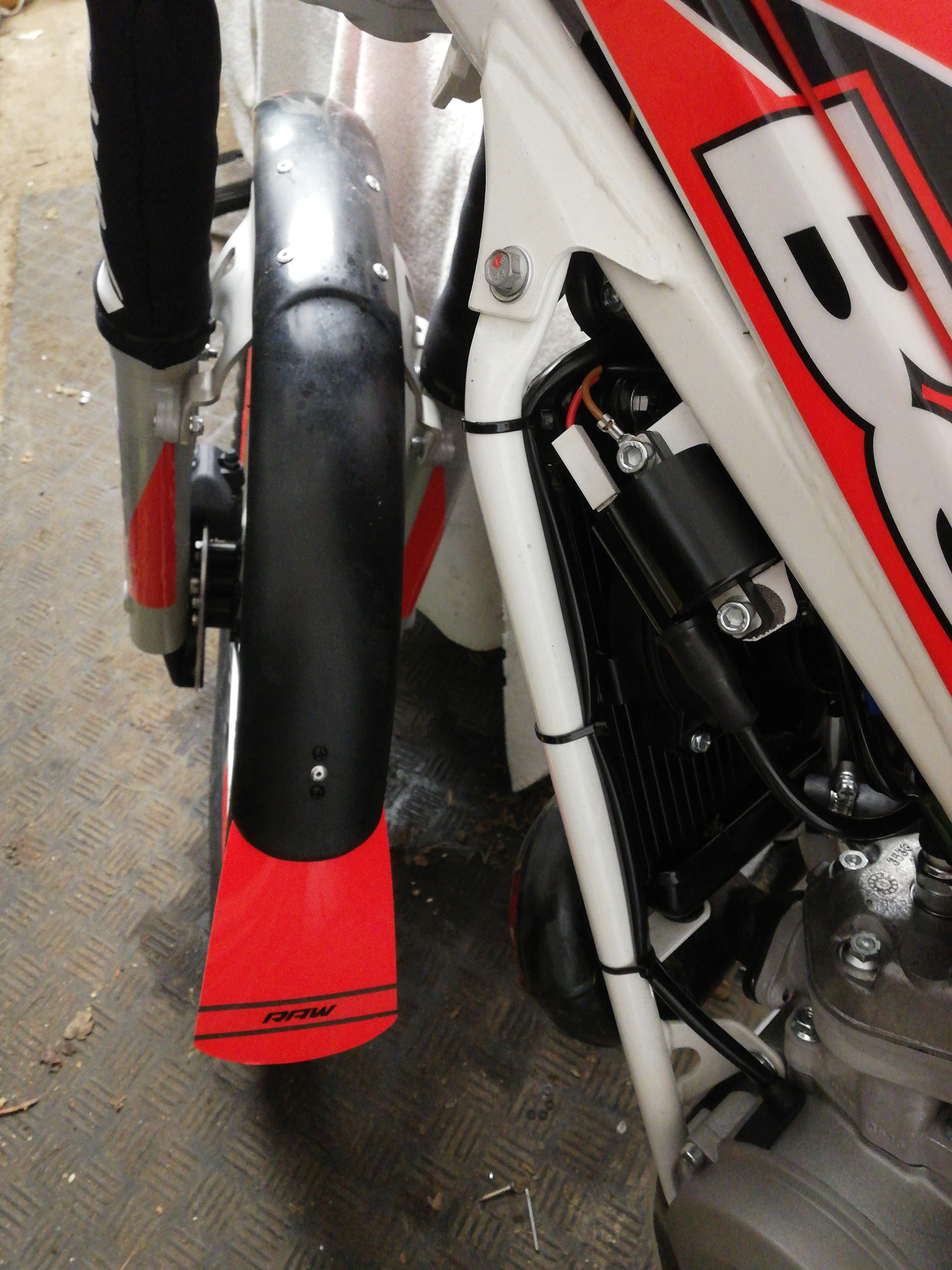

Beta 80 medium wheel mods.
Fitted this before the trial yesterday, brilliant mudflaps made of a seemingly  really good material. I've left it long to see how it would be. It stopped the radiator filling with crud, it got none in it at all and it was a messy trial in a few sections. It also matches the new beta colours perfectly!
 Cheers for the head's up Rob.
Glad it worked for you, we have been really happy with them. Only issue on bigger bikes is if it catches things when the suspension is compressed but on the smaller Junior Beta’s it has worked well for us and looks good to. Did you get anywhere with the rear suspension between junior, senior and 125’s? I checked the Beta website and they all have different part numbers so that maybe down to spring ratings but be interested to know if the Junior 80 Ohlins will fit the big wheel as I was informed it would not Cheers Rob
