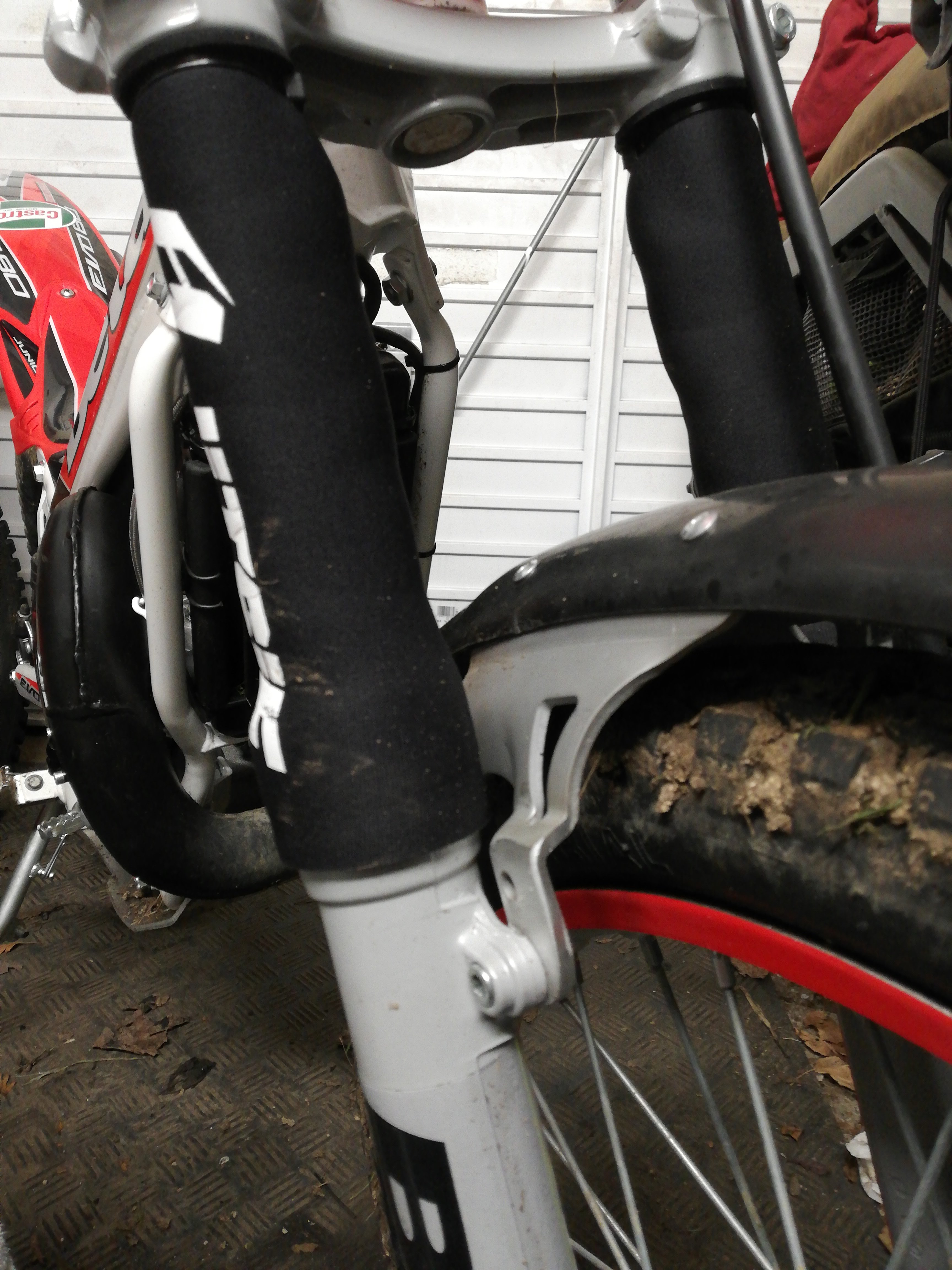

Thought I'd share this after so many helpful replies.
 Basically, if you are a new purchaser of a Beta80, you will find it near impossible to ride in the UK without modifying the front mudguard for extra clearance. I got a local fabricator to extend the standard mudguard mount. Cost me £50 but it's job done and looks nice.
