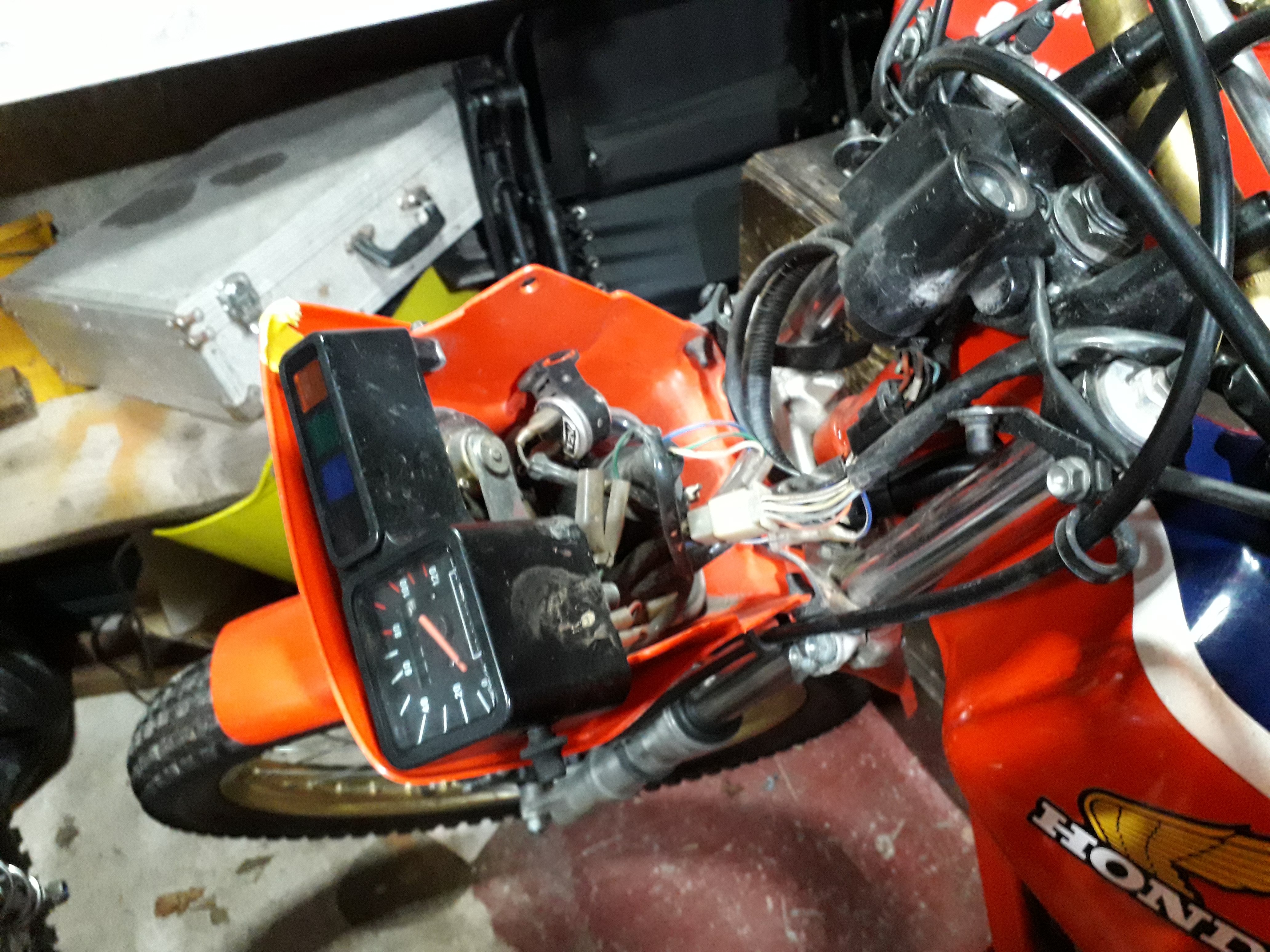

Hi all. After many bultacos i have bought a  1983 honda tlr200 to use in twinshock events, taking a bit of time to get used to four stroke but a really nice bike to ride I have  serviced, changed tyres etc.Now have stripped lights, speedo, indicators etc  back to push connectors on  wiring loom.I need  to fit an engine stop lanyard for some events, is it simply a case of following two wires on original kill switch back to loom and connecting on replacement Jitsie etc at this point?.  I would like to strip out old key/lights loom and simplify some time in future as strictly off road use now, anyone done this? got any pointers?

Hi Stuart, a lanyard kill switch is a direct replacement for the original kill switch which was fitted to your bike.
Disconnect the original kill switch and connect the two wires from the lanyard switch into the same connectors in the wiring loom.
You might have to change the connectors on the lanyard kill switch to match the loom connectors, or solder the wires together.
It doesn’t matter which way round the lanyard wires are connected, as the kill switch shorts out the coil live feed to earth.

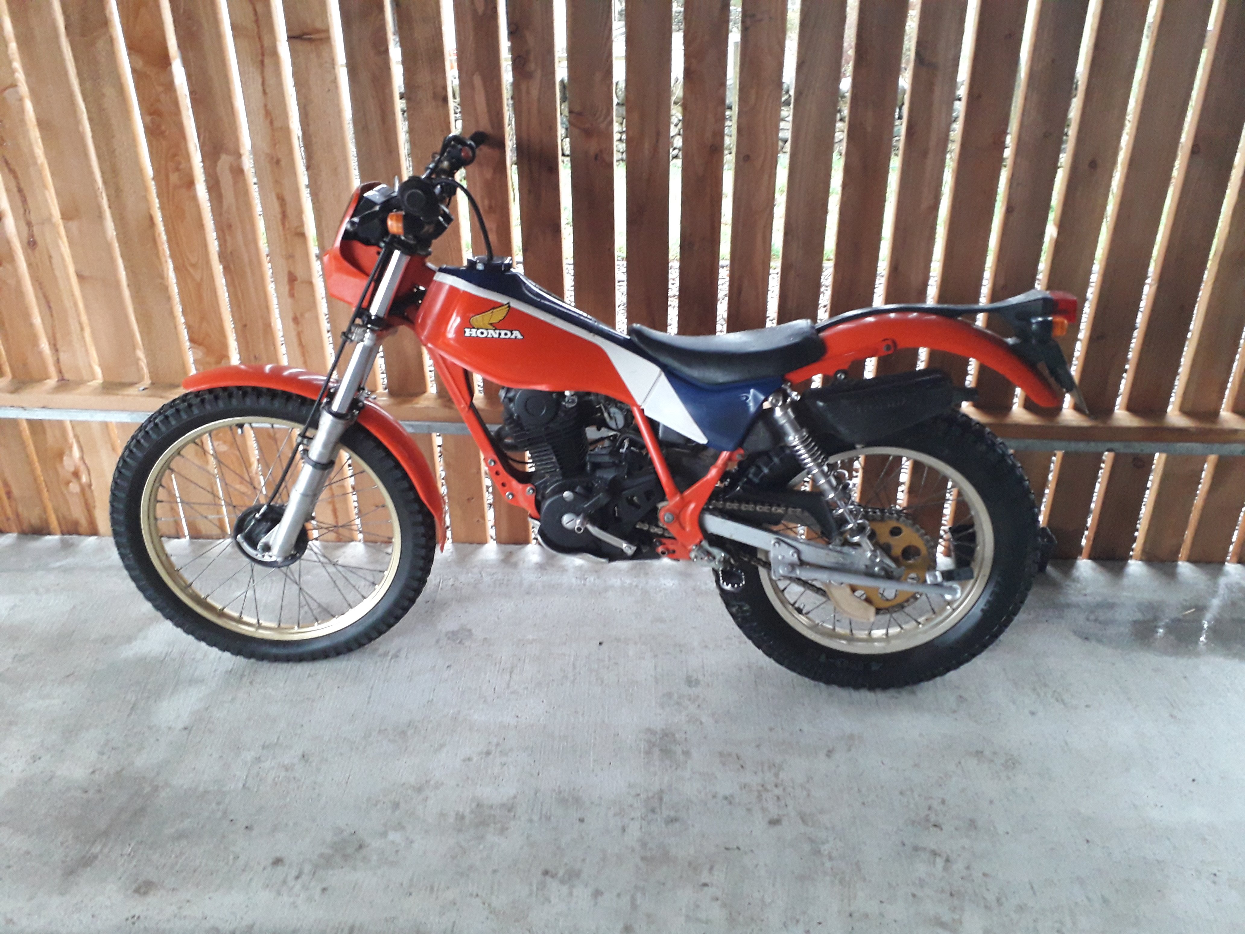

dabba,Thanks for informative  reply, i have ordered a  lanyard switch and will hopefully get it fitted this weekend.looks as good without lights etc, see pic. Stuart.
