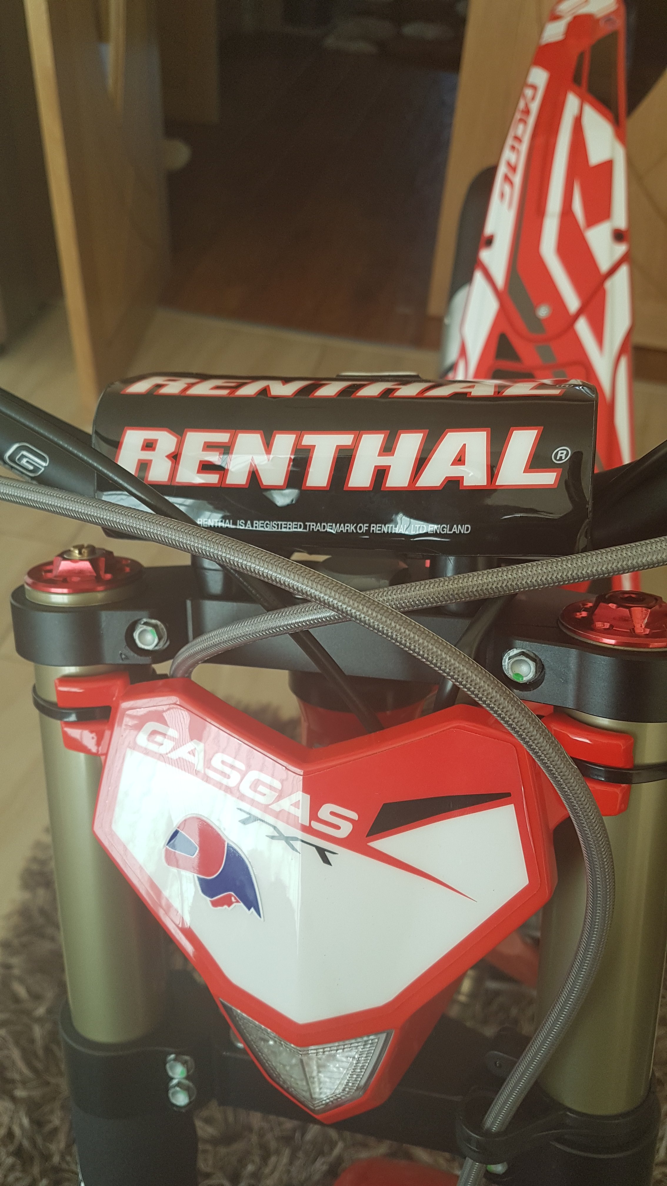

Just confused as my lad has just picked up his new bike and it seems one of the folks sits higher than the other measuring up from the yolk there is about 5/6mm  difference

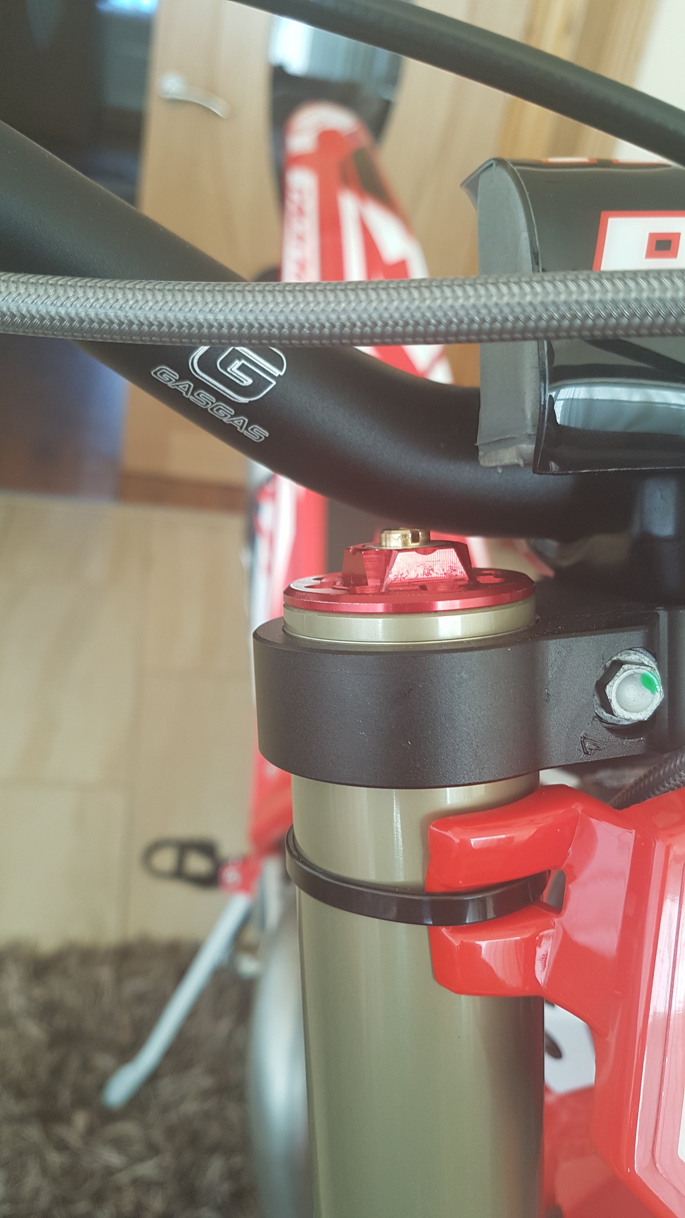

As you can see they aren't level, is this wrong?
Edited by betaboy100
Well where there left fork is positioned there is a tiny line around the fork (the right has this also) so should the right fork be moved up to that line?
Just spoken to the dealership i got it from and they confirmed that the right fork needs to be moved up to the line. He said you should be able to see around 5mm above the clamp thing?
