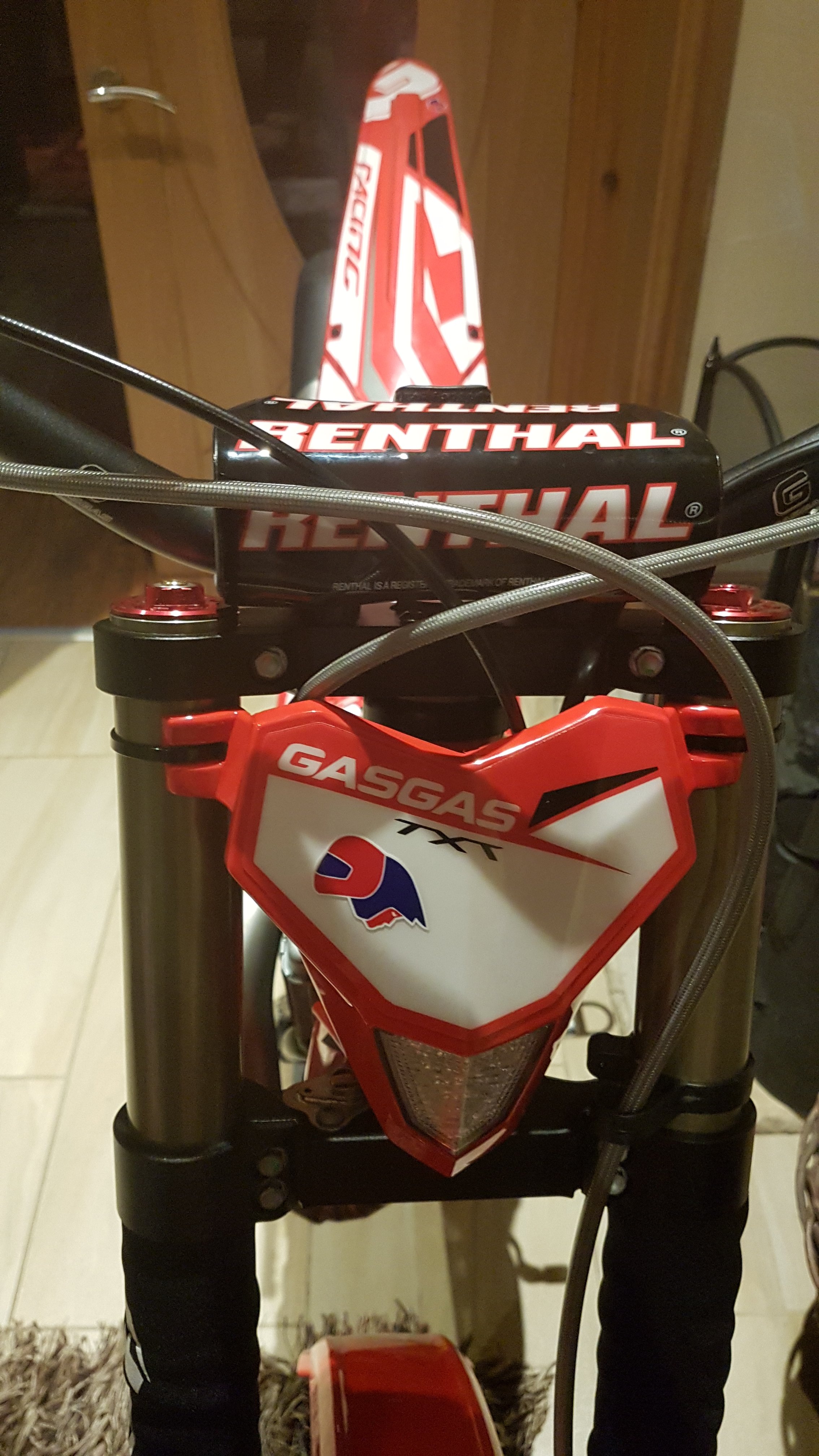

Front folks
There's no "right" or "wrong" position, but the two forks/folks :) need to be equal. Sliding the forks up the triple clamp will slightly increase the rake and make the bike turn a wee bit "faster" (but be a bit more "twitchy" when trying to go straight). And the converse is true when the forks are pushed down the triple clamps. I believe the top of the fork >tubes< should never be lower than the top of the triple clamp.
Edited by d2w
You got options to move them up or down a bit to alter the way the bikes steering and weight feels (if anyone was that sensitive, not sure I'd notice a difference), because one fork is spring and one is damping they don't sit at the same heights when off the bike, just undo the clamps and make them equal heights.
