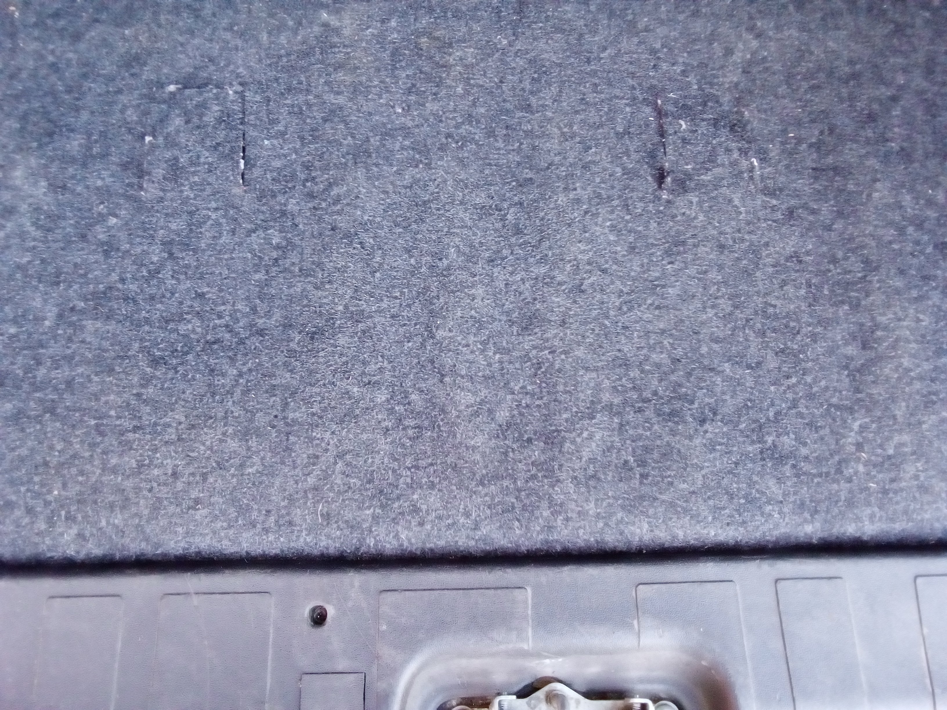

August 5, 20197 yr Author I have just had a look at the car and I think you must mean "The door shut"(closed) and not "The door shut" (jamb). Please excuse my stupidity but I do not want my bike trying to get into the front seats in the event of harsh braking or worse. I have looked under the carpet and there are two depressions in the sound proofing where the seat locating loops for the sixth and seventh seats would be. I will dig one out and see if the loops are there or if Fiat saved a bit of expense by not fitting them. Thanks

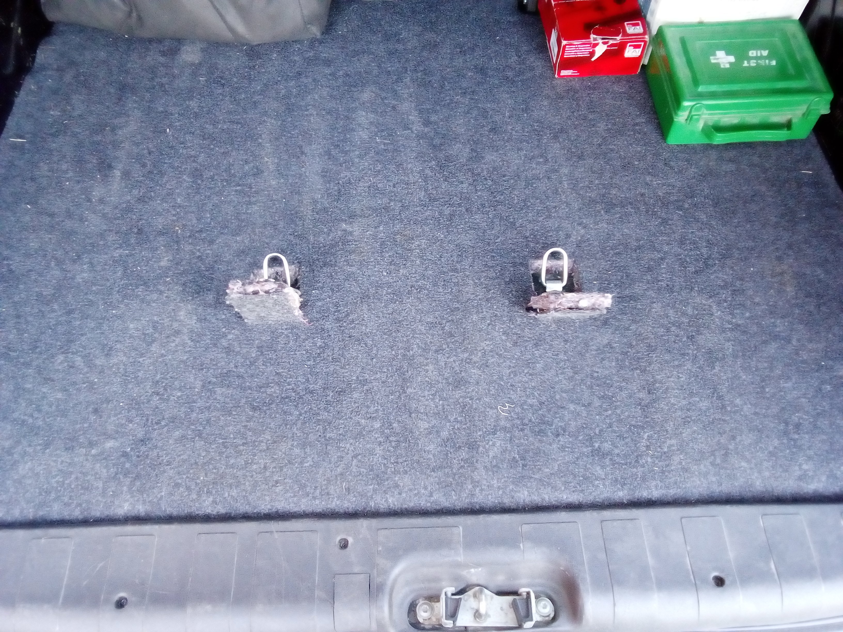

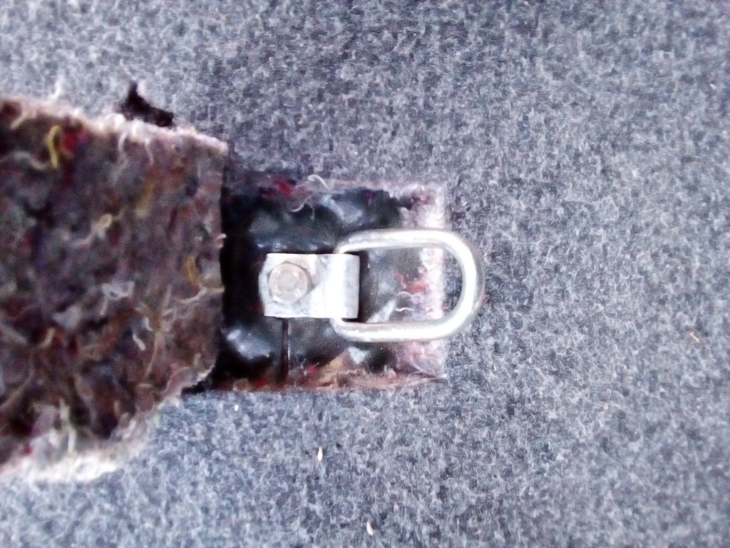

September 21, 20197 yr Author Couldn't find out anything about the fixing points so I decided to drill the floor where the depressions are 8mm. I then bolted a folding tie down ring with a long 8mm bolt with a large penny washer and shake proof washer underneath, these go through a cross member. I now feel a bit more confident that the bike will stay put......... What about the carpet when the bike is muddy?????
