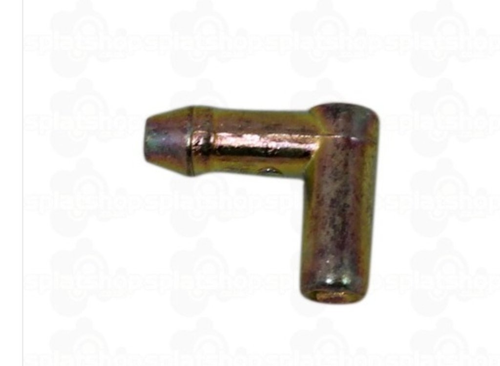

Screenshot_20200110-125532_Chrome.thumb.jpg.dd680427f38e10d1e2eeac71abf77547.jpgHi my 2003 280 had a 90° nipple coming out the left side crankcase which is broke off. I see i can get a replacement but wondering what the best way to remove the old and install the new?
They're a press fit, so I'd suggest using a suitably sized sheet metal screw; thread the screw into the remains of the tube, and then grab the head of the screw with plies and pull gently. Or simply drill it out (without going too deep with the bit into the case).
