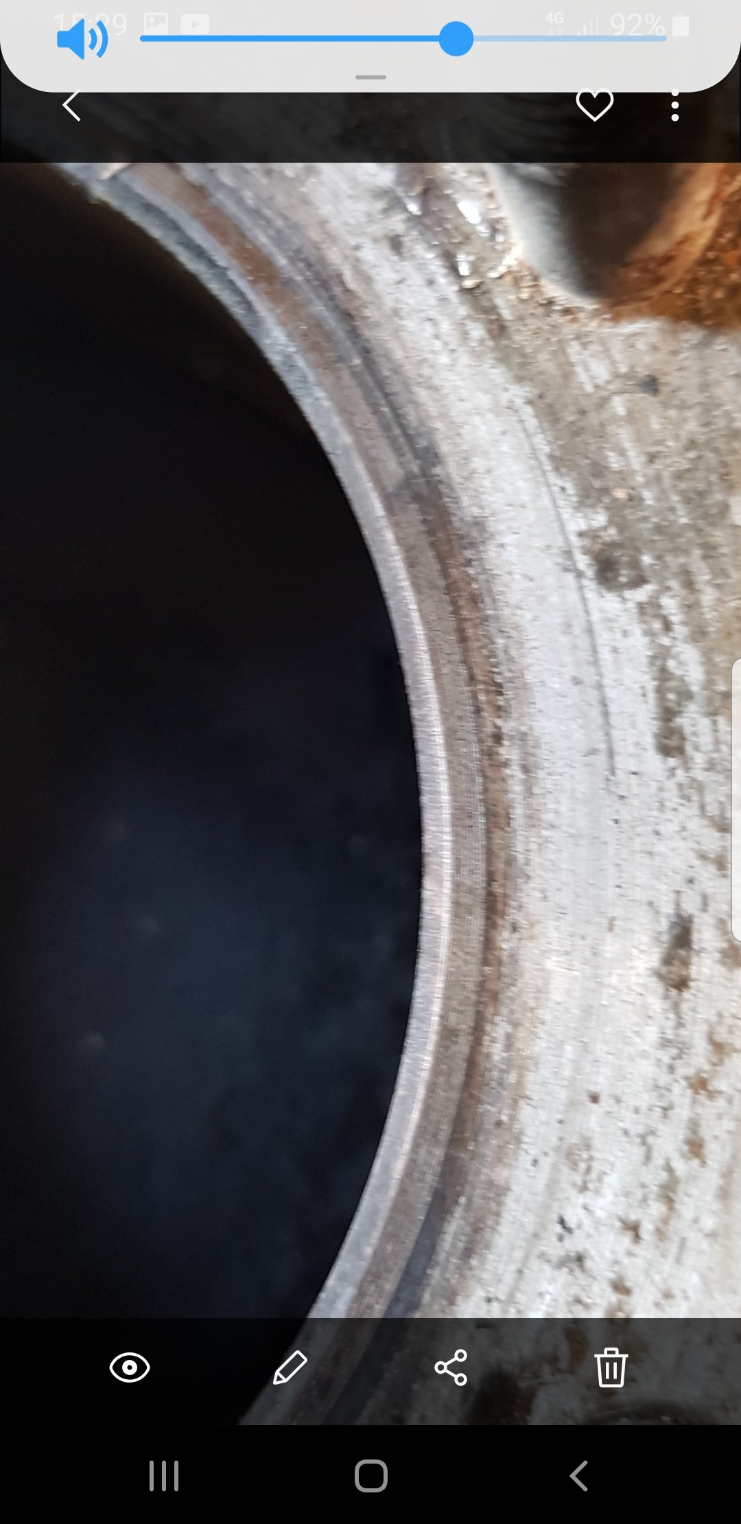

Hi all just been looking at this ty250  I have , do you think this has been sleeved  down???
If you look where the sleeve meets the aluminium casting at the transfer ports you may be able to see if the sleeve has ever been replaced. This is because on Yamahas the aluminium part is cast around the sleeve but when it gets resleeved the old sleeve is completely machined away and the new sleeve is inserted.
What is it about the cylinder that makes you think that it once had a sleeve for an 80mm piston?
I took  my bike to mick Andrew's  and sam brownlee,  mick asked if it was 80 mm bore , I had had the head off before  and new it was 70mm. They told me about the barrels that jonh shirt did and said you might see this as a thin ring.
It says  on here  the works majesty engine barrel was  standard barrel  took to 74 mm and a liner back to 70 . This was what I was referring  to,

Can't tell from your photo if yours has been resleeved.
Be aware when you resleeve a motor the sleeve usually has a shoulder at the top to stop the sleeve moving downwards through the cylinder, so if you are going to measure the OD of the sleeve, measure it at the bottom end.
It was because mick and sam said about the sleeve and how to spot it, ie no mention off stepped  sleeve and the reading of above artical of a 2mm wall  thickness sleeve. You can see the sleeve on the bottom of the works barrel  clearly, I just did not want to pull my engine down yet to inspect further.

Just spoke to mick about the barrel, he said sam could not remember if one was fitted to my bike and sam would have to inspect the barrel to see. It would seem they only did about 6 of these barrels due to expense!!
