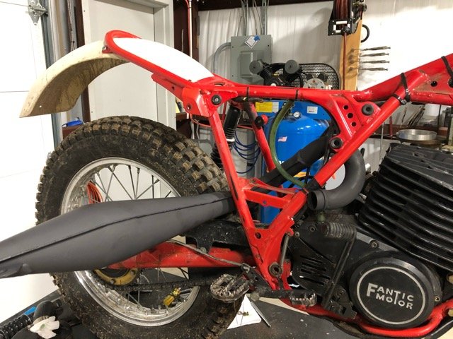

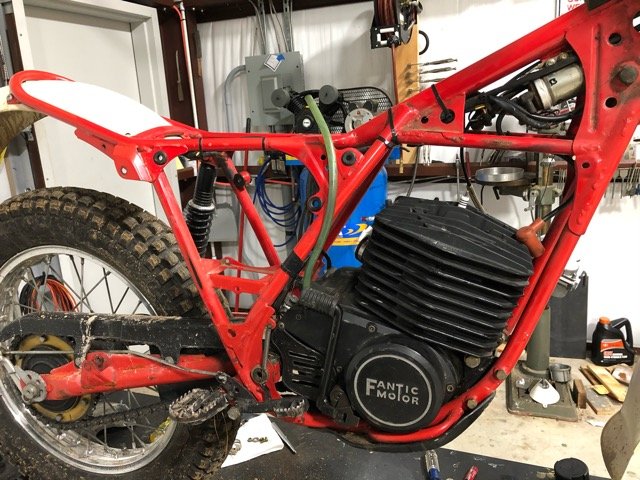

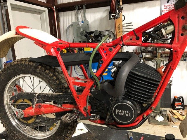

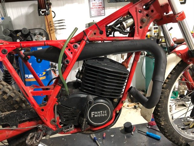

Thanks to Chylowen's written instructions about how to put a 240 pipe on without removing the head. While I did it I took these pictures to supplement his instructions. The last picture shows the inlet resting on the down tube, a little push and it cleared. It took longer to remove the necessary parts than to put the pipe on. Very easy to do.  Thanks Chylowen!
