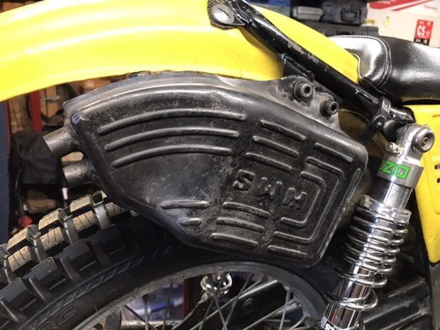

Anyone have any suggestions on a aftermarket muffler for my 1980 TL320? Thanks
If you don't care about the rather specific look of the OEM part, about any mx silencer will work OK.
Best thing would be to reopen the existing and refresh the exhaust insulation and the clogged internal hole tube, then do the same with the rear exhaust where you can too replace the inner baffles against a bigger hole tube and insulation (likewise the Jumbo has).

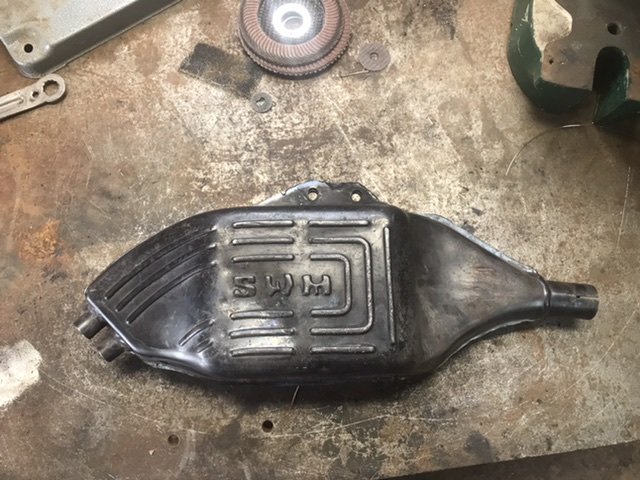

  I really like your exhaust set up! The fact you can repack it without having to weld it again is nice. I do have a DC tig I recently picked up (it’s actually a 3 in 1, plasma cutter, dc tig and dc stick welder). I don’t have the Argon tank yet. Not that I couldn’t weld it with my mig, I just think it would look better with tig. I just don’t know if I’ll have time right now to build it like I want. Was hoping to find something to use until I have time to fabricate the old one. What are you guys using for a new perforated tube?

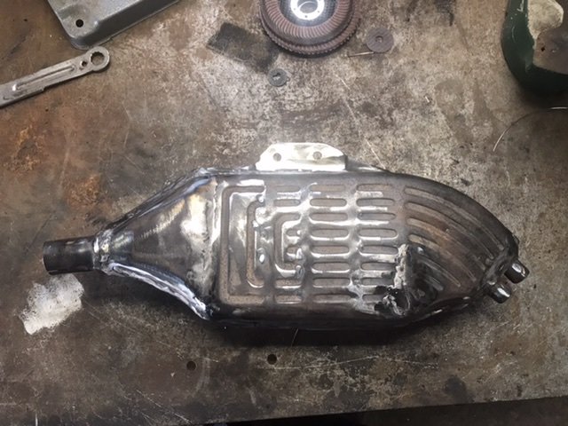

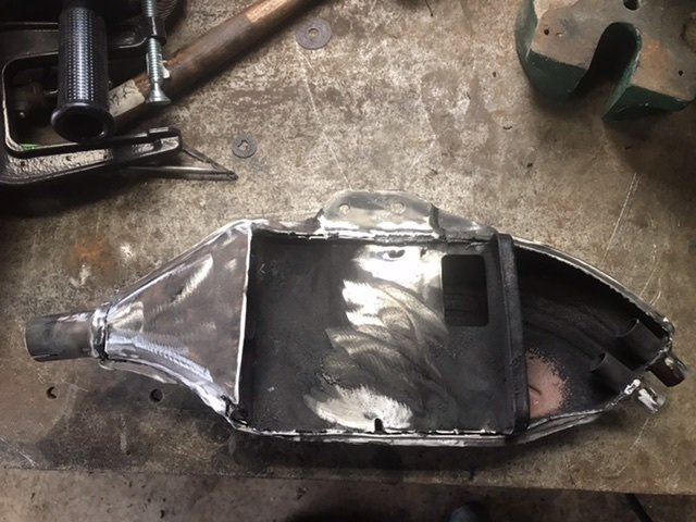

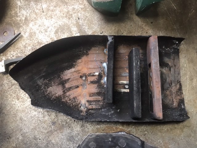

I ended up cutting open my stock muffler with my plasma cutter and Dremel tool, worked good. Re tacked all the baffles and welded back up. Didn’t turn out too bad, wish I had a tank of Argon for my tig and done a little neater job. I might go back over it with the tig before I paint.
Installed on my bike after repair.
Edited by dozerash
Looks almost OEM, I hope it sound the way it should, too. Good, old fashioned work (no nasty tricks, like mine...).
