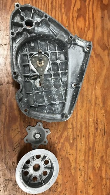

  I have a newer style clutch cover with the larger actuator balls I would like to install on my 1980 SWM TL320. I would like to see if it does pull a little easier and my original cover has a small crack in it and needs repairing.  I also have the newer pressure plate. Do I need anything else? The hub from the ATK (Rotax 244) parts book has a different part number than the older style SWM. Will I need to change that too? Thanks
Edited by dozerash
I found out I can use the newer cover with the larger actuator balls with the older style clutch. But the clutch works even better with the newer style inner clutch hub and pressure plate. I had the pressure plate. I found the newer inner clutch hub at my local trials shop, picked it up yesterday.

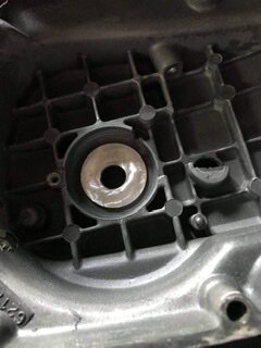

This set up works well on my SWM. I’m looking to modify two other bikes I have. Not having any luck finding the newer style actuator parts.
