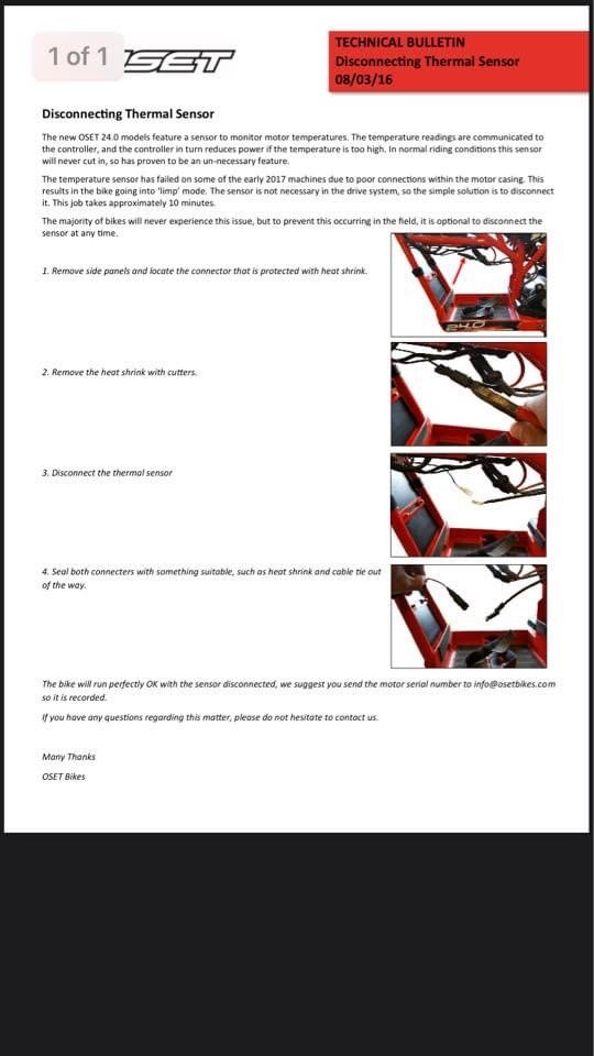

How long do you get before the top LED starts blinking? My 24R is 3 years old and during the summer the ride time starting dropping so I replaced with the Boost Battery. When the top LED starts blinking under load the performance drops. I get about 7 miles before that happens. The past few weeks I did some fast trail riding and after 6-7 miles the thermal cutoff switch would trigger and cut power to 1/4. LEDs would show full power and after cooling down it would run fine. I never did trail riding on the stock battery so I don't know if the Boost battery is making it overheat. It never overheats when I am doing backyard trials riding. I was wondering if the stock 48 volt would be better for fast trail riding with all the dials turned to full or maybe I need to turn down the power level with the Boost.

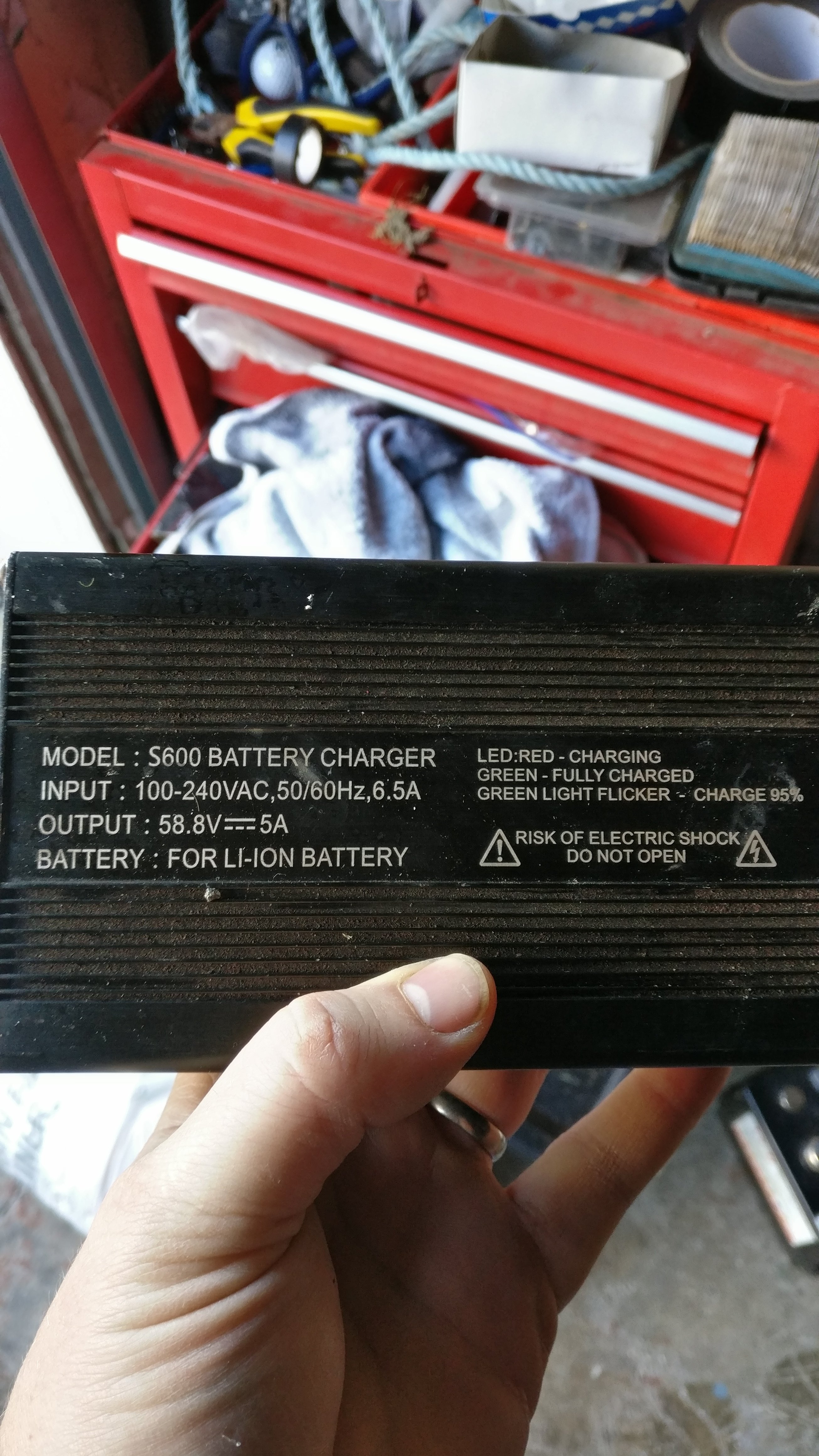

It sounds like you have a battery bms problem. out of interest what do your charger say is the output voltage is?,  as 56v is to high for a 13s battery and to low for a 14s battery, this can also be caused by the battery bms ( not fully charging the battery ) but it may be the wrong charger.

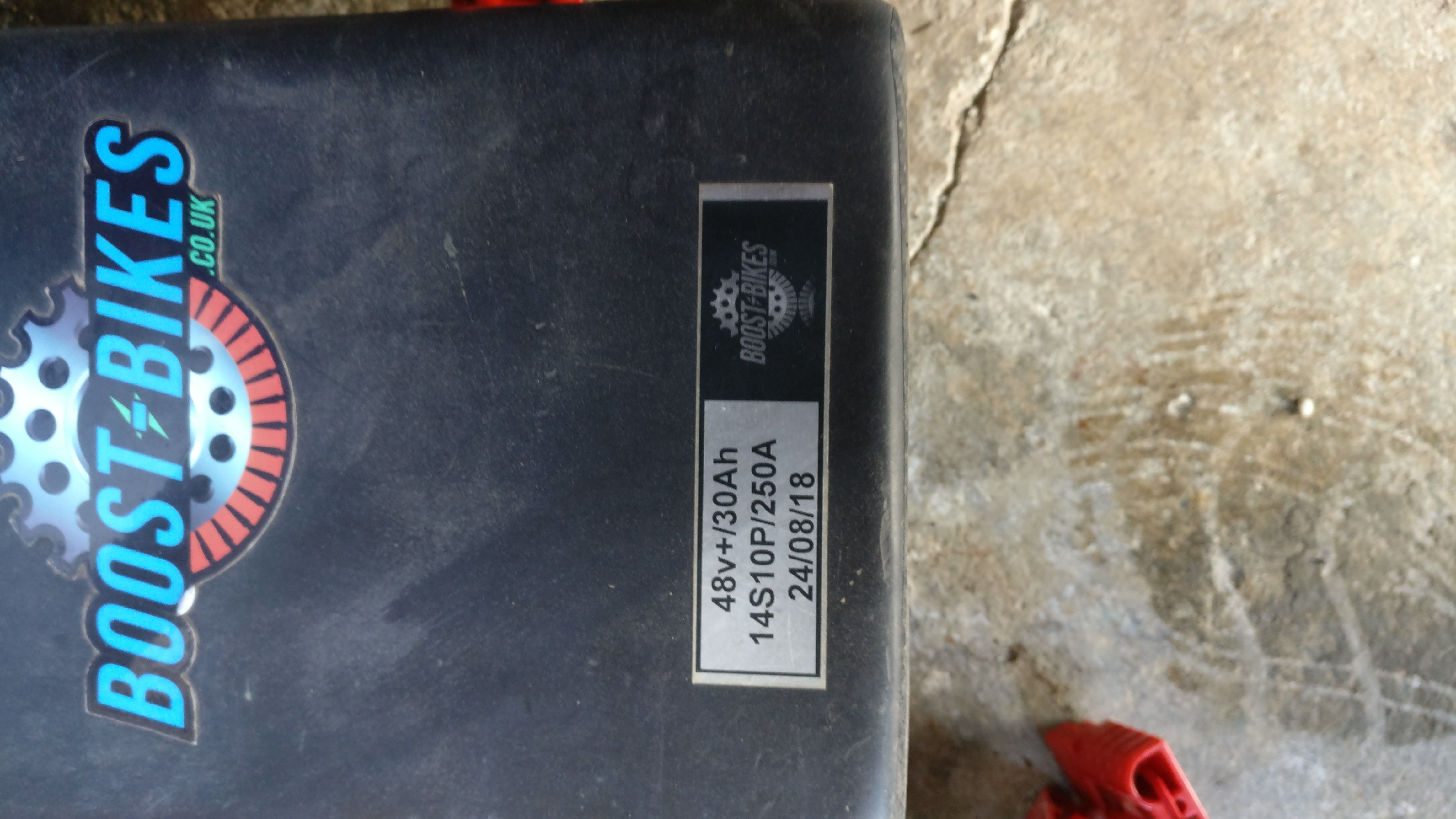

Photos attached. I have contacted by Boost Bikes, and they mention IF it is an older version of the battery then it may be off balance...which could be the case....I think the battery is a 2018 so hopefully that is all it is and it will be sorted....I will let you know how it goes.
Thanks
ok so if your battery is only getting to 56v then this is way to low, the only thing I can suggest is to leave the battery on charge for at least 24hours then measure the output to see if this increases the battery voltage... i advise charge in a fire safe area i.e outside some where, dont charge indoors for this long!!. final fully charged voltage should be 58.8v
I bought my boost battery in 2020 and the charger is way bigger that the stock one. 9”x3”. It looks the same as yours but mine has a laser printed label with a different output spec of 8A. It also says “battery type suited: 14S Li-ion battery pack. Maybe I have an updated charger.
When riding, if the motor gets too hot to touch, the thermal switch is likely to cut power. I installed cooling fins and a meat thermometer and plan to get a bar mounted digital one. When the motor starts getting hot I’ll pour some water on it.
I think the the higher amp output reduces the charge time. I replied to Boost bikes with the info he required, we will see how good the backup is...
yes a 8 amp charger will reduce the charge time.... I think you have a few cells with in the battery that have got very out  balance and thats why it is cutting out at 51 volts it should cut out at around 44v for a 14s and around 41v for a 13s. Worst case scenario is that there a few duff cells in the battery. this can be repaired, but you do need to check the voltage output of your charger it should be 58.8v if its lower then you battery will never charge to full capacity anyway.

I just found out about this recommendation to cut the thermal switch wire. Mine is a mid 2017 model and goes into limp mode when riding fast. Does anyone know if they got rid of the thermal switch in the newer models? Mine has three wires coming out of the motor.
The US Oset importer responded to my question and said the bulletin was intended for early lithium models to diagnose if they have a faulty thermal cutoff switch that cuts off too early. Otherwise, not advised to disconnect or risk burning up the motor. The sensor goes into limp mode at 194F and should turn the motor off at 212F.
Another tip he recommended is to turn the key switch off on long downhills to prevent heat buildup.

Just an update on the 48v Boost Battery. I sent the battery back to Boost Battery (who coincidently on lives an hour's drive from me). He tested it and as it was built in 2018 and he informed me that that models BMS didn't balance the battery so a few of the cells were well out of balance. He has put in a new BMS and replaced the dodgy cells so it should be back to nearly 100%. I will let you know how it performs once I get it back. It cost me £135, £80 for the new BMS, £35 or the parts and labour and £20 for delivery by DHL. Cheers
So I got the Boost battery back and have tested. It now charges to 58.8v. feels very slightly quicker top end than the standard battery. I didnt get to see how long it lasted but I will be able to test sometime soon.
