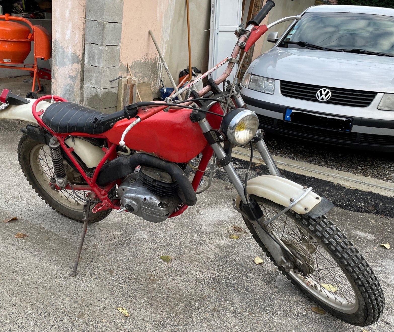

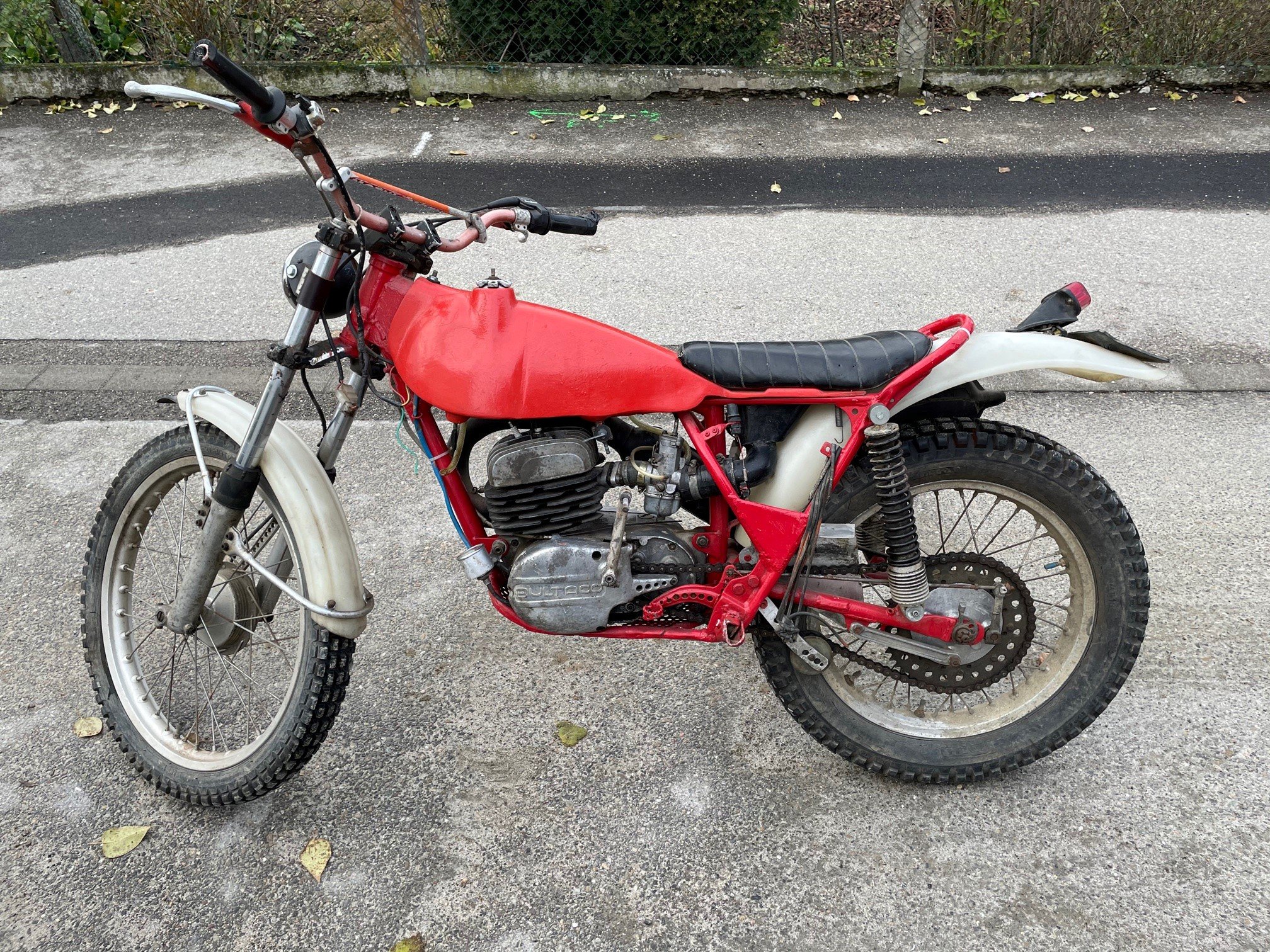

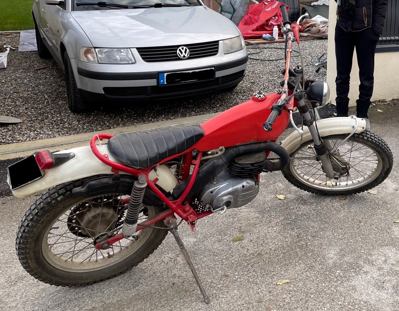

What type of Bultaco is that?
I just bought a trial bike a Bultaco Sherpa 350 but I don't know what type of Bultaco it is?
The tank is strange and if I compare with other tank from the opening is not in the center of the tank.
I have the paper and the bike build is 1975.

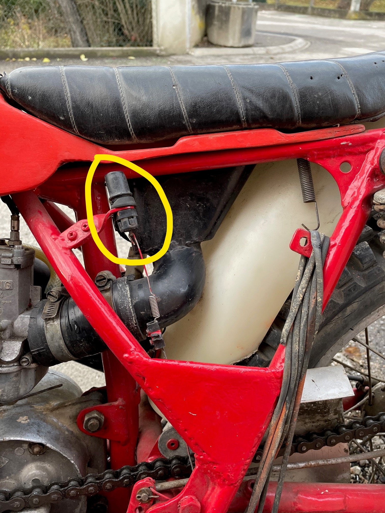

ON the last picture (yellow), what is this part?

It looks like a model M125 with a few alterations. The engine and frame numbers will confirm the model

I found the frame number and it begin with 125.XXX so woody you are right it is M125. Do you know where I can find technical date to be sure to restore the bike like original?

I'm not sure technical information will help much as it is more appearance that is a bigger issue if you want to return it to original.  Although you have a paper with build 1975 the M125 is a 1974 model which carried over into 75, so if you look for an owners manual it is for the 1974 bike, not 1975 as the 1975 model had small differences
If you google images for 1974 Bultaco Sherpa you will find an image of the original sales brochure which will help you see the original appearance
From a quick look these are the changes I can see:-
Brake light switch has been moved, should be on swingarm above chain tensioner
Petrol tank sidepanels and seat base have been cut off (tank and seat are a one piece unit)
Tank filler cap top missing
Rear mudguard brackets have been moved
Seat has wrong cover
Shock absorber bottom mounting has been moved
A plate has been welded in the frame V above the footrest

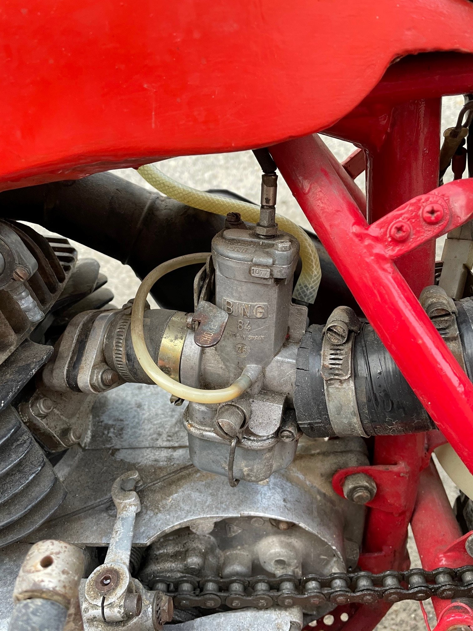

Wrong carburettor and hose, should be 627 Amal MK1
Wrong front mudguard brackets
Chain tensioner should have a pad not roller
Mudguards are aluminium originally
On the plus side, the main frame structure hasn't been altered, the engine doesn't look battered, wheels and forks are correct, exhaust is correct
