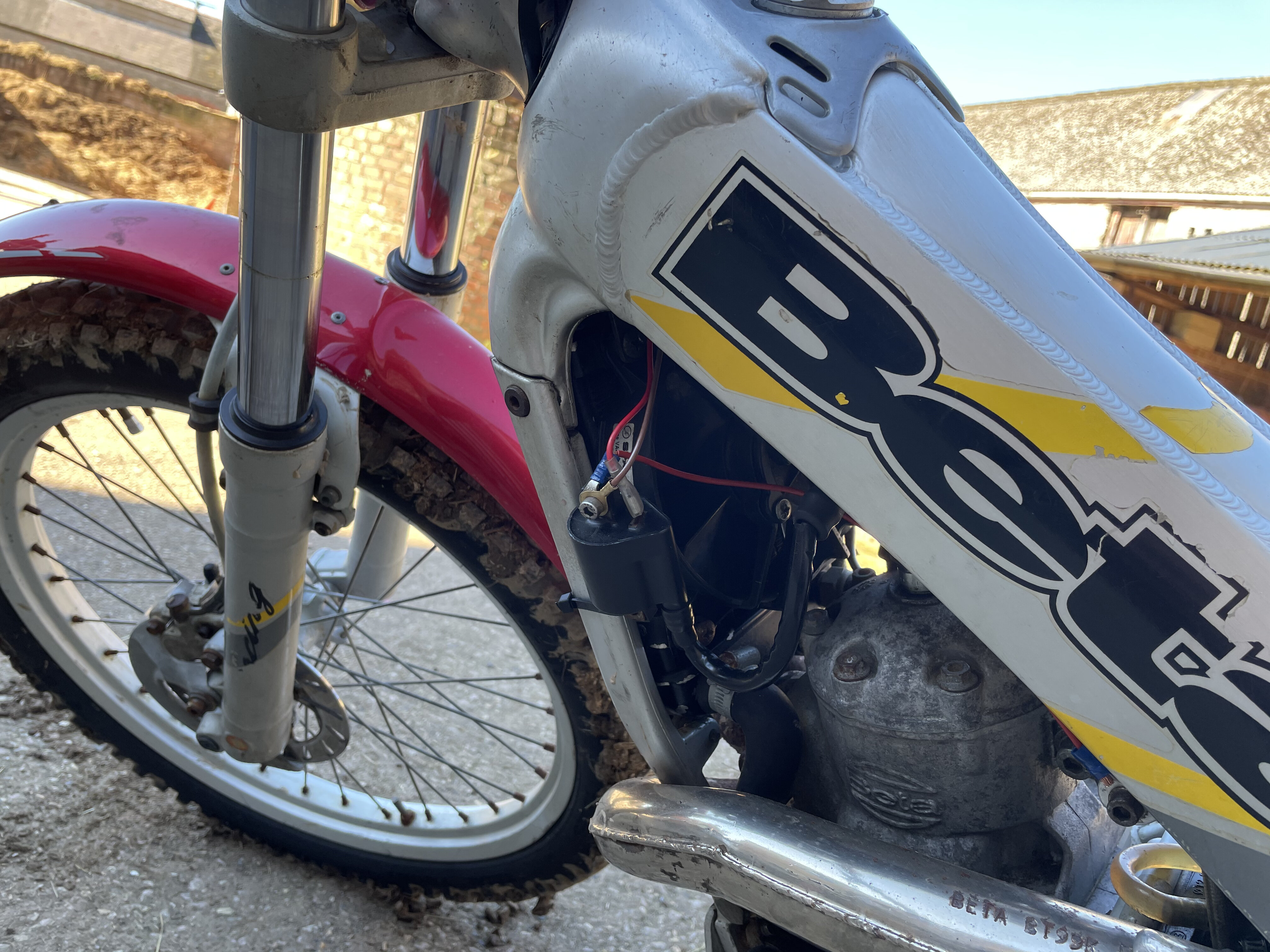

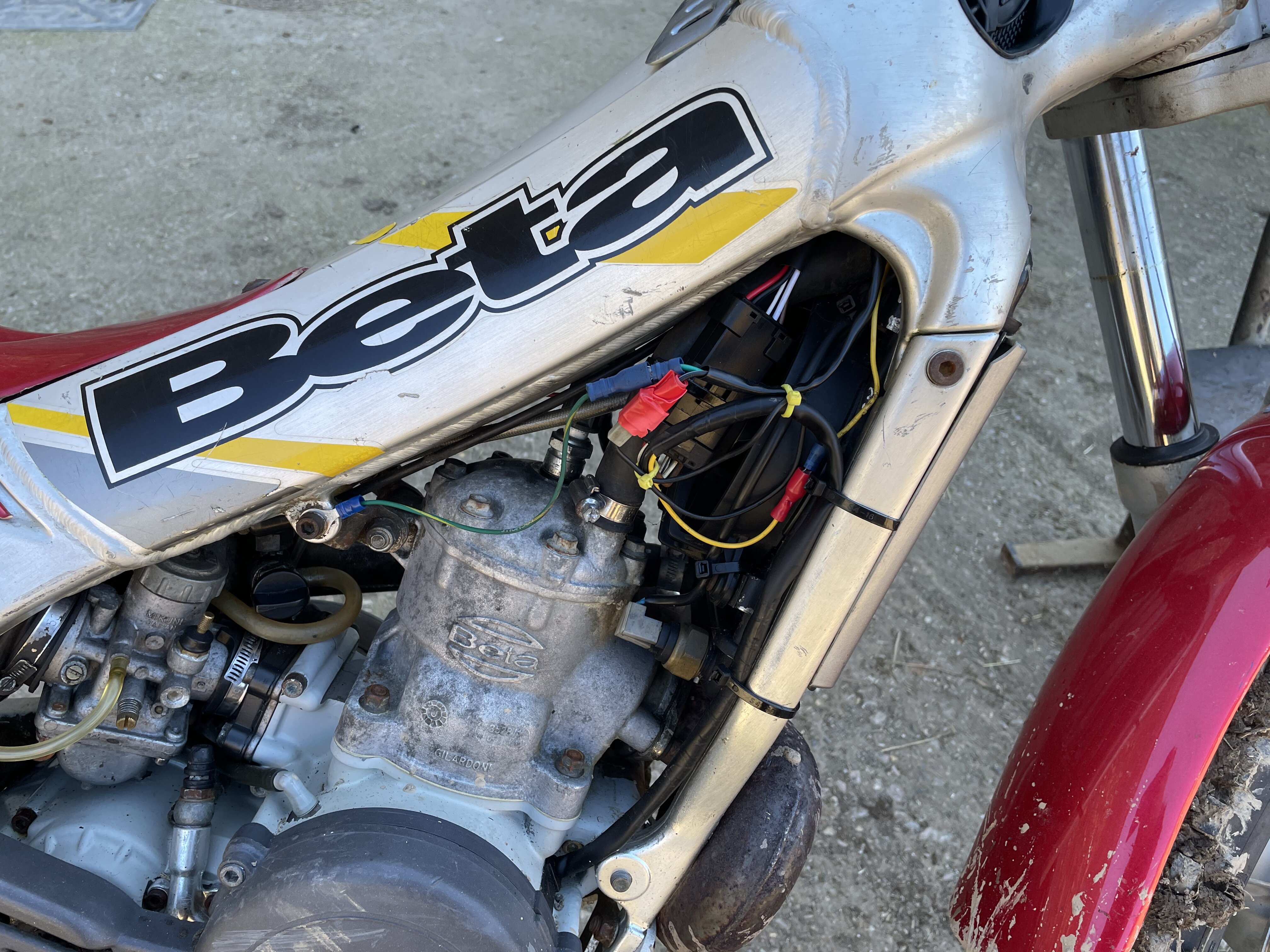

I got my self a 02 Beta Rev 3 250 which has got previous owner syndrome!
Can anyone help me by either explaining or showing me where the coil and other wiring should be located, I’m almost certain this isn’t located here for performance enhancing reasons!
The  cdi wireing from the stator goes up the left frame drop out between the radeator, it tucks in.  the cdi box and regulator etc are all  the top tucked away near the filler cap. The ht lead is usually ran over the fan frame and to the spark plug.
Thanks Creepytheclutchmaster, had a look last night and spotted a bracket right up inside the top of the frame.
