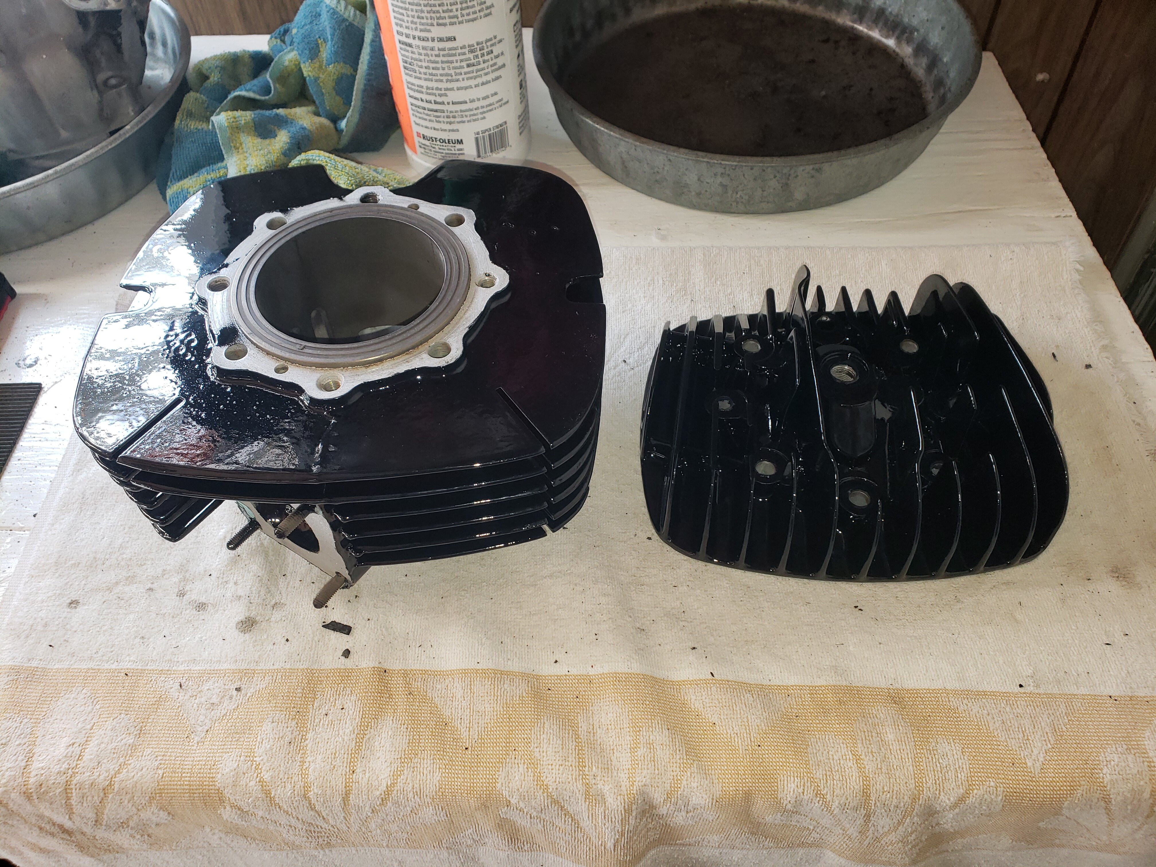

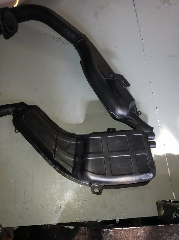

Head and barrel powder coated and exhaust ceramic, want the side cases looking good as well

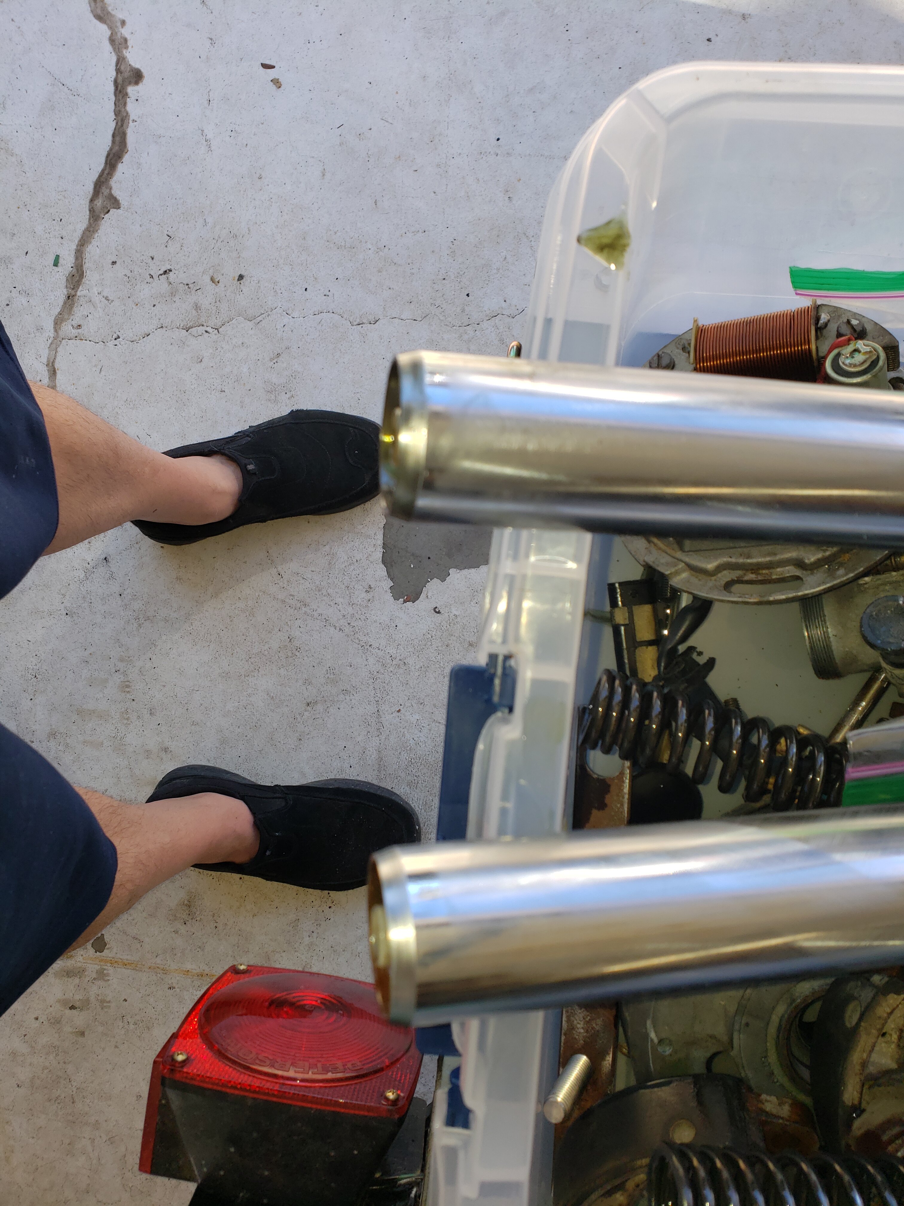

Was told this year should have straight tubes but mine have a taper on the end, are they interchangeable?
The taper referred to is at the top of the tube where it slides into the top yoke, what you see in the picture is normal for the bottom of the tube.
