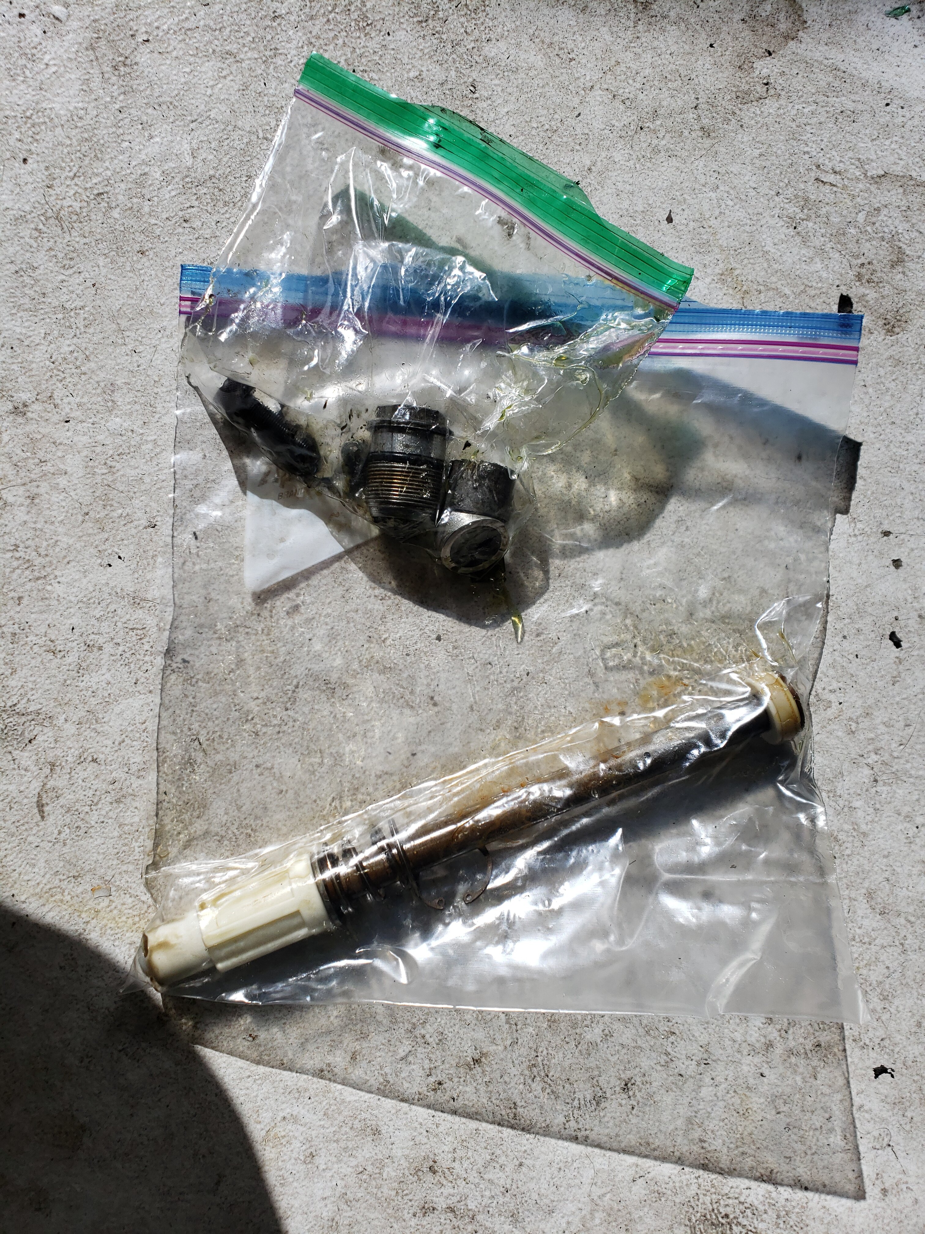

I see the aftermarket pistons dont have the holes drilled in the side, do I look for the correct piston or are the holes no big deal? Also my forks do not have the hat shaped sheet metal cap, is that needed or did mine not come with them?

Those hat shaped caps are spacers for adjusting the fork spring preload. Springs come in different lengths and those spacers allow you to set the bike up to have the right suspension sag. If the bike was being ridden without them, you may not need to adjust the preload. If you are fitting new springs you will probably need to adjust the preload.

The hat shaped sheet metal caps you refer to are oil baffles/deflectors (Bultaco called them "oil breakers")  ; AIUI their purpose was to influence the amount of oil coming out the top of the damper tube. You appear to have non-standard dampers, and I can't see how the caps would fit, but who knows ?.

You need to put a picture of the part you're referring to as from your description it could be a preload spacer or an oil deflector. Preload spacers are alloy and sit on top of the fork spring under the cap. The oil deflector is steel and pushes up into the bottom of the spring and sits over the top of the damper rod. I'd guess it's the deflector you're asking about
Your damper rod is certainly different from any other Sherpa rod I've seen
Was talking about the oil deflector which is missing on mine

Have the spacer, no deflector installed, can I skip the deflector? where does it go if I install it?
