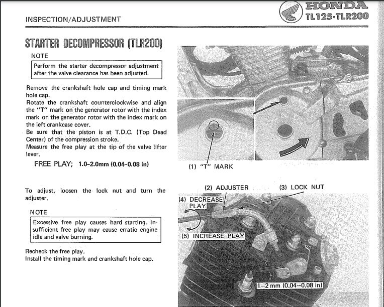

jwalsh Posted January 26, 2022 Report Share Posted January 26, 2022 Does anyone have a procedure for adjusting the compression release cable? I understand the engine must be rotated a certain position and then the cable adjusted for a certain measurement somewhere. Any clarification would be great. Once it is properly adjusted, perhaps some advice on the best way to kick it over. Quote Link to comment Share on other sites More sharing options...
keychange Posted January 26, 2022 Report Share Posted January 26, 2022 There is a clearance but I can't look up at the moment. Tighten the adjuster just tight then back off half a turn. Watch the comp lever as you activate the kick start to make sure it moves. If you have it too tight you will hear a phhhttt exhaust leak sound. If too loose the engine is quite hard to push past TDC (surprisingly so for a small engine). So if it is still hard to kick over, tighten adjuster 1/4 turn and try again...ad lib, fade and repeat. 1 Quote Link to comment Share on other sites More sharing options...
stevec Posted January 26, 2022 Report Share Posted January 26, 2022 This should help. 1 Quote Link to comment Share on other sites More sharing options...
jwalsh Posted January 27, 2022 Author Report Share Posted January 27, 2022 Thank you! I see two procedures offered and between them I think I get it now. 1 Quote Link to comment Share on other sites More sharing options...

Ldub Posted September 29, 2025 Report Share Posted September 29, 2025 I was wondering about this adjustment. I have one with a broken cable I recently fixed. I adjusted it for Freeplay at idle. If you push on the lever you can feel it against the rotating cam. With this proper adjustment number from the book, I am in spec. Good forum. 2 Quote Link to comment Share on other sites More sharing options...
