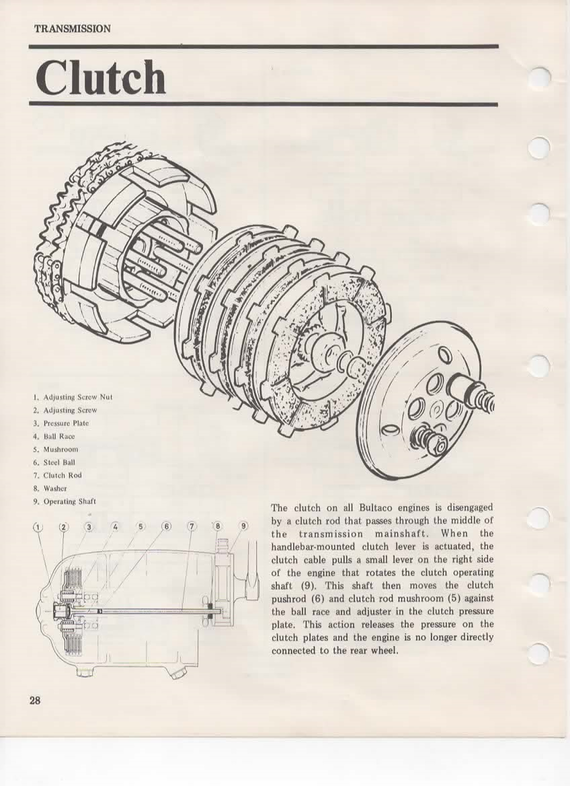

I do have parts books and service manuals for the many models of Bultaco.  Suppose I could always scan a picture or two... or more, if needed.
-Doug

Doug, maybe a diagram of the clutch and mechanism would help especially with part numbers. My engine number is JM-199**** thanks for offering.  Mel.

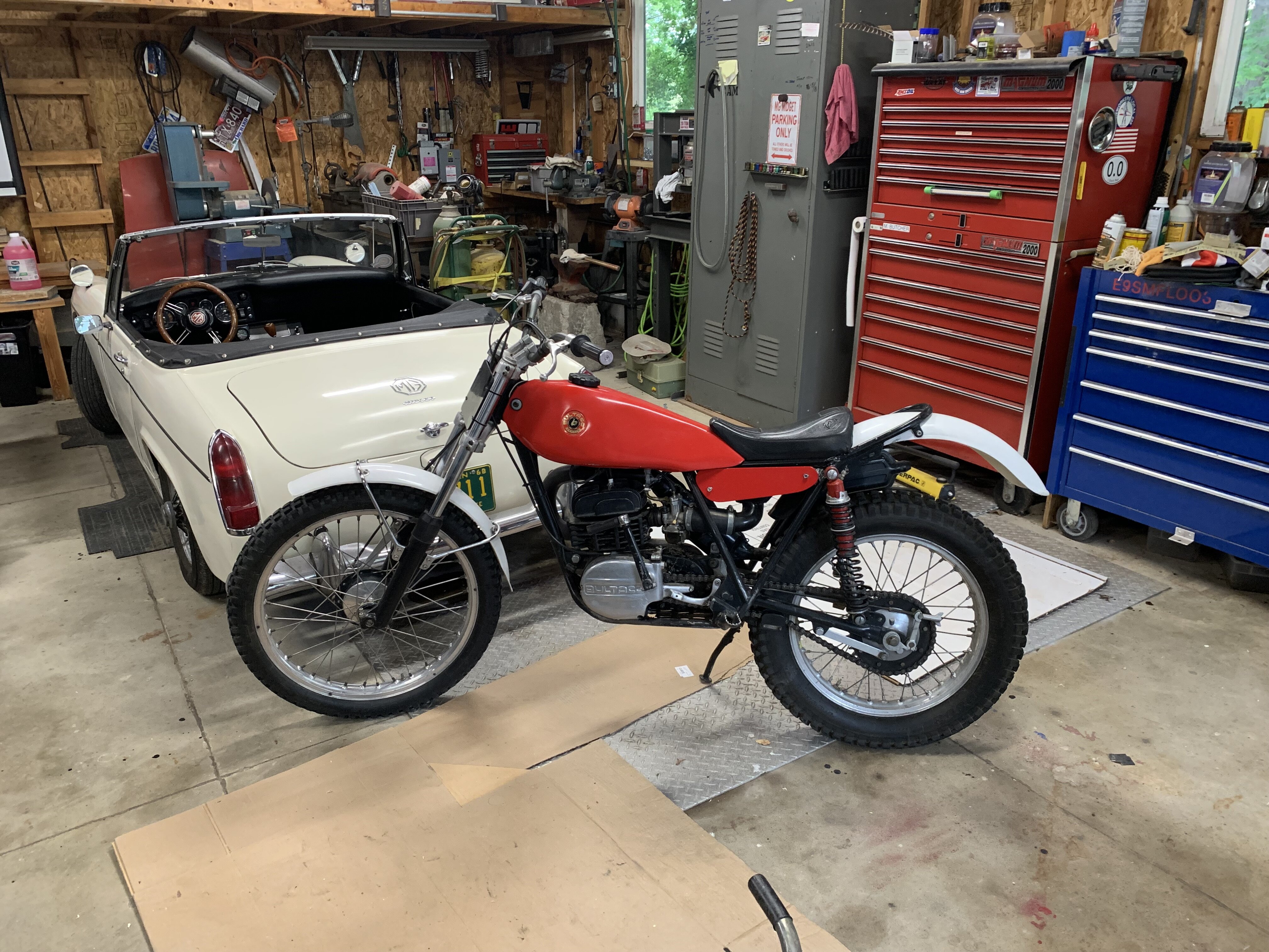

this is her.
Melbutcher:
The latest parts book I have for the Sherpa T 350 is model 191.  I was hoping it showed more info (number of clutch pates), but I can post it if you're interested. I also have the model 203, but the Metralla could be slightly different in the clutch area.  Nice looking bike & MG.
-Doug
