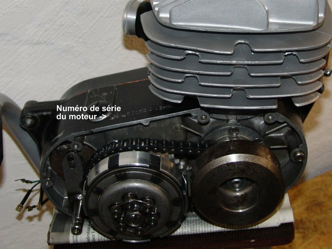

How the adjusted clutch look of my 199b and too in full working order:

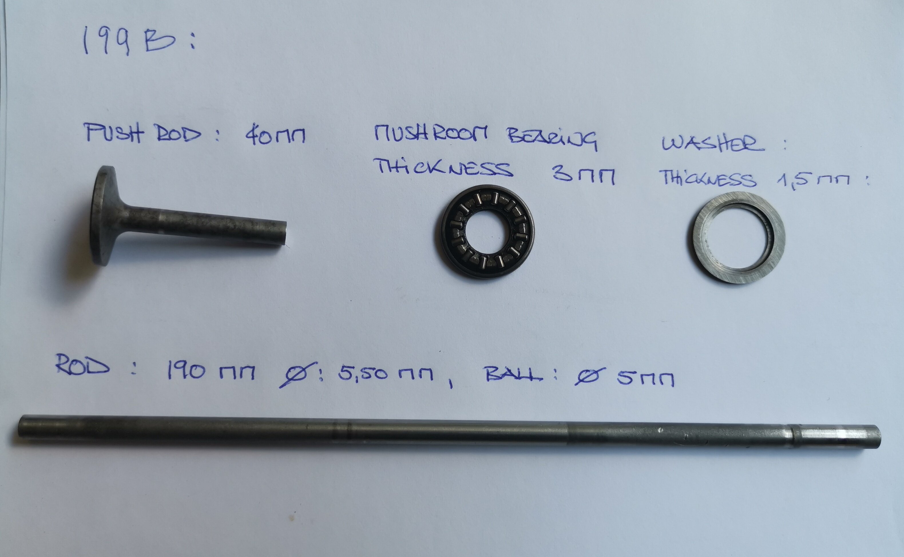

So I made the measurements
The rod is exactly 190mm in length and exactly 5.5mm in diameter.
The pushrod is 40mm in length,
The mushroom bearing is 3mm in thickness and the edged washer 1.5mm.
The balls are 5,0 to 5,5mm in diameter, there are two one between the pushrod and the rod and a second mounted to the clutch lever in the sidecases.
See in the photo.IMG_20220723_154713_edit_472348266815943.thumb.jpg.f7f5105cabab7df5439dee71aeffea41.jpg

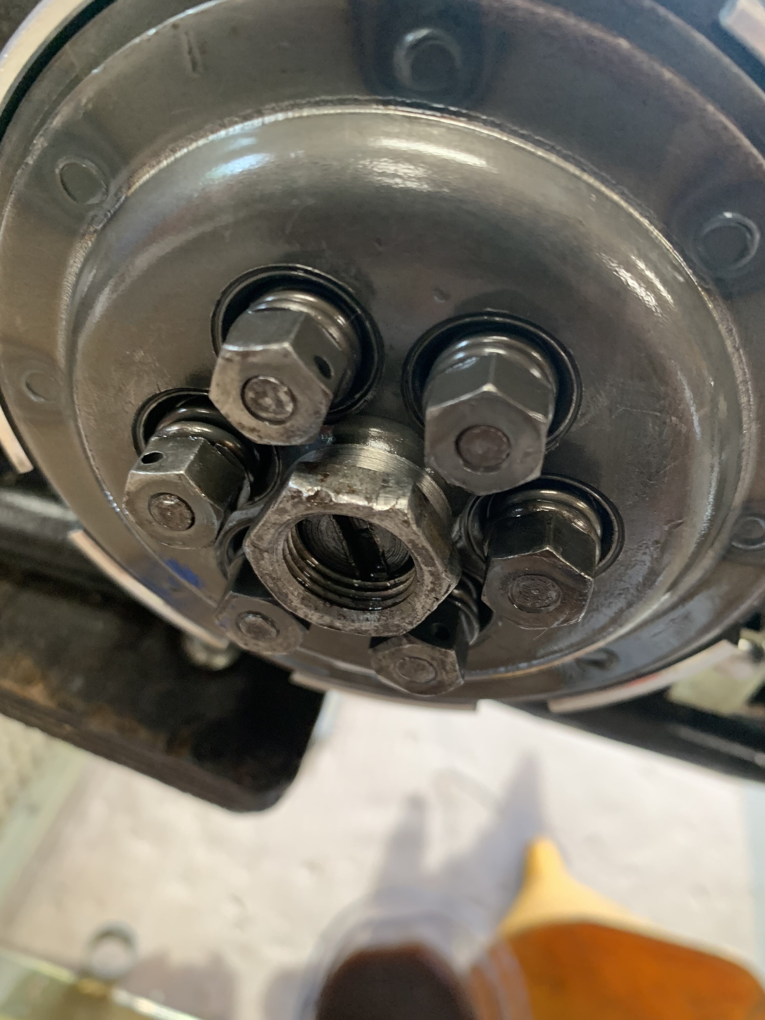

Right now it seems like I have the same issue, I was wondering if you resolved it.
On that photo it looks like there is a ball bearing missing or there is one to many clutch plates in there.
Thanks for the advice, I’ll open it up further and let you know what I find, how many plates should it have?     I counted 6 and 6.
Just going from memory I think there are 6 drive plates and 5 driven plates. Try that and see how that works.
