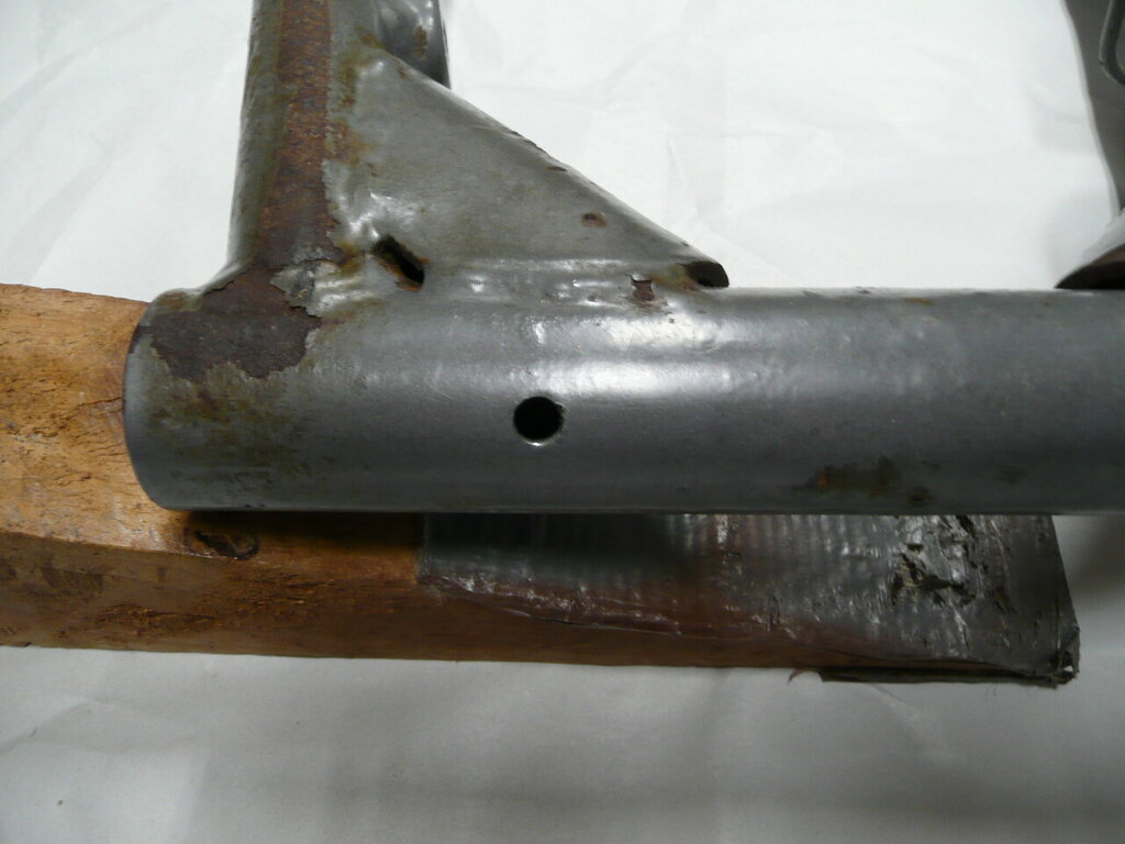

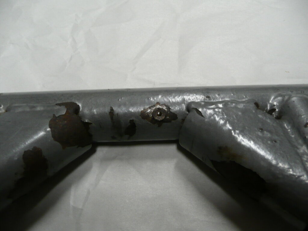

September 16, 20224 yr On the drive side of the arm is a threaded hole for a grease nipple, it aligns with a hole/slot in the spindle if the spindle is in the corresponding position. Is there a grease nipple fitted that has somehow locked the spindle - or a bolt that has been used to stop the spindle from spinning when undoing the spindle bolts, either of which might stop it being removed. I've never know plastic bushed to grip a spindle to the point it won't drift out. Are they definitely plaastic
September 24, 20224 yr Author Thanks for the comments guys. I have now managed to remove the spindle by cutting off the flange on the bushes and carefully drilling down between the swinging arm and the spindle in multiple places to relieve the grip the bushes had on the spindle, I was then able to recover the o-rings and drift the spindle out. I cannot believe how tightly the plastic/nylon? bushes had gripped the spindle, it would not move. Whether it was due to some chemical reaction between the bushes and the grease that had caused them to swell I am not sure, they spindle has probably not rotated/moved in excess of 25 years! The hole on the top of the swinging arm is a plain hole and originally there was some dense foam type material that plugged it, on the underneath there is an oil/grease nipple with a spring loaded ball bearing in the center. I think I will tap the top hole and fit a grease nipple where it will be more accessible.
