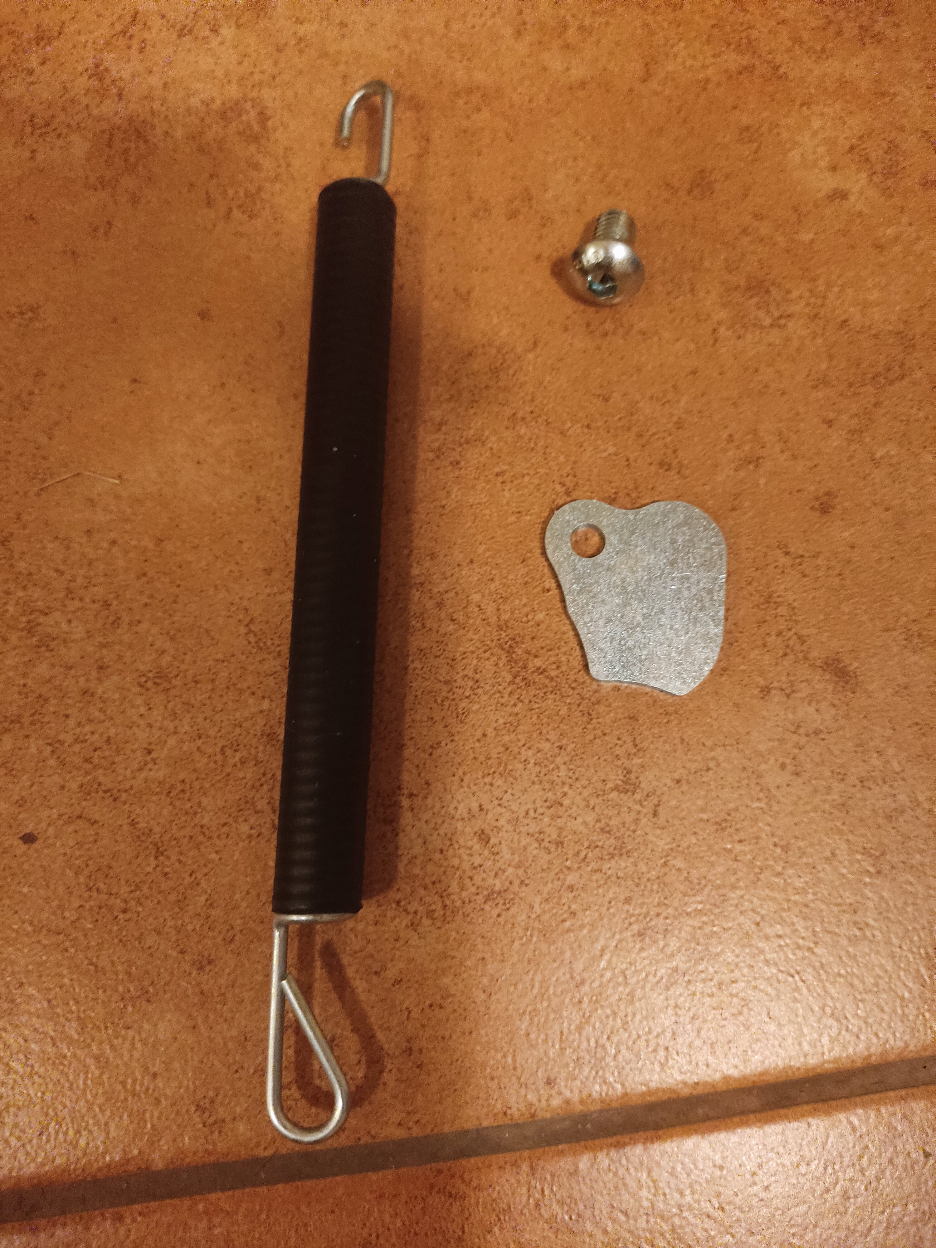

9 hours ago, robson said:
Thanks, looks like in the drawing but cannot identify that smal steel plate with one hole, it was in the package along with spring and the bolt
pic below, what is it for?

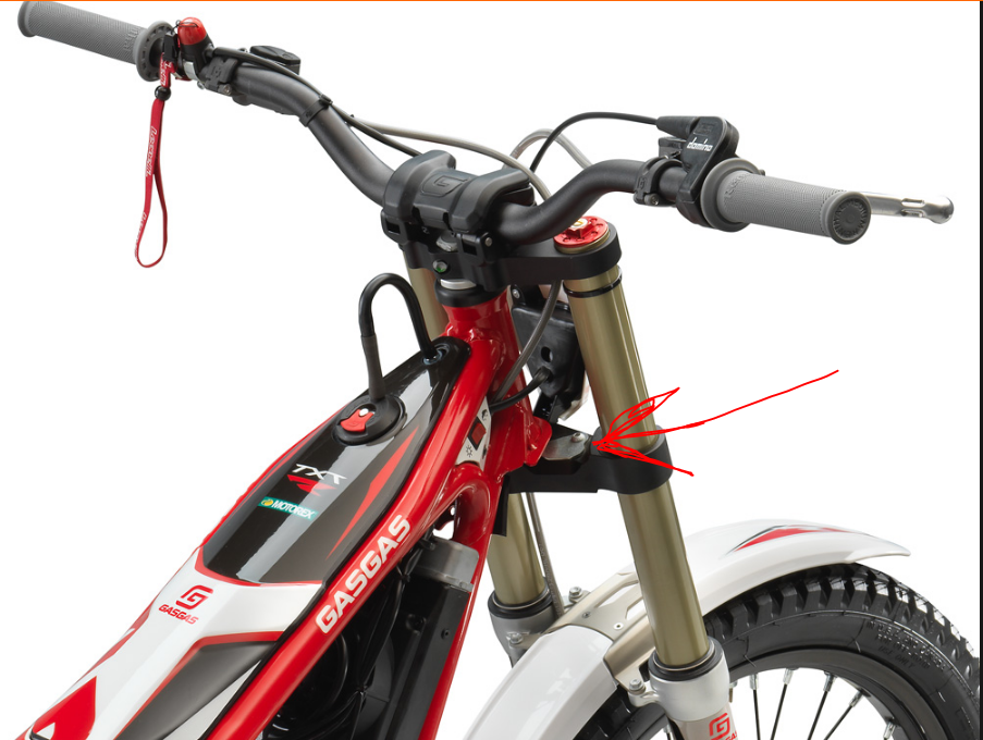

Take a look at the bottom triple clamp. there may be a locking mechanism for locking the forks in place.  A type of theft deterrent. I think that plate replaces the locking mechanism.
no, this plate came along in one bag with spring and bolt for side stand.
Just take a second look at the lower triple clamp, throttle side.  The 3 parts may have been packaged together for convenience, not necessarily for install location.
I have one on my 2015, my previous 2003 had the hole in the clamp and a hole for the bolt but the plate was not installed.

Better photo - zoomed in
you maybe right, right now there is a lock with a key...
will check
Yes, you are right, that's the cover plate for key lock in triple clamp :) thanks
Side stand is working now properly, need to replace also on ebolt provider cause longer spring was rubbing on.

I do have a 2015 GasGas 300 Race, the photo I pulled off the interwebs is of a 2022.
But they should be very very similar.  I purchased mine used, so it was all set up for competition, none of those extra blinkers etc.
