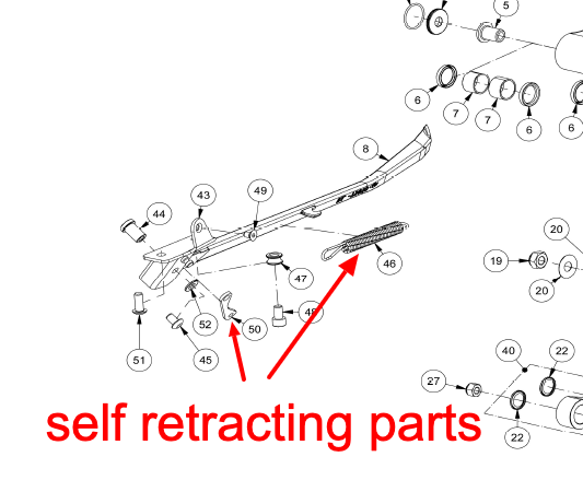

my 300 txt cannot stand by itself,   I see in the package additional spring and some bracket but not sure if it's for that.
oh so maybe that's why there is a second spring in the package :)  probably not as strong...
Most side stands have 2 mount points for the spring at the bracket that mounts to the swingarm.
One point self retracts with the spring and the other one allows the spring to go past centre and hold the stand in position.

I had that issue with a 2016 Beta 4t.  On that bike the spring would hit the end of a bolt when the stand was at full extension to make it self retract.  A shorter bolt eliminated the self retract feature.  I bought the bike used so am not sure if the long bolt was OEM or not.

the  kit with the new spring and bracket should come with a different bolt as well . remove the little bolt and replace it with the one in the kit different shape to it. side stand then works as normal.

Yes it is possible to change. The self retracting side stand uses a shorter spring and a small what I could only describe as an "elongated kidney" shaped piece of flat metal. This changes the pivot point so the stand always want to retract. These two pieces need to be replaced with the earlier spring part number: BT14250GG-CAT-1
It is a longer spring. I am pretty sure one of the cup head bolts that holds the side stand bracket needs to be changed for a button head so it sits flusher as well. This allows  the longer spring to rotate across the top of it and then the side stand will stay in the down position when put there. it then must be manually retracted.
The folding stand is original on the Euro homologated versions of the bike, and the non returning stand was original on USA spec bikes (sold in USA, Australia, Japan etc etc).
Thanks, looks like in the drawing but cannot identify that smal steel plate with one hole, it was in the package along with spring and the bolt
pic below, what is it for?
