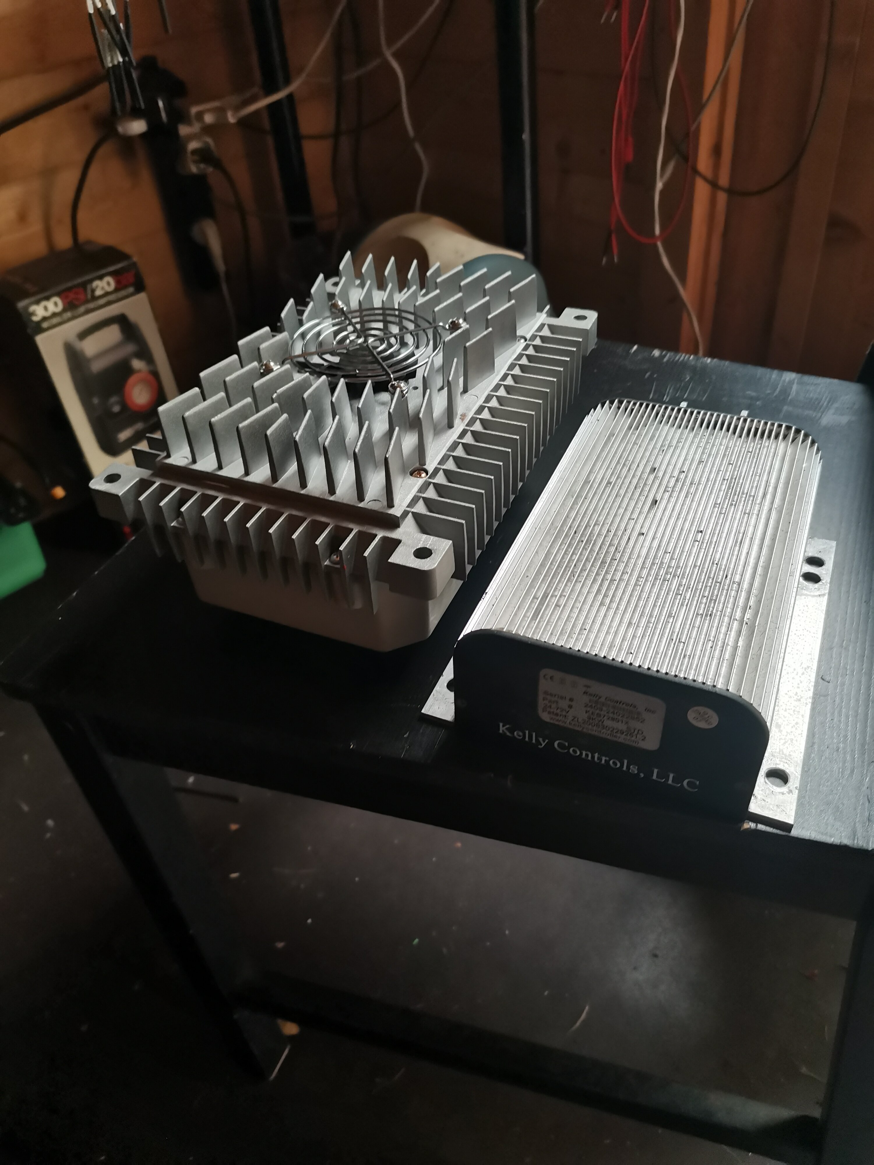

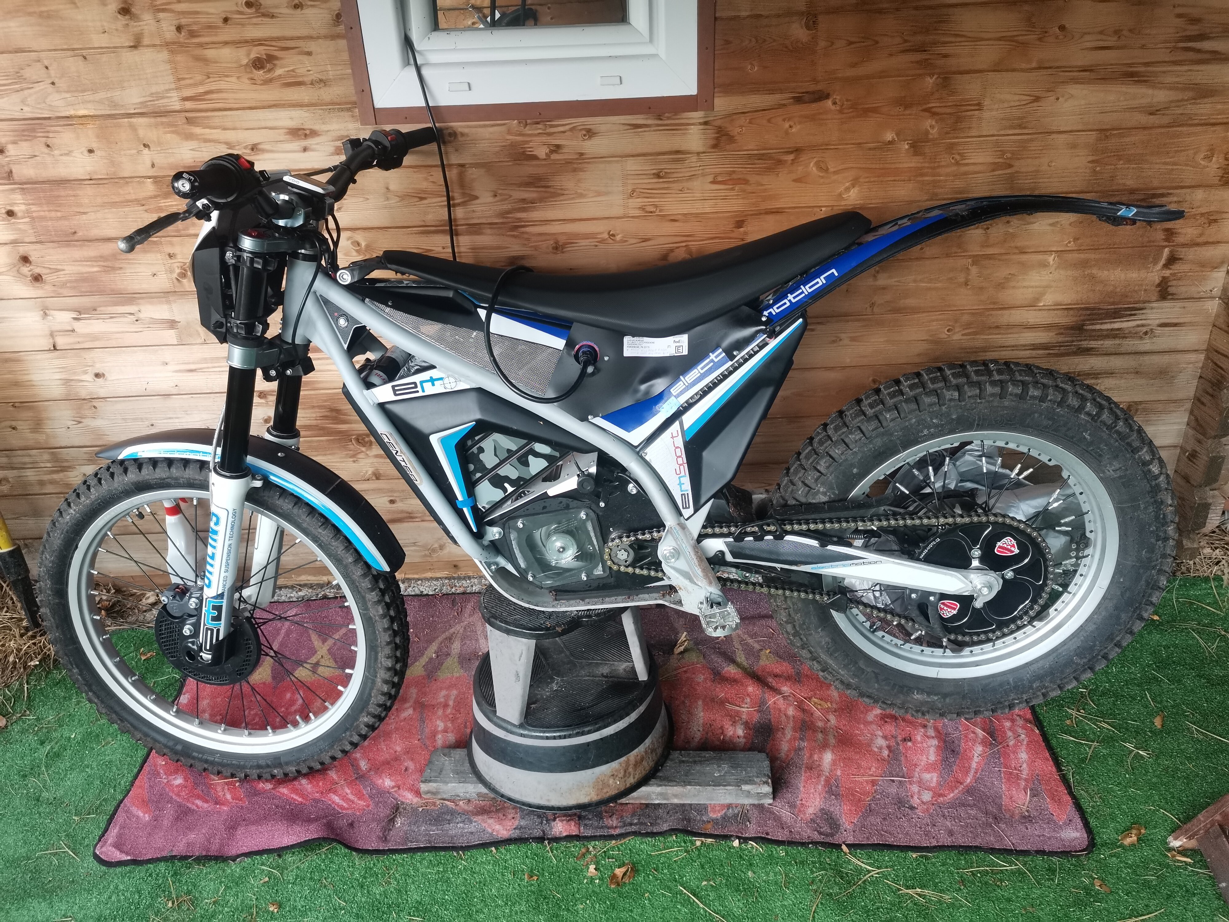

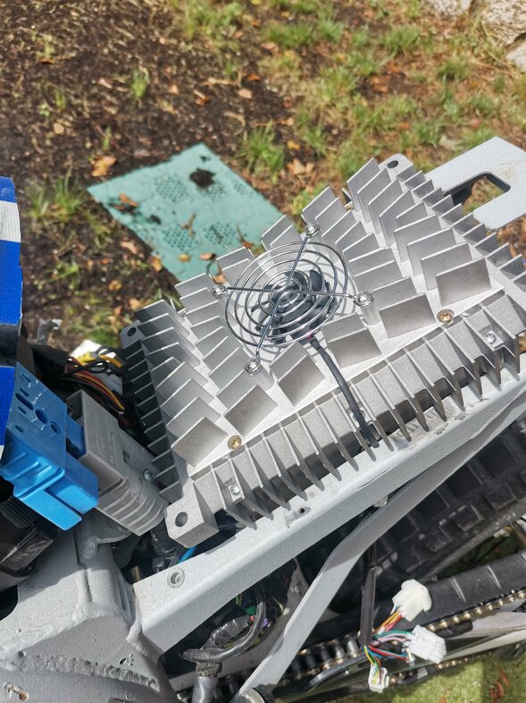

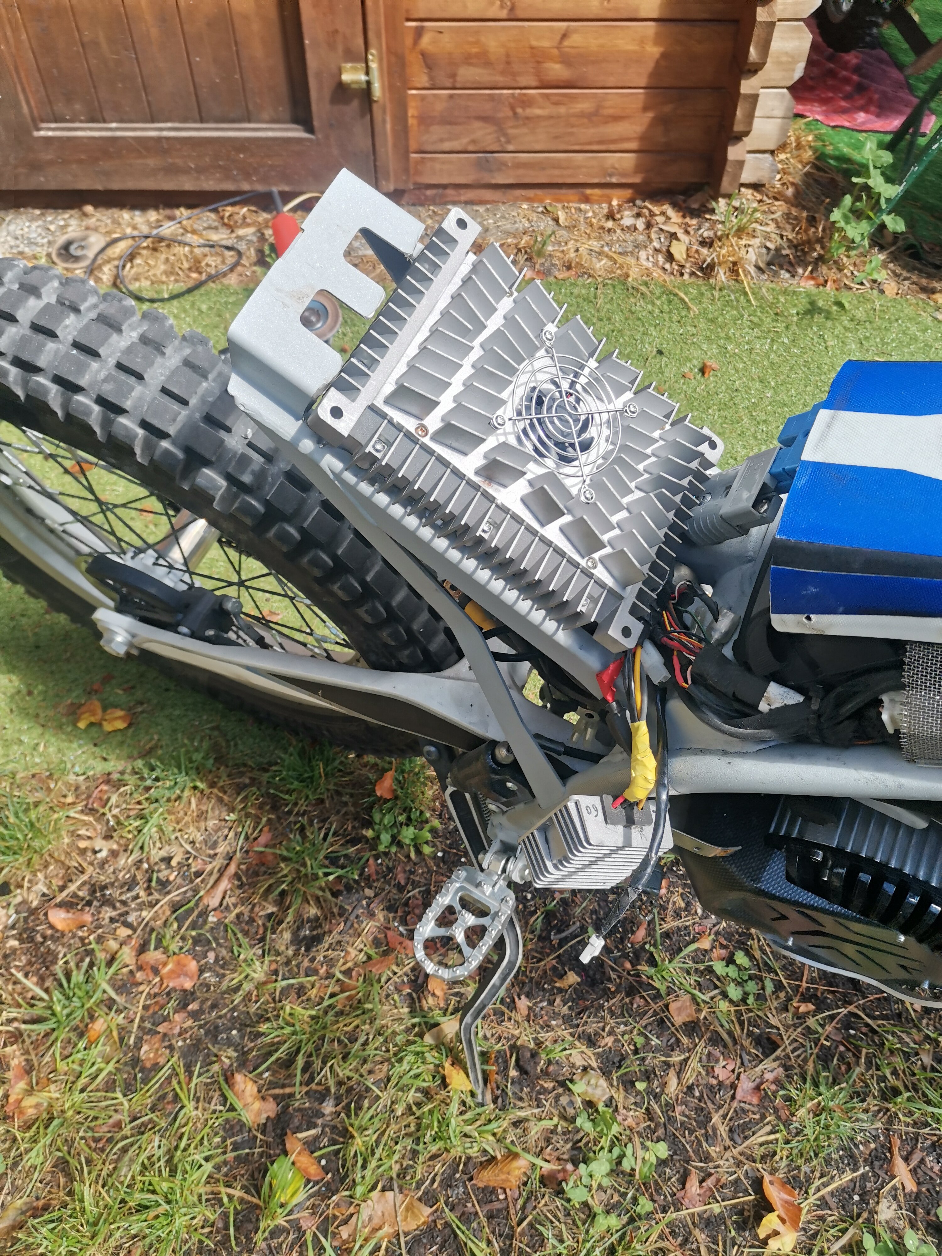

gas2222 Posted September 1 Report Share Posted September 1 (edited) On 2/15/2023 at 7:28 PM, konrad said: For those interested, I have built a website devoted to Electric Motion trials bikes. I intend it as a give-back for all the things I've learned via the internet over the years. There is no advertising or commercial content. https://www.electricmotiontech.com/home Edit: Forgot to mention there's a very effective search tool built into the website - just use the magnifying glass at the upper right-hand corner. Ciao on 9/1/2025 I installed a Kelly KLS7260RM on Electric Motion 5.7 ..... Edited September 2 by gas2222 add photo Quote Link to comment Share on other sites More sharing options...
konrad Posted September 3 Author Report Share Posted September 3 On 9/1/2025 at 3:36 PM, gas2222 said: Ciao on 9/1/2025 I installed a Kelly KLS7260RM on Electric Motion 5.7 ..... Ciao! I think you should start a new thread describing technical details of your installation. Many of us would find it interesting. I would be curious to know: Had the old controller failed? How often does the controller's fan run? How did the performance improve? How long did the project take? Total cost? What seat is that? Did you upgrade the battery also? I see a clutch lever. How does that work? Quote Link to comment Share on other sites More sharing options...
