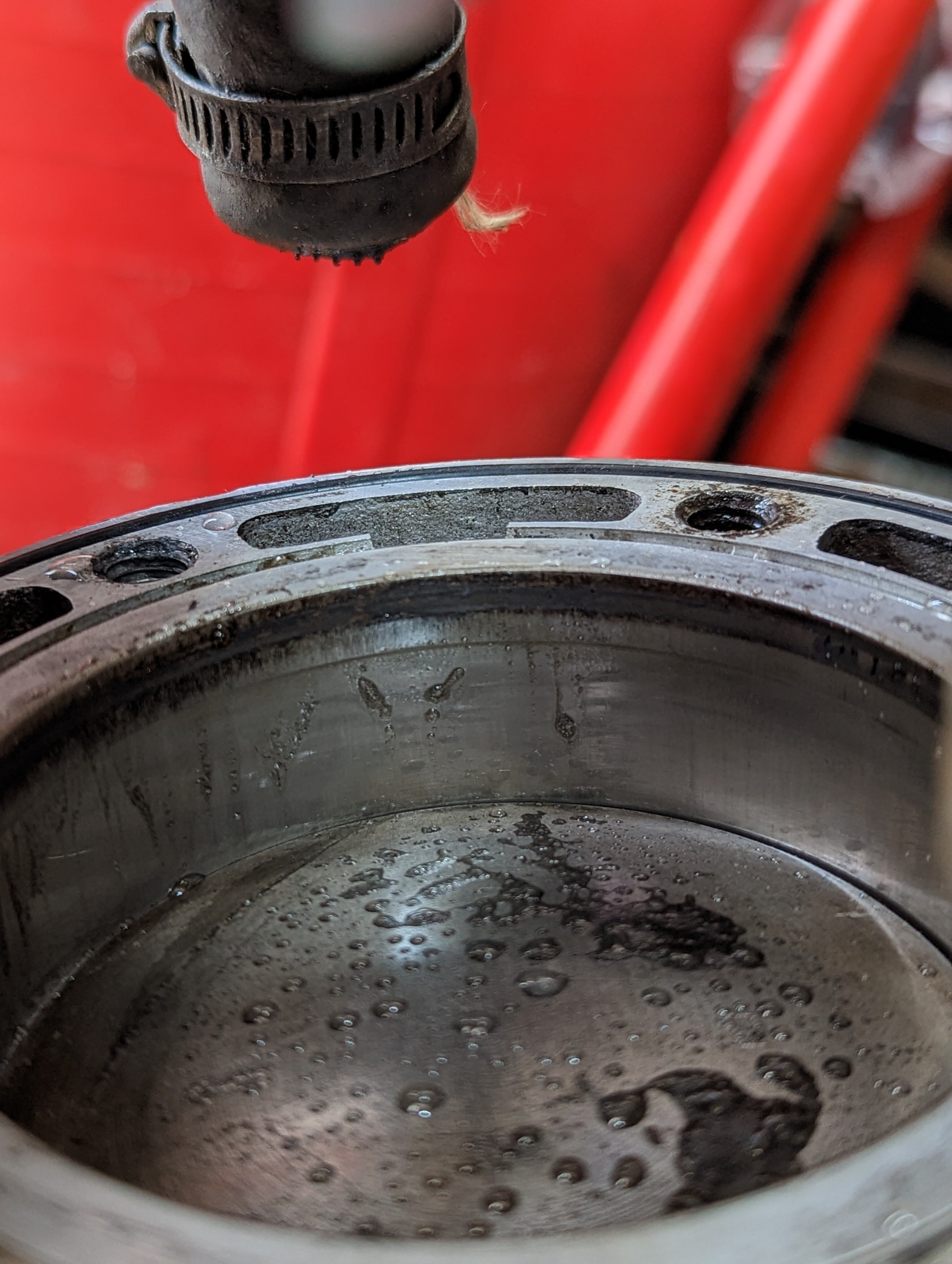

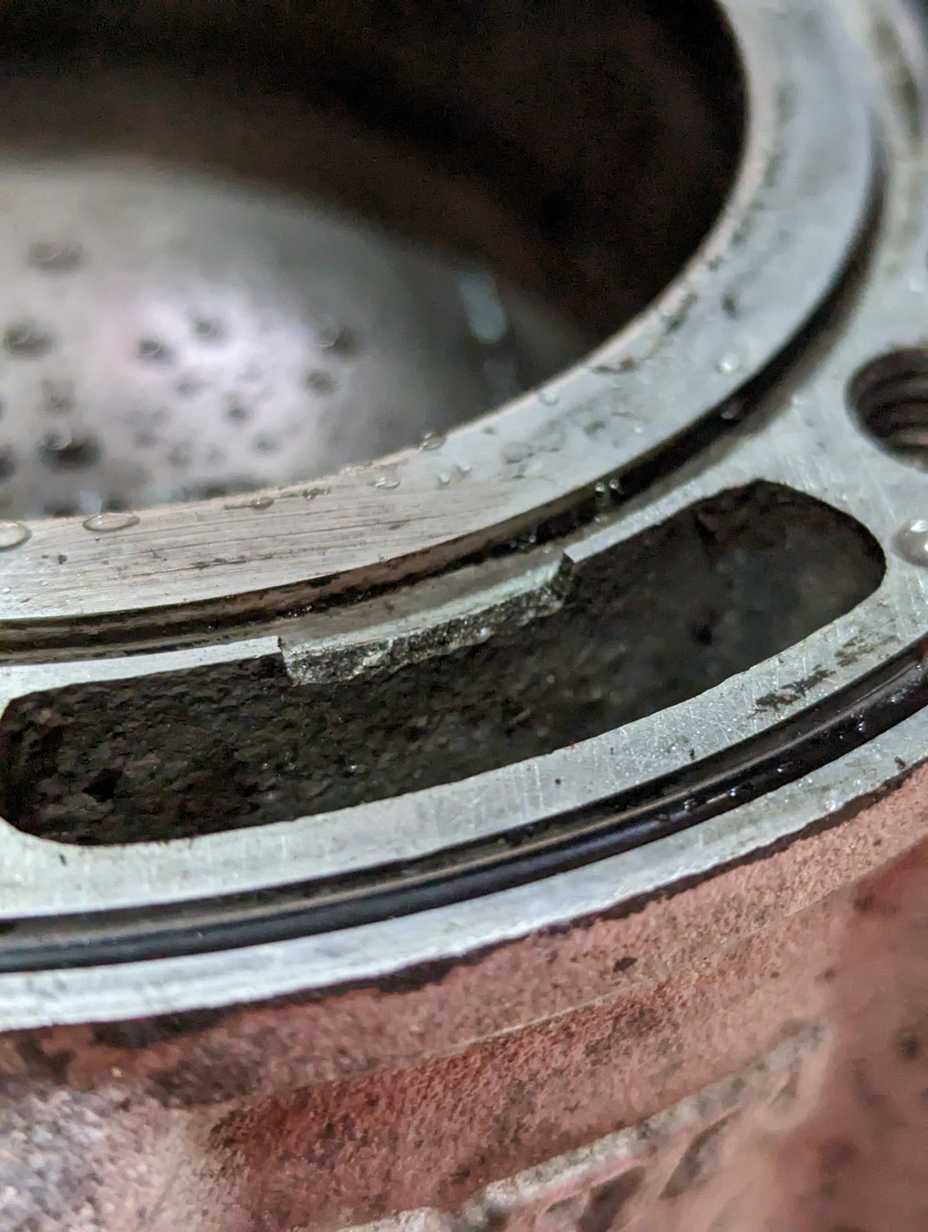

Does anyone have a fairly decent barrel only for sale?
Plenty barrel/pistons for sale, but piston is fine. Just a barrel needed.
See the photos to see the cause of a lot of swearing in the shed 🙈🤣

That's a dashed shame.  But I think it is worth trying to repair that.  Maybe attach a piece with low temperature welding rod on the outside.  Doesn't have to seal, just attach.  Then fill the groove with something square like a piece of rubber and apply JB weld to the gap. Surface on some wetndry.
The outside of the groove is only at water temperature
Edited by F5Dave
I may try that down the line Dave. Meantime I've got another matched barrel and piston coming. If I can fix it, will be worth having as a spare because the barrel is spotless besides this pain in the ass 🤣
