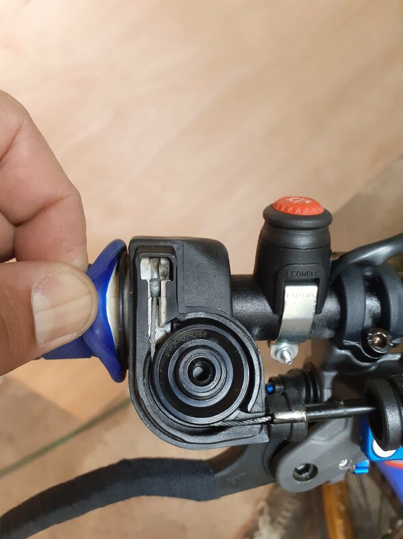

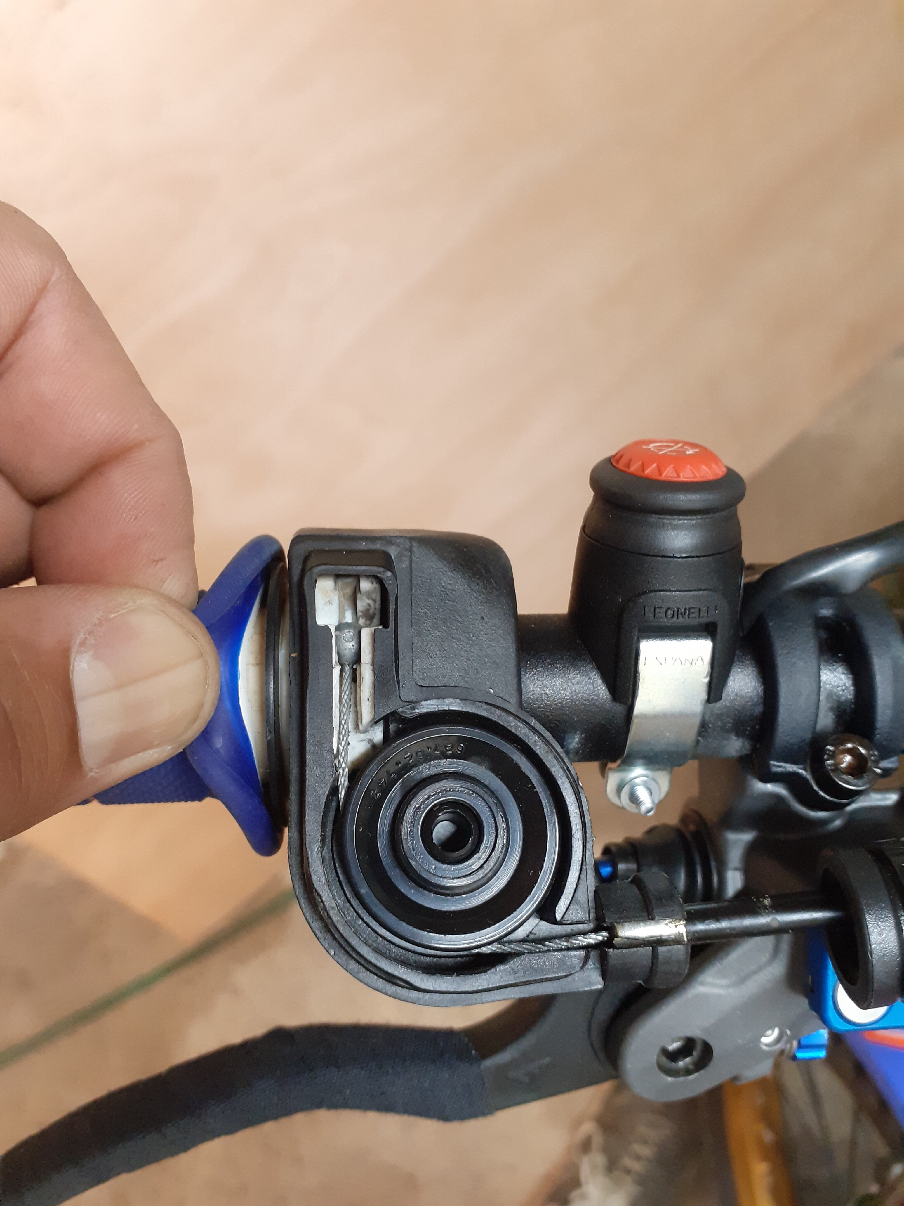

Hi, everyone. I have just bought a 2022 250 factory to replace my 2017 standard 250.  I have found the throttle to be a bit slow when revving up. Is there any easy telĺ to see if the previous owner put a slow action throttle on it? Instead of standard? As grips have been changed at some point too. Given the condition of the bike and only a year old it seems strange to change the grips to me.
If its a domino throttle then a white tube is fast action, black is slow.
Hi lowside, it's a black domino one. Is that standard from beta themselves? May need to look a bit closer as to why it seems to rev up slower. Cheers for the reply
Tell a lie, turns out its a white one. Strange, seems previous owner maybe had problems with power.
White Domino throttle tube is definitely "Fast action" throttle with less movement required than black tube throttle ~120 degrees total turn.

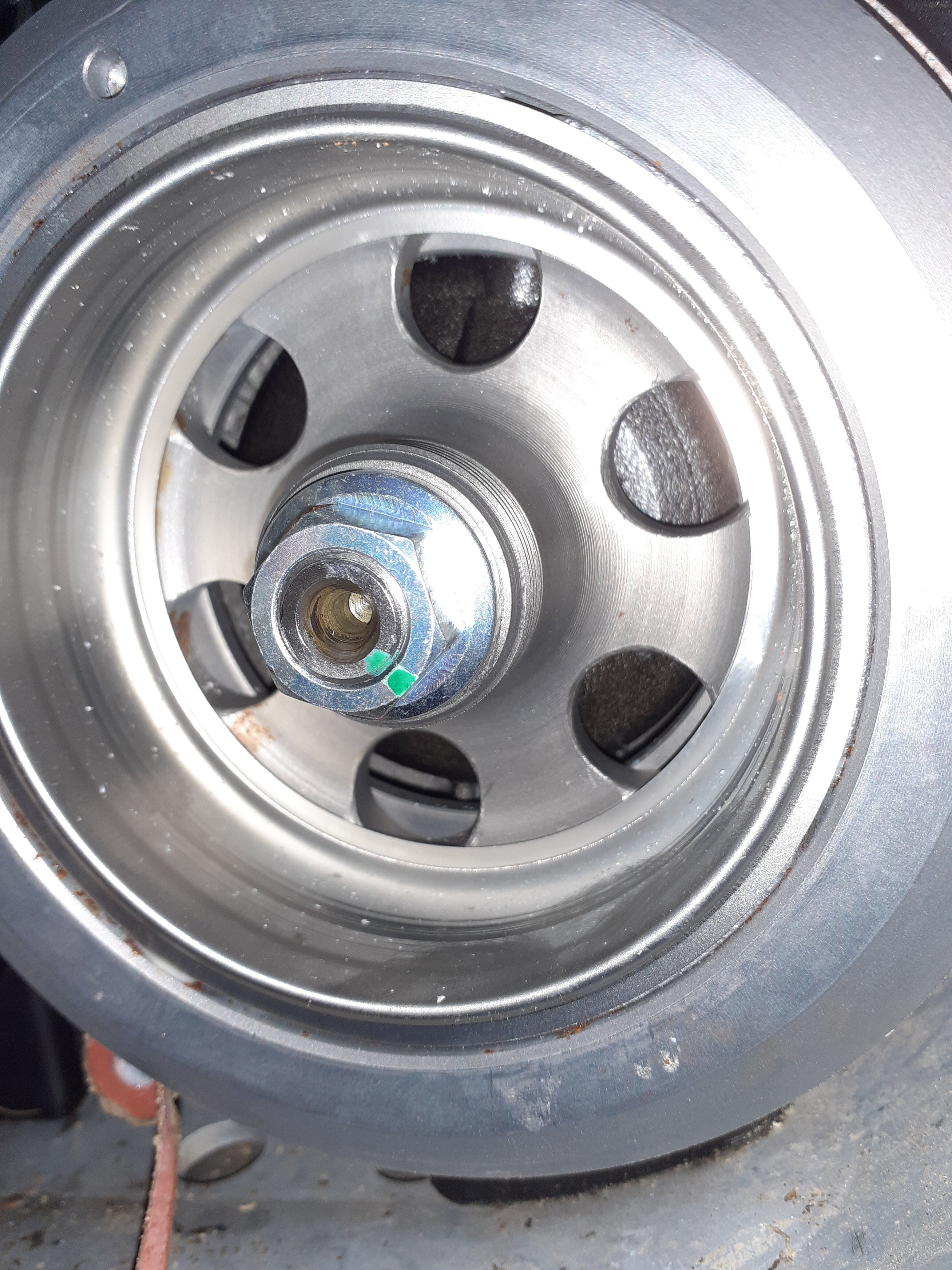

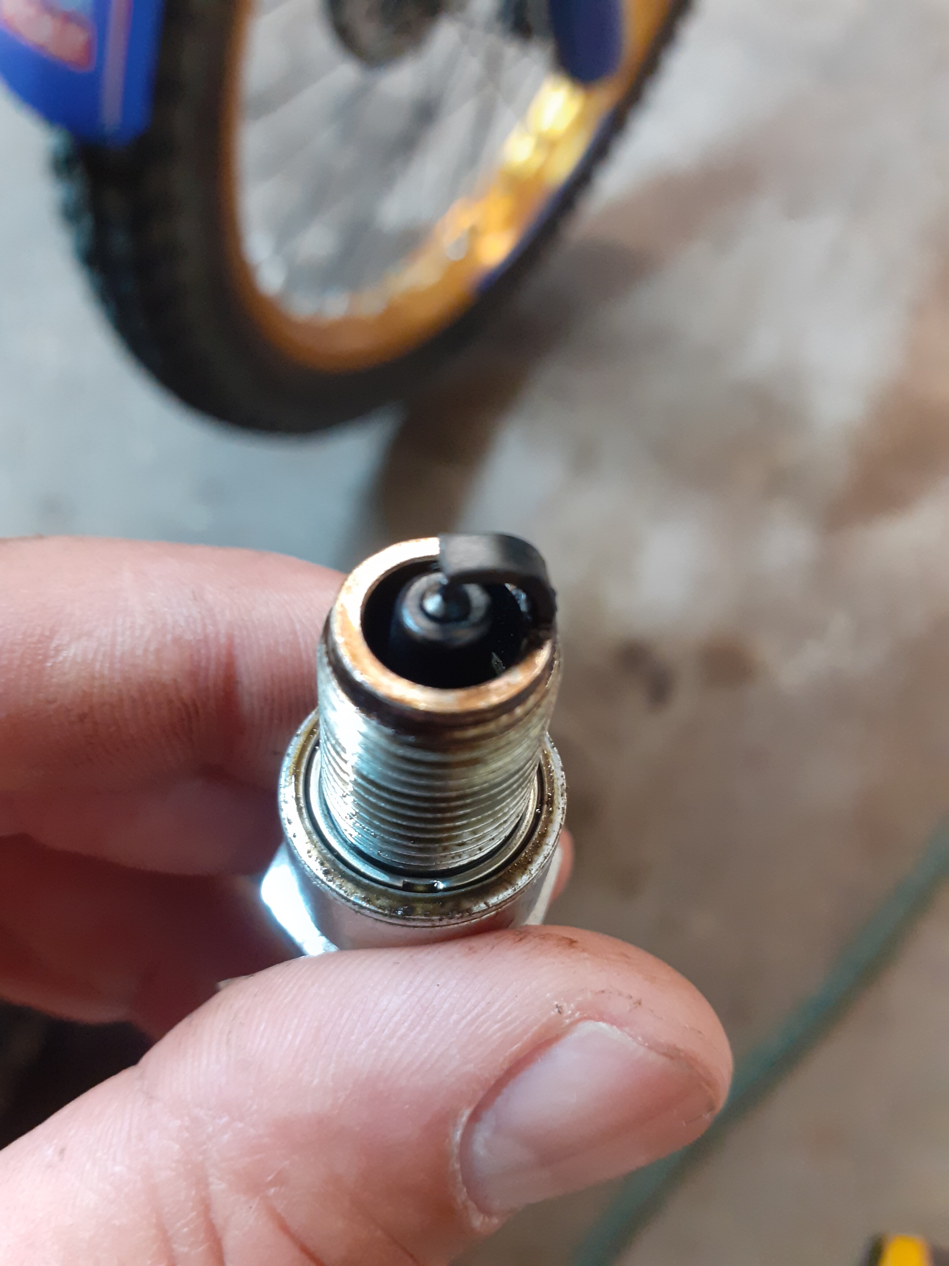

Checked the flywheel. No obvious weights bolted on apart from one on the back i assume is factory standard for the 250 as seems a good fit and can't see and markings. But going to check over the carb and reeds before pulling it off to check. Sparkplug after a ride too.
@splashcroft you actually need to use flywheel puller to see if there is removable weight added that can be removed... The newer generation Evo 250/300 models, since around 2013-15) have "inverted Flywheel/Stator" meaning the stator is attached to the flywheel cover (instead of internally). If flywheel is removed and you can view the backside (hidden in pic), that's where any possible screws would be located. That spark plug indicating a very rich (black) condition. Try raising the needle clip from 4th position down (stock, with 125 MJ) to 3rd clip position from the top (dropping needle into needle jet housing) to lean out low to midrange jetting. Might even be able to run 122 MJ and try increasing 48 Pilot (slow) jet to 50 or 52 to see if you can get maximum idle and crispness, once warmed up with air screw between 1.5 and 2.25 turns out?

Stripped and cleaned carb, all jets standard, air screw was only one turn out so set that 2.5 turns out from closed as per manual to get a base line.
Reeds seem to be carbon fiber ones in good condition.
After riding the bike tonight over the same sections it seems a bit sharper but not too noticable.
I mix 60:1 fuel, not much in the way of spooge and never had a problem before. But maybe i should tweak?
