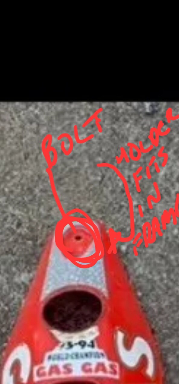

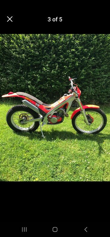

Iv just bought a gasser JTR250 ( 96 ) ..hopeing there ok always wanted a trials since watching kickstart as a kid ..so slowly making it my own as you do , found ( dont know if this is the right section to mention this , sorry admin if not ) , but some guy before me has cut the wires from headlight / back light / lcd clock )..no idea why ..i have took tank cover off to look into & i have cross threaded the cover holding bolt no its stuffed ..as any of you guys any ideas as to where i can get a replacement please ..thanks very much & nice to meet you all
They're decent enough bikes, a little heavy by modern standards but good for learning.  You might have problems finding some spares.
The wires were probably cut so the bike could just have a plate for a competitor number up front, most people in the UK don't run lights on their bikes because you can get a "daylight MOT" (or they're never registered at all, and only used on private land).
As for the thread, if the nut is molded into the cover (don't know, never had one of these myself) the best thing would be to get a helicoil fitted.
