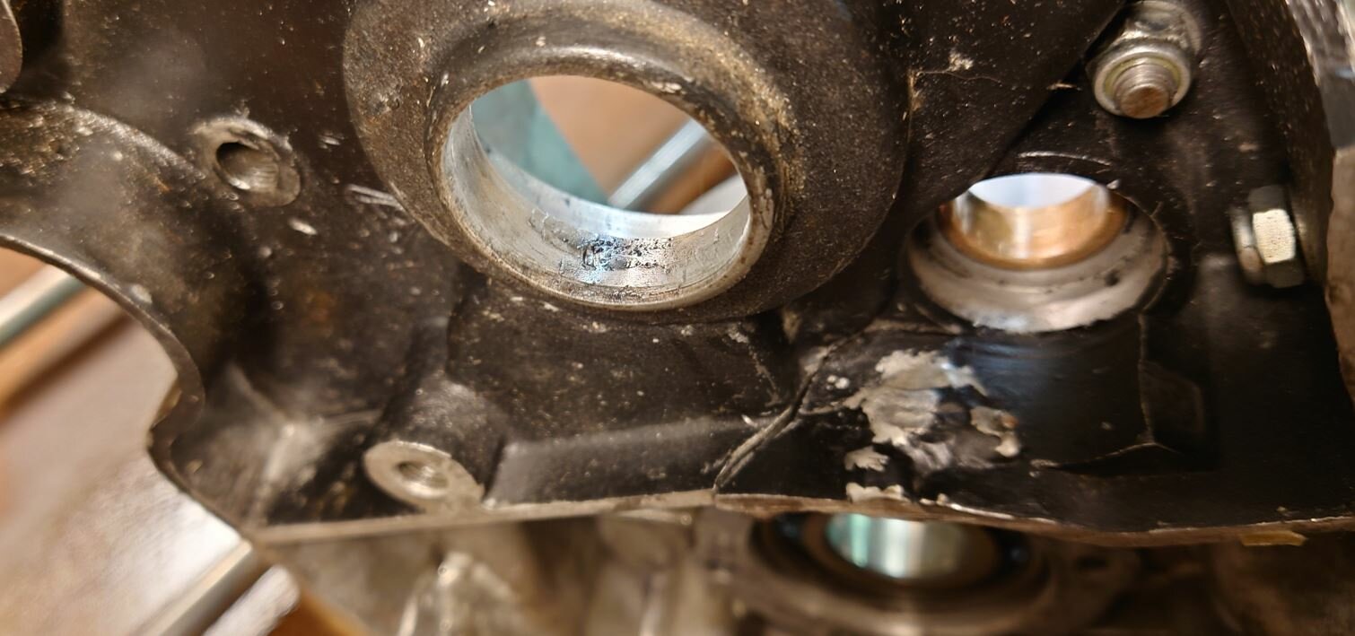

I removed the engine from the bike and removed the outer casings. It looks like the crack has been welded before but the weld has failed.

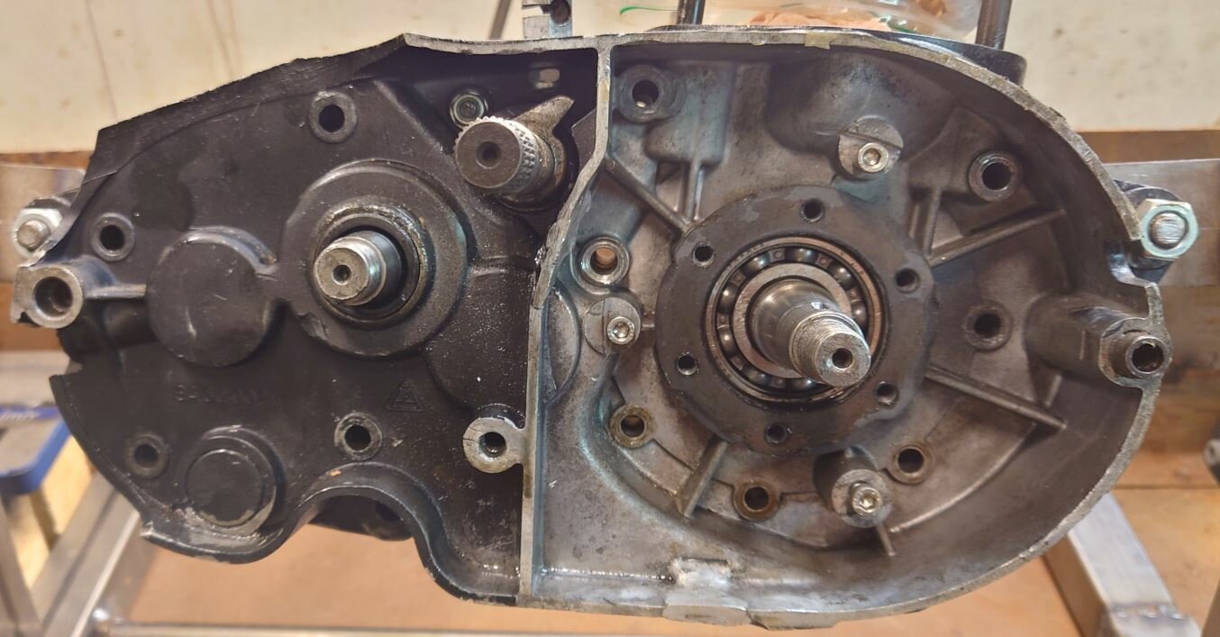

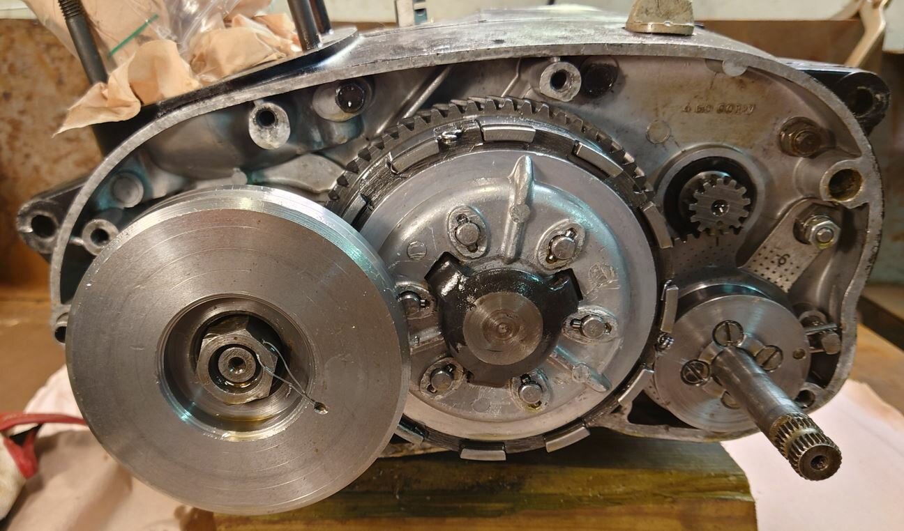

I have started to dismantle the engine in order to split the case, the case does not seem to want to come apart, is there something more that I need to loosen or do I need to hit it harder?

Localised heat to inner bearing race of main bearing , oxy acetalene welding torch  or use of a case splitter tool home made or ready made ?
Thanks for the advice I heated up the case and it came apart.

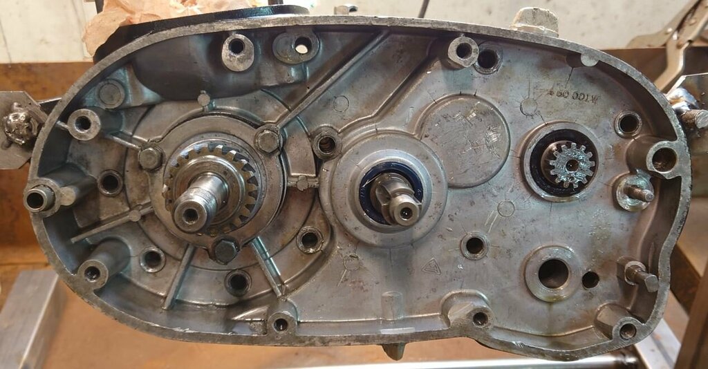

It looks like the crack in the case was not the cause of the oil leak, The oil was coming from the seal on the kick start, also the main bearing was rough so I think I will replace both main bearings and all the seals,
This means I will have to remove the gearbox, I am unsure how to do this, is there some way to remove the whole assembly in one piece so it can be replaced as a unit when its time to put the case halves together?

Make drawings and take photographs /video when you strip the gearbox to remove it and place  it in its  order using rubber bands to keep everything held together in their specific order on the different shafts to help you when you put it back btogether again.
 Great  , ,,,,,did not fall apart ,, LOOK at gears , top front looks worn ,, ,  cheers
I think the gears are ok its just a bad lighting on the picture

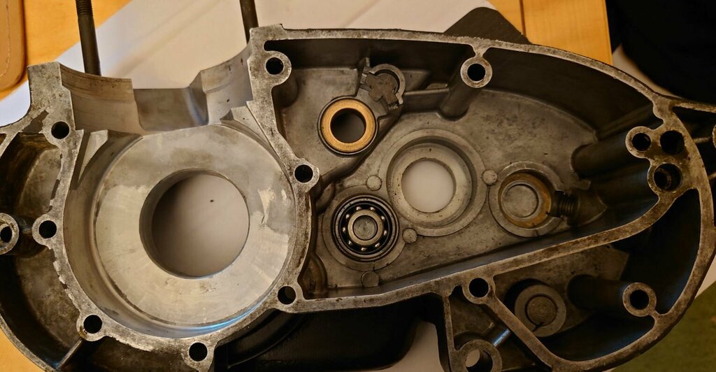

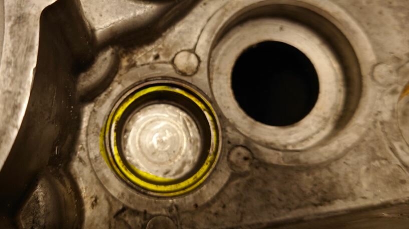

 I have removed all rhe bearings except for 1 which is in the case and its blind bearing, the bearing race is stuck in the case see picture. Can anyone tell me how to remove the race from the case?

Hello again @DavidSweden you will need a blind hole bearing puller or home made expanding type tool to grip the inner surface of the bush bearing then apply heat to casing  around the part to help extract it

I cannot get the bearing racer out of the case even with a puller, the race is conical so the puller just wont grip, if anyone has some advice I wil be glad to hear it.
