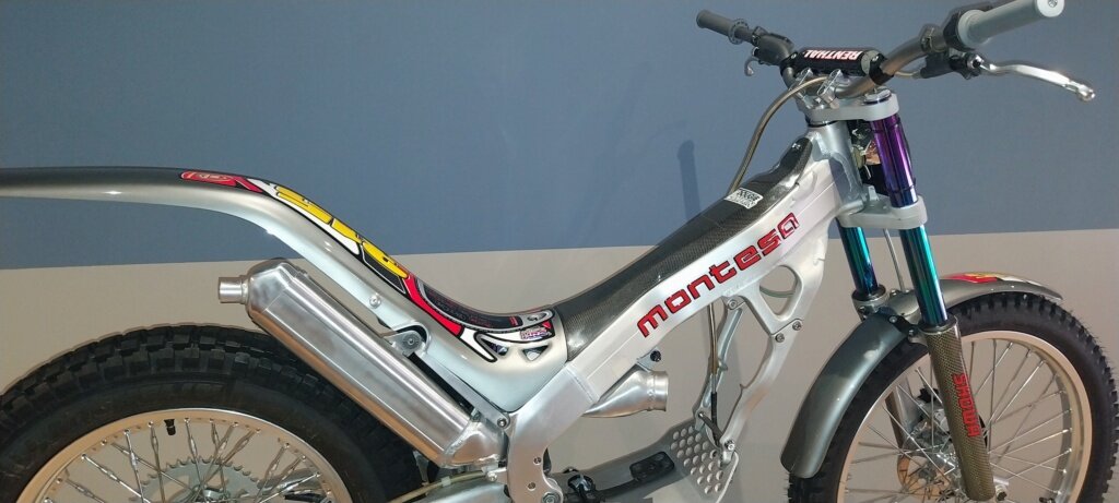

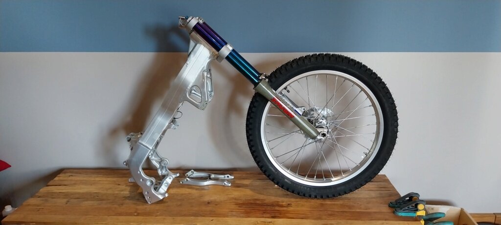

ahell Posted March 14, 2024 Report Share Posted March 14, 2024 (edited) Hi, Hope you will enjoy this project bike. Historical review. (google translate ...) Dougie had been riding for Beta for ages. He won the 97. 98. 99 world outdoor titles on the Techno. For the year 2000, Montesa - Honda offers the services of the English champion. In the commercial career of the 315R, the year 2000 saw the arrival in series of the Showa fork and the DID rims mounted on machined and polished hubs in their center. Doug's factory bike will foreshadow the 2001 production model in the following ways: -A longer exhaust tip. -A swingarm assembly modified to accommodate a caliper hidden behind it. (the rear hubs are narrower) -A shock absorber with a longer center distance and a slightly shorter stroke. -A slightly higher upper shock absorber mounting The base motorcycle for this replica is a 2002 model. It therefore presents some of the elements common to the factory motorcycle. I collected the photos and watched the videos from the era to identify the specifics of the factory bike. Carbon headlight plate Carbon fork bridge Lightened wheel axles Carbon Kevlar fork slider protection Flat carbon tank Renthal handles and handlebars. Titanium screws Factory rear wheel Factory rear brake disc Sponsor stickers, decoration (which evolves during the season to take on the colors of the 2001 bike at the end of the 2000 season) Stainless steel factory exhaust manifold (not available) Longer central exhaust (not available) Longer silencer (not available) with straight perforated tube Different brake lines Footrest plates treated without paint Carbon kevlar air box (not available) Golden Iris chain Carbon air box cover with circular opening (from Mitani) I have already made good progress on this bike. I found a real factory rear wheel (from Josep Banyeres) The rim has a special profile. The side has a concave edge (straight on the series) and has no marking. The nuts are ergal against steel on the series. The lighter factory disc is very specific I mounted in series, never marketed. Titanium screws and SKF bearings. Factory Gripster (spacer plus blue aluminum nut) I overhauled the fork, the calipers and master cylinder, the links are new. Handles, handlebars, levers, cable, front & rear disc protectors, swingarm pad, tensioner pad, crown protection etc. Among the new parts that have become unobtainable are the 2000 mudguards and the bashplate. The engine will be completely overhauled. Bearings, spy, connecting rod, piston, plating. Preparation: upper & lower engine alignment, deburring/cleaning of the cylinder, lighter ignition rotor, lighter complete Mitani clutch (treated aluminum discs), straight silencer inner tube, iridium spark plug. Not knowing the engine preparation of the factory motorcycle, failing to have the performance. I want a 250cc that breathes well and sounds clean. New parts: -tires -handlebar -handles -levers -tips -throttle handle -bearings -brake pads -Absolutely all the trim and all the plastic parts. - engine plate -link and rockers - very light special tank - carbon trigger guard and headlight plate -official sponsor stickers -wheel axles -ergal column nut -brake pedal - mitani carbon filter cover, twin air filter - titanium bolts everywhere Edited March 15, 2024 by ahell 4 3 Quote Link to comment Share on other sites More sharing options...

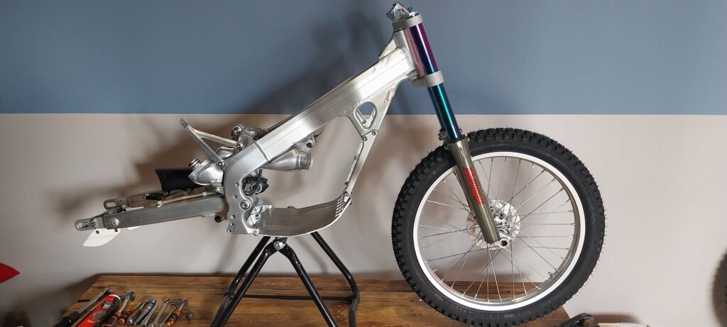

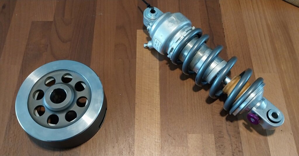

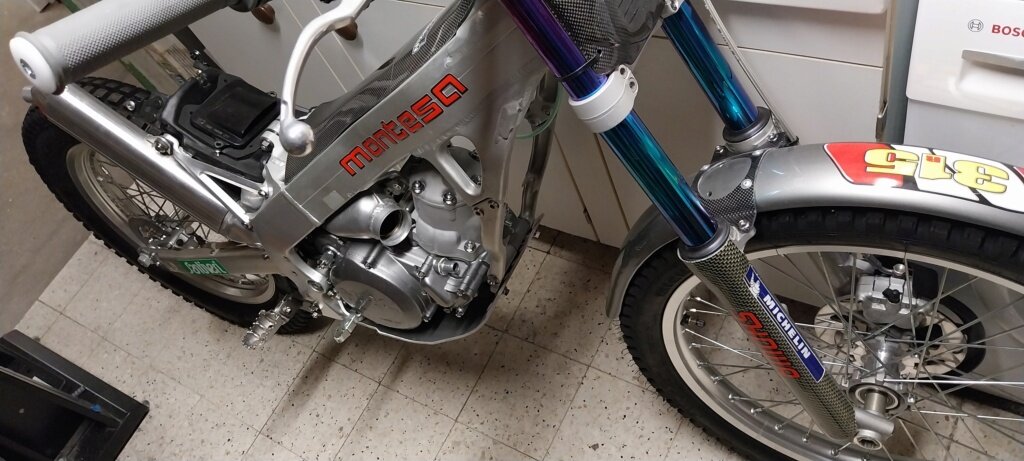

ahell Posted April 5, 2024 Author Report Share Posted April 5, 2024 New shift drum Light weight flywheel and overhaul showa shock with race spec. 1 Quote Link to comment Share on other sites More sharing options...

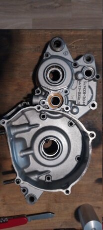

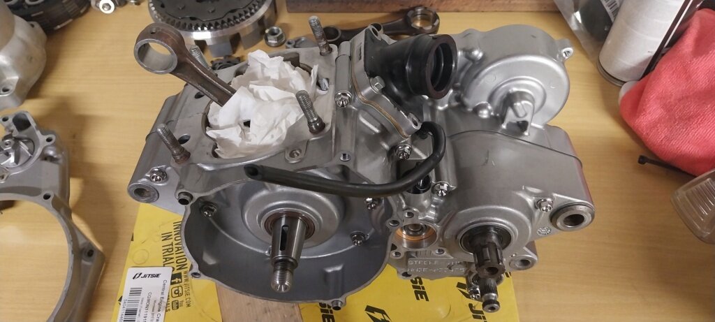

ahell Posted April 8, 2024 Author Report Share Posted April 8, 2024 Cleaning, upper and lower engine alignment, replacement of crankshaft bearings, gearbox output bearing, selection barrel and spy gasket. All new crankshaft and titanium screws. Quote Link to comment Share on other sites More sharing options...

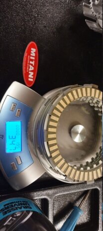

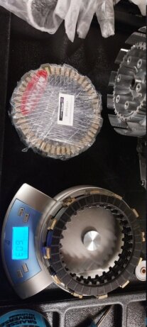

ahell Posted May 2, 2024 Author Report Share Posted May 2, 2024 (edited) Mitani alloy clutch -250grs Edited October 14, 2024 by ahell 1 Quote Link to comment Share on other sites More sharing options...

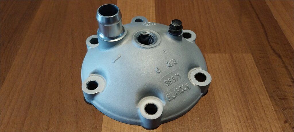

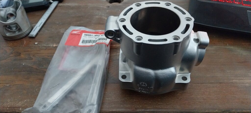

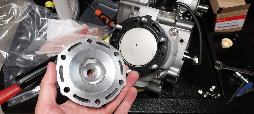

ahell Posted October 14, 2024 Author Report Share Posted October 14, 2024 (edited) Back to work! Brand new parts is a never ending game. Today brand new cylinder size "C" and a silencer frame mount. Order in progress : Original piston C, rings, pin, clips Brand new magnesium engine covers Edited October 16, 2024 by ahell 1 Quote Link to comment Share on other sites More sharing options...

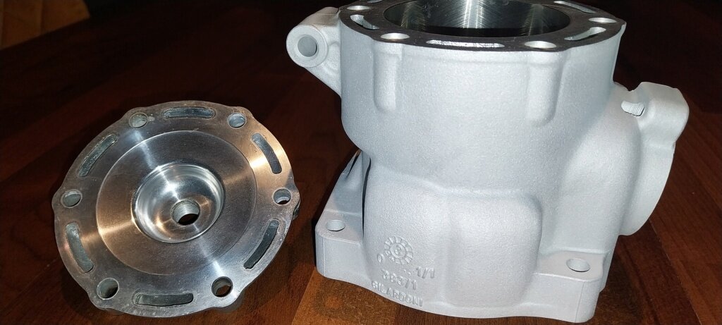

ahell Posted October 15, 2024 Author Report Share Posted October 15, 2024 Very light sand blast on the new cylinder for a factory finish. You can see the difference with the original head finish. Quote Link to comment Share on other sites More sharing options...
ahell Posted October 16, 2024 Author Report Share Posted October 16, 2024 Factory mat finish. Titanium bolts will shine like a disco ball. 1 Quote Link to comment Share on other sites More sharing options...

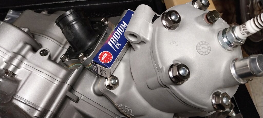

ahell Posted October 27, 2024 Author Report Share Posted October 27, 2024 Brand new cylinder C, genuine piston & rings, Iridium spark, new studs and titanium nuts. Quote Link to comment Share on other sites More sharing options...

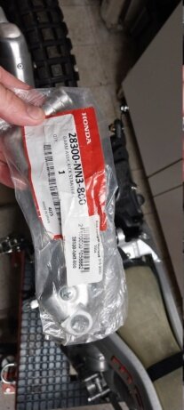

ahell Posted October 27, 2024 Author Report Share Posted October 27, 2024 Ergal bushing for the rear brake and rear shock New parts: Shock top rubber and a very rare complet kick starter. Quote Link to comment Share on other sites More sharing options...

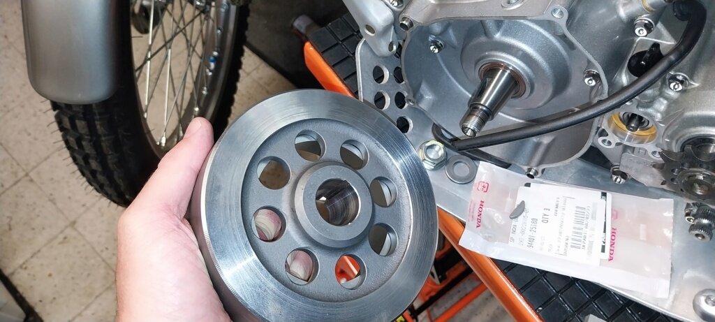

ahell Posted October 28, 2024 Author Report Share Posted October 28, 2024 Lighter flywheel with a new "clavette" (french word) 2 Quote Link to comment Share on other sites More sharing options...

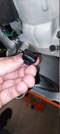

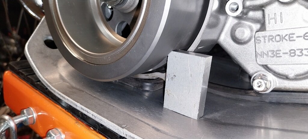

ahell Posted October 29, 2024 Author Report Share Posted October 29, 2024 (edited) Radiator fresh paint, electrical parts clean and exhaust My tip to tighten the flywheel with a piece of alloy. New oil filler cap Edited October 29, 2024 by ahell 1 Quote Link to comment Share on other sites More sharing options...

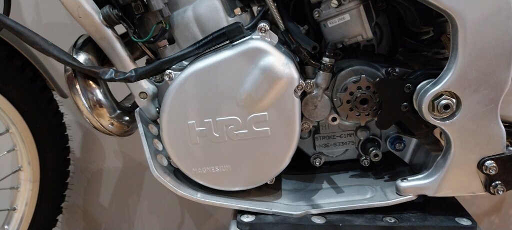

ahell Posted November 15, 2024 Author Report Share Posted November 15, 2024 (edited) Subtle detail, the ex-factory ignition cover from Banyeres. ... It is only different from the original by its lighter color than in the series. I still need a few titanium screws to put everything together. Edited November 15, 2024 by ahell 1 Quote Link to comment Share on other sites More sharing options...

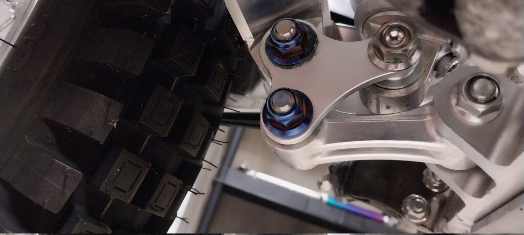

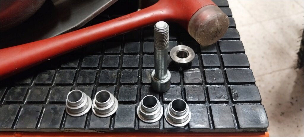

ahell Posted December 9, 2024 Author Report Share Posted December 9, 2024 (edited) New ergal parts 70grs less than OEM steel parts. Edited December 9, 2024 by ahell Quote Link to comment Share on other sites More sharing options...
