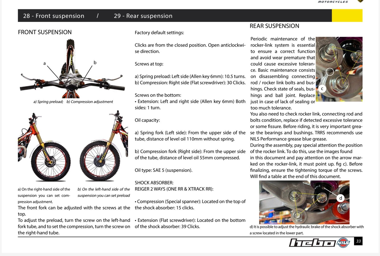

I have a 2023 TRS One RR. On the upper left fork spring preload can be adjusted. What is on the upper right leg, please ? On newer online manuals it is written compression adjustment on older ones rebound?
What is on the lower part of the forks? On all manuals it's written that both legs have extension adjustments to be turned 1 turn out from all closed but it seems very odd as one leg has the spring ( left ) and the other ( right ) the oil ( correct me if I'm wrong ).

Yes, upper right leg is rebound indeed.
The more you turn it in, the slower it gets.
I got my 2024 RR with the rebound adjuster completely open (unscrewed) from factory.

Hi Sergio, I am very surprised the User's manual reports that the upper right leg is compression...checking better older and newer manuals all report that right upper leg adjustment is compression! Please see screenshot attached!
