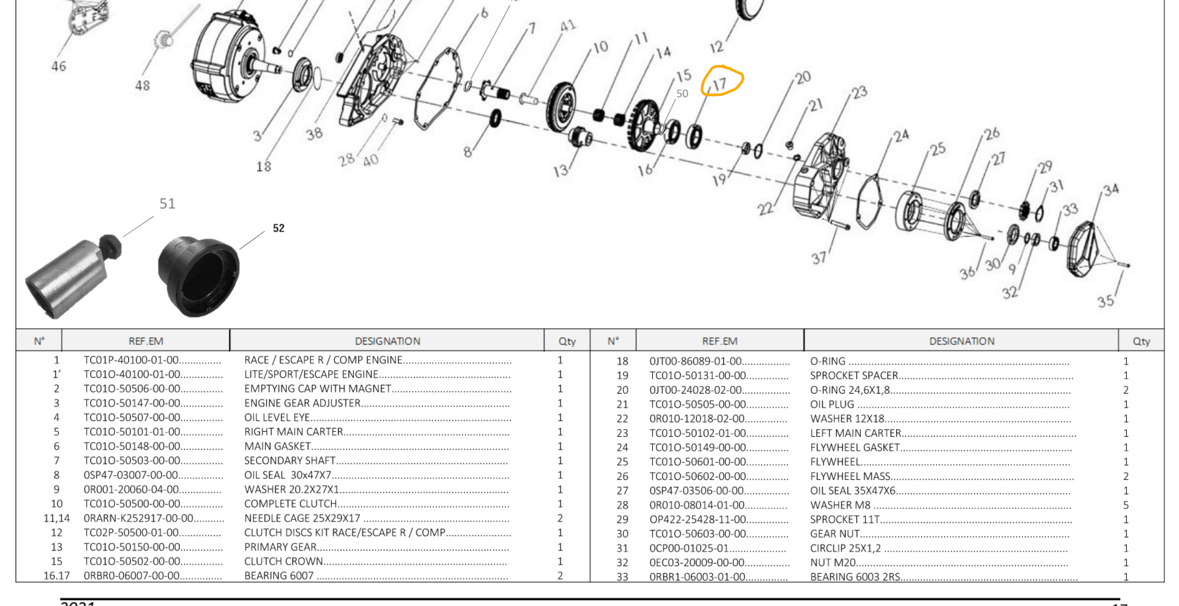

WIX-ONE Posted September 12 Author Report Share Posted September 12 9 minutes ago, konrad said: Which bearing did you decide was the possible issue? Based on the location of the noise i thought it was 17 Quote Link to comment Share on other sites More sharing options...
WIX-ONE Posted September 12 Author Report Share Posted September 12 11 minutes ago, konrad said: Which bearing did you decide was the possible issue? Based on the location of the noise i thought it was 17 Quote Link to comment Share on other sites More sharing options...
