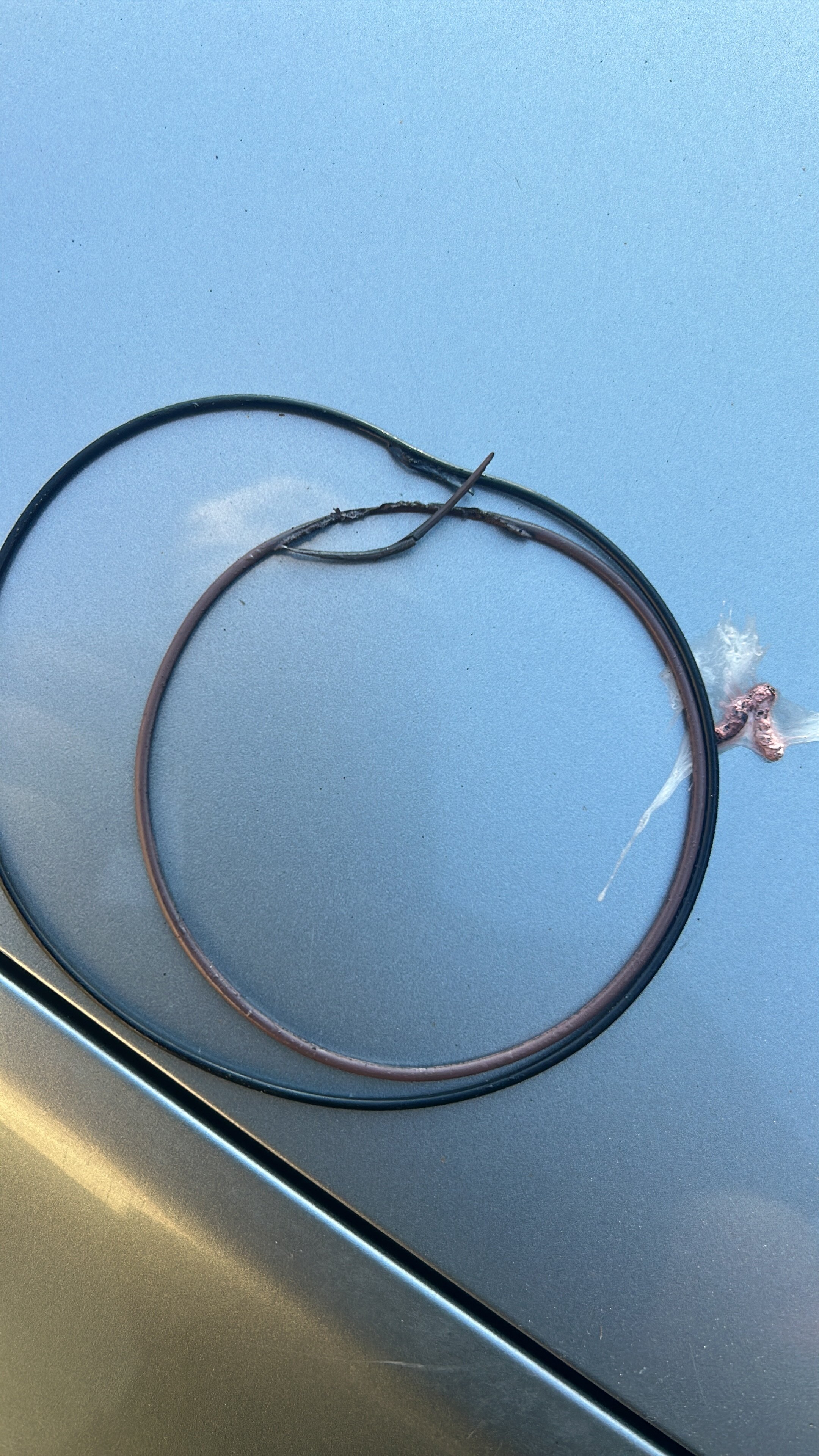

PatMc Posted yesterday at 06:59 PM Report Share Posted yesterday at 06:59 PM Evening all Hope your all keeping well . Bit of an issue with the above mentioned bike . Just did a top end rebuild on this bike bike , all went well or so I thought . It ran fine the first time I kicked it over . Tried again today and while it did run it stopped and seem like a heap of pressure was built up in kickstart. Whipped the plug out and noticed there was coolant there , not much I might add. Took the head off and the two o-rings were damaged. Also noticed that at the spot where the o-rings were damaged , the respective screws in the barrel were loose. Before I start ripping and tearing at it any more if there anything I might have missed to cause this or is it a simple case where I may have got bad o-rings Any help would be great Cheers Paddy McDonald Quote Link to comment Share on other sites More sharing options...
lineaway Posted yesterday at 07:30 PM Report Share Posted yesterday at 07:30 PM I would say they moved out of place during installation. Try again. 1 Quote Link to comment Share on other sites More sharing options...
PatMc Posted yesterday at 07:57 PM Author Report Share Posted yesterday at 07:57 PM I’m thinking that too mate , just wanted to be sure thanks Quote Link to comment Share on other sites More sharing options...
lineaway Posted 20 hours ago Report Share Posted 20 hours ago I always used a little grease to hold them in place. Good Luck! 1 Quote Link to comment Share on other sites More sharing options...
