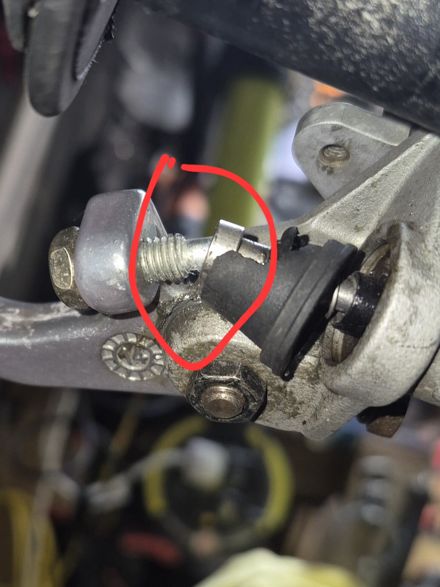

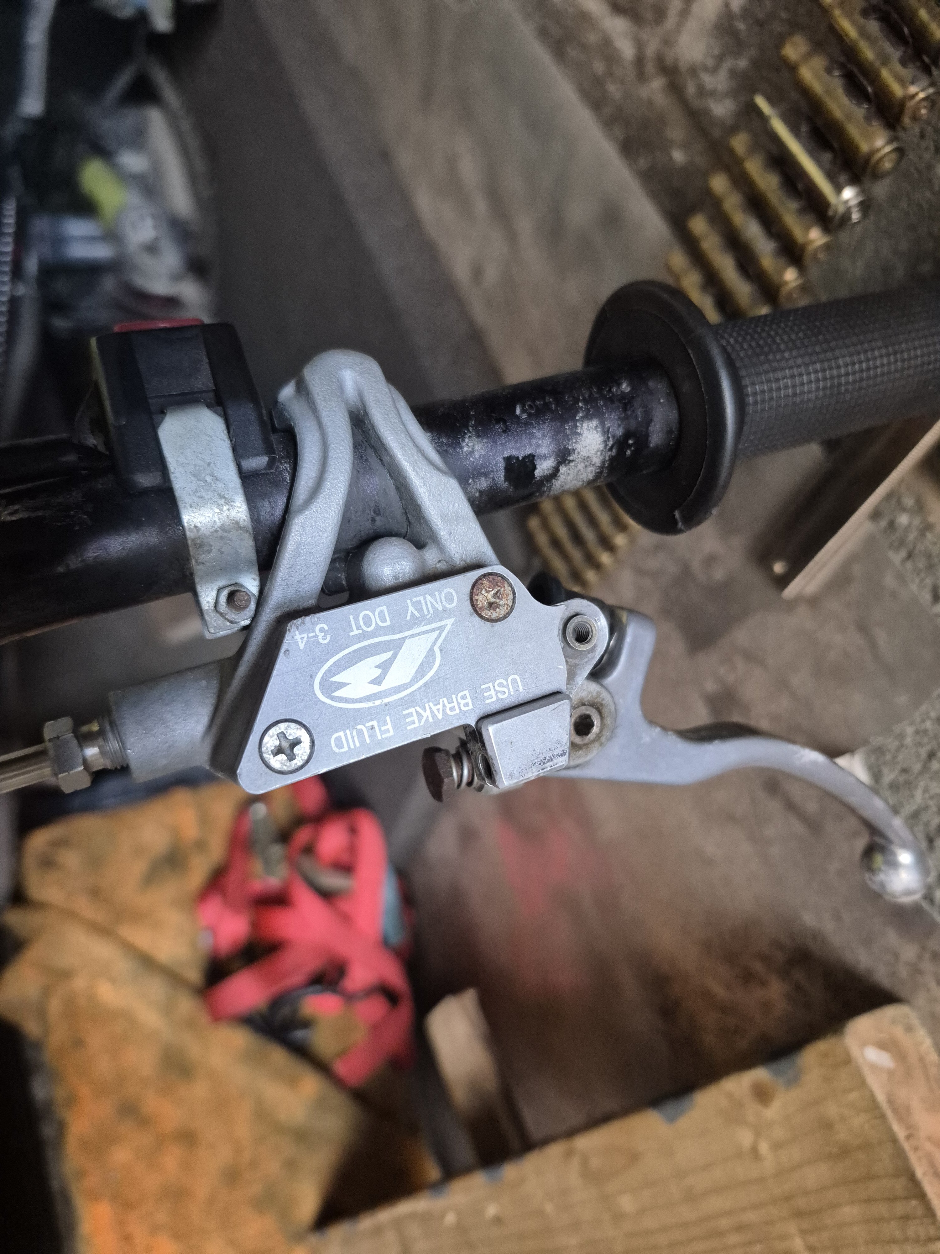

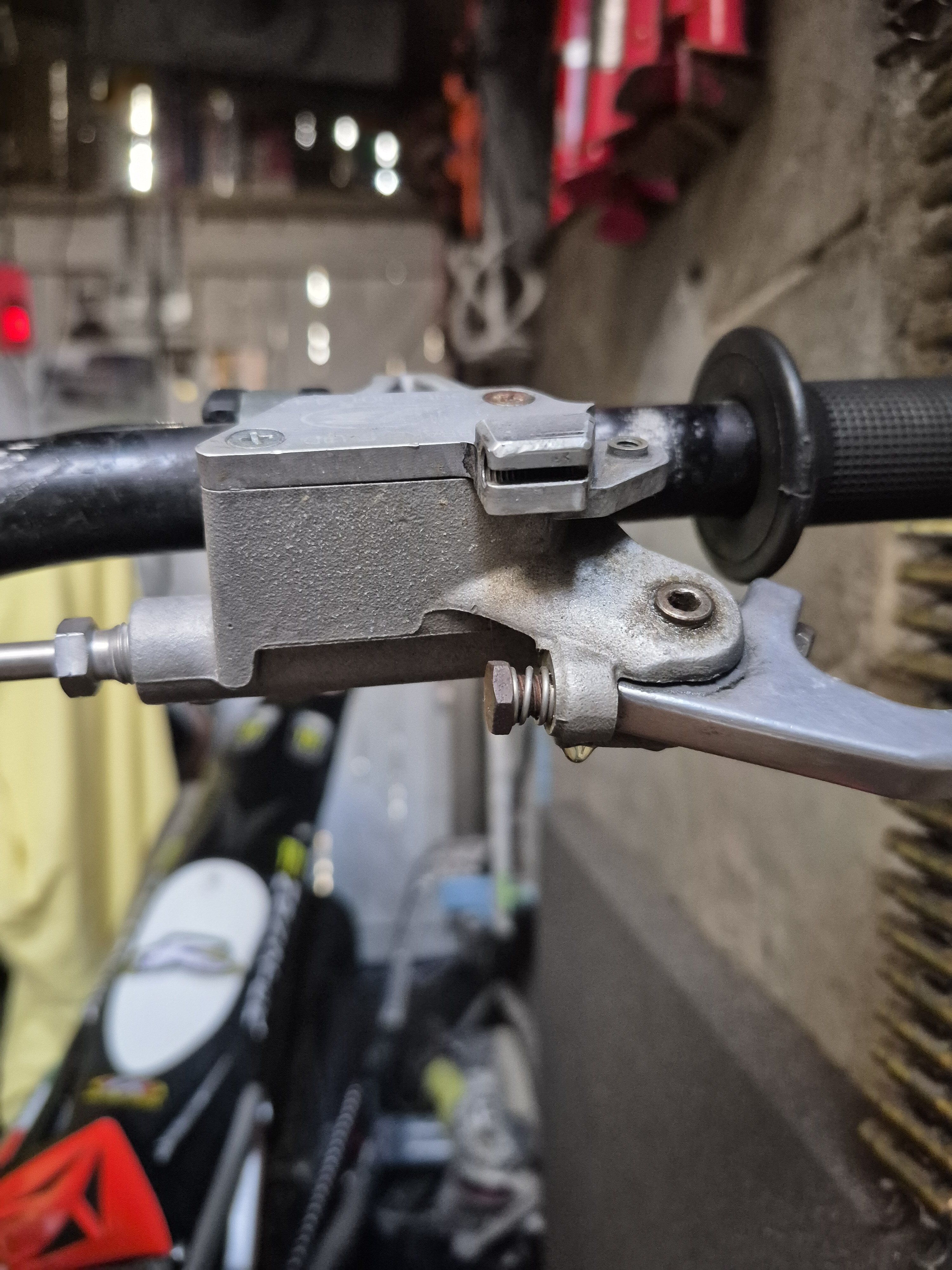

Noel09 Posted June 26, 2025 Report Share Posted June 26, 2025 Hi everyone. Totally new to trials and Totally new to beta. I just bought a cheap and cheerfull 2007 rev4t 250 4-stroke. The clutch is dragging and it seems to then when driving it has to be let out completely then it engages kinda sharply. Anyway I found a few hints where you file the glue off the friction plates and polish the little dogs on the plates so I'll try that. But the lever is a bit sloppy and the screw that pushes the piston in the master cylinder is pushing at an angle? There's a small leak there too. Having a little trouble finding a master cylinder rebuild kit for it, hard to identify my master cylinder? Any tips appreciated. I'll add photos of master and of the parts that don't seem to line up. Quote Link to comment Share on other sites More sharing options...
