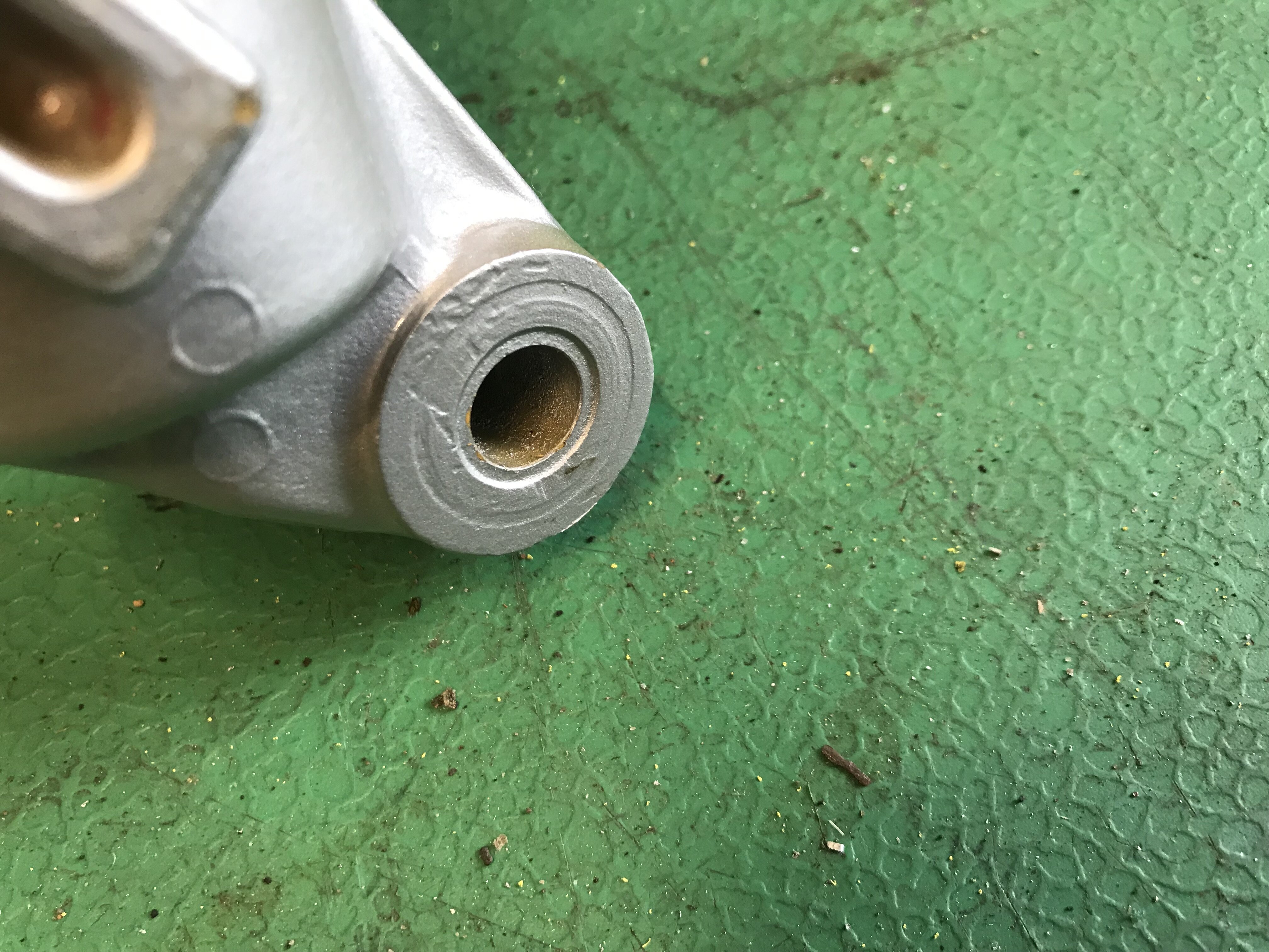

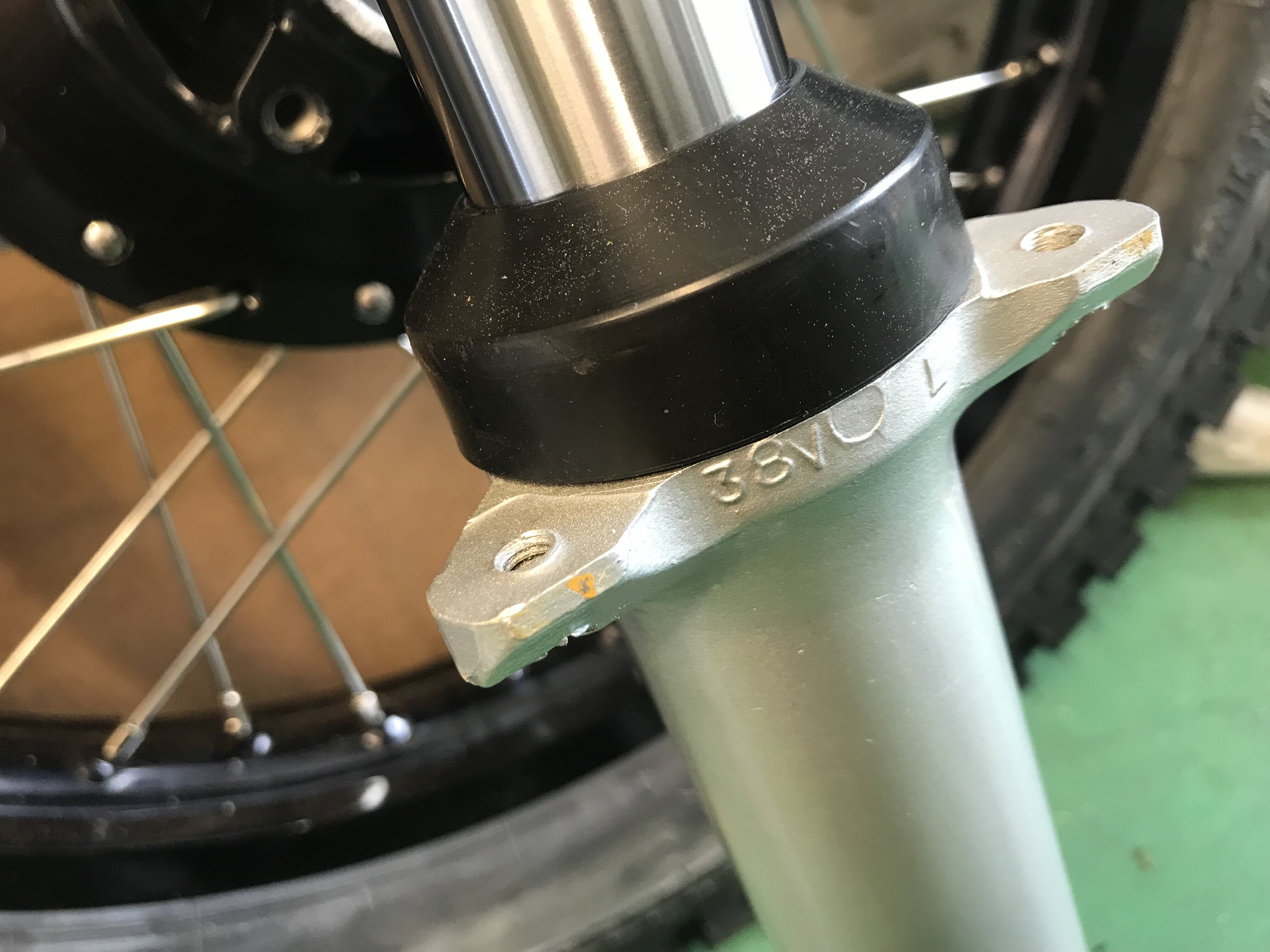

Neil0350 Posted July 4, 2025 Report Share Posted July 4, 2025 Hi all, I have a pair of TY250 mono forks model 38V, but the left fork leg doesn’t have a thread cut into it for the axle bolt, the plain hole is small enough diameter to tap a thread into. I’m just wondering why it wouldn’t have had the thread in it already?. Has anyone come across this before? thanks Quote Link to comment Share on other sites More sharing options...
feetupfun Posted July 9, 2025 Report Share Posted July 9, 2025 (edited) On 7/5/2025 at 12:13 AM, Neil0350 said: Hi all, I have a pair of TY250 mono forks model 38V, but the left fork leg doesn’t have a thread cut into it for the axle bolt, the plain hole is small enough diameter to tap a thread into. I’m just wondering why it wouldn’t have had the thread in it already?. Has anyone come across this before? thanks Maybe a previous owner modified it to suit a different axle. If the hole is 12mm, the original threaded hole may have been drilled out and bushed to suit a through axle. Edited July 9, 2025 by feetupfun Quote Link to comment Share on other sites More sharing options...
