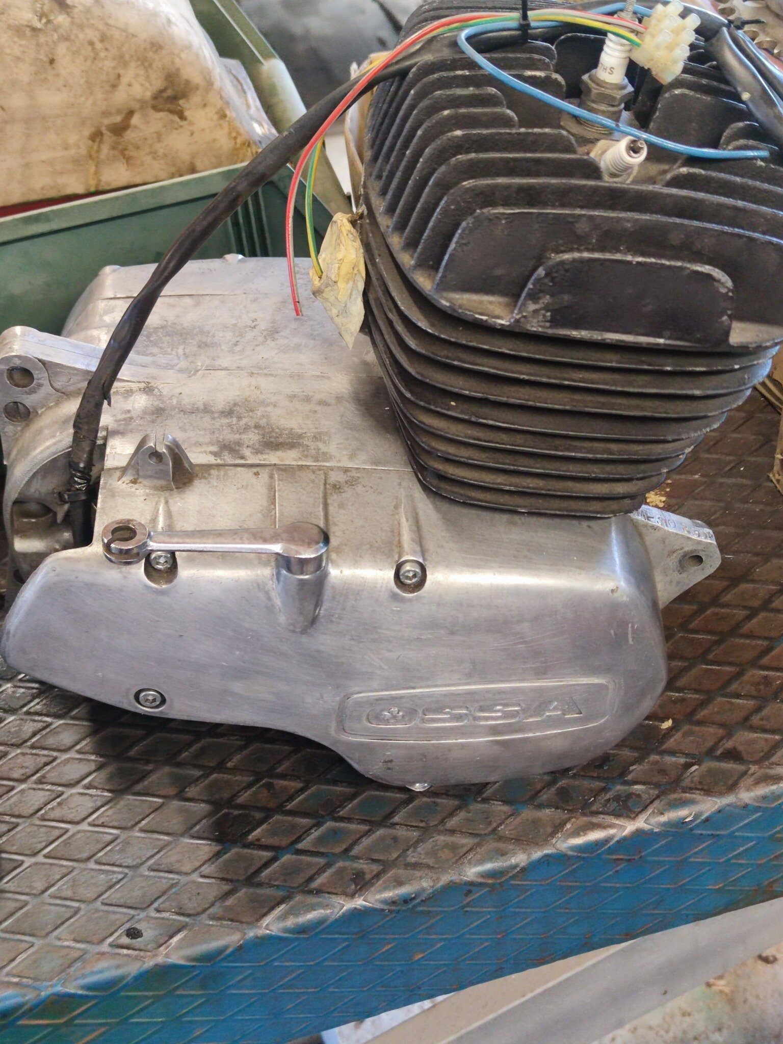

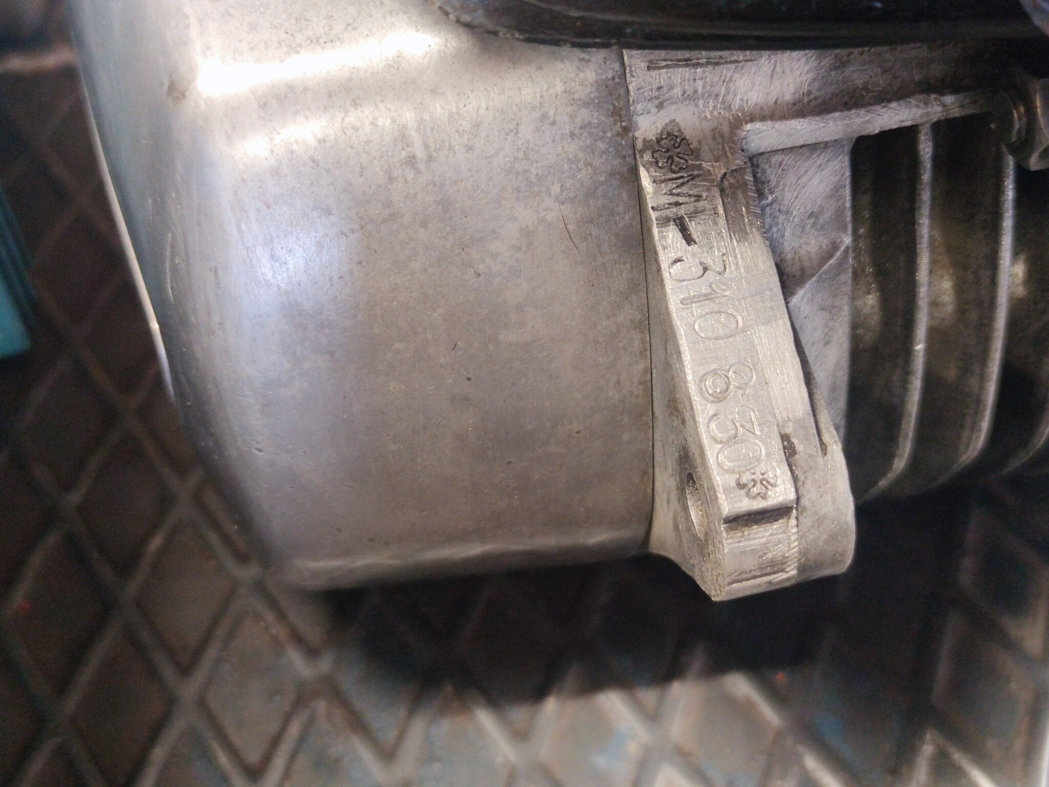

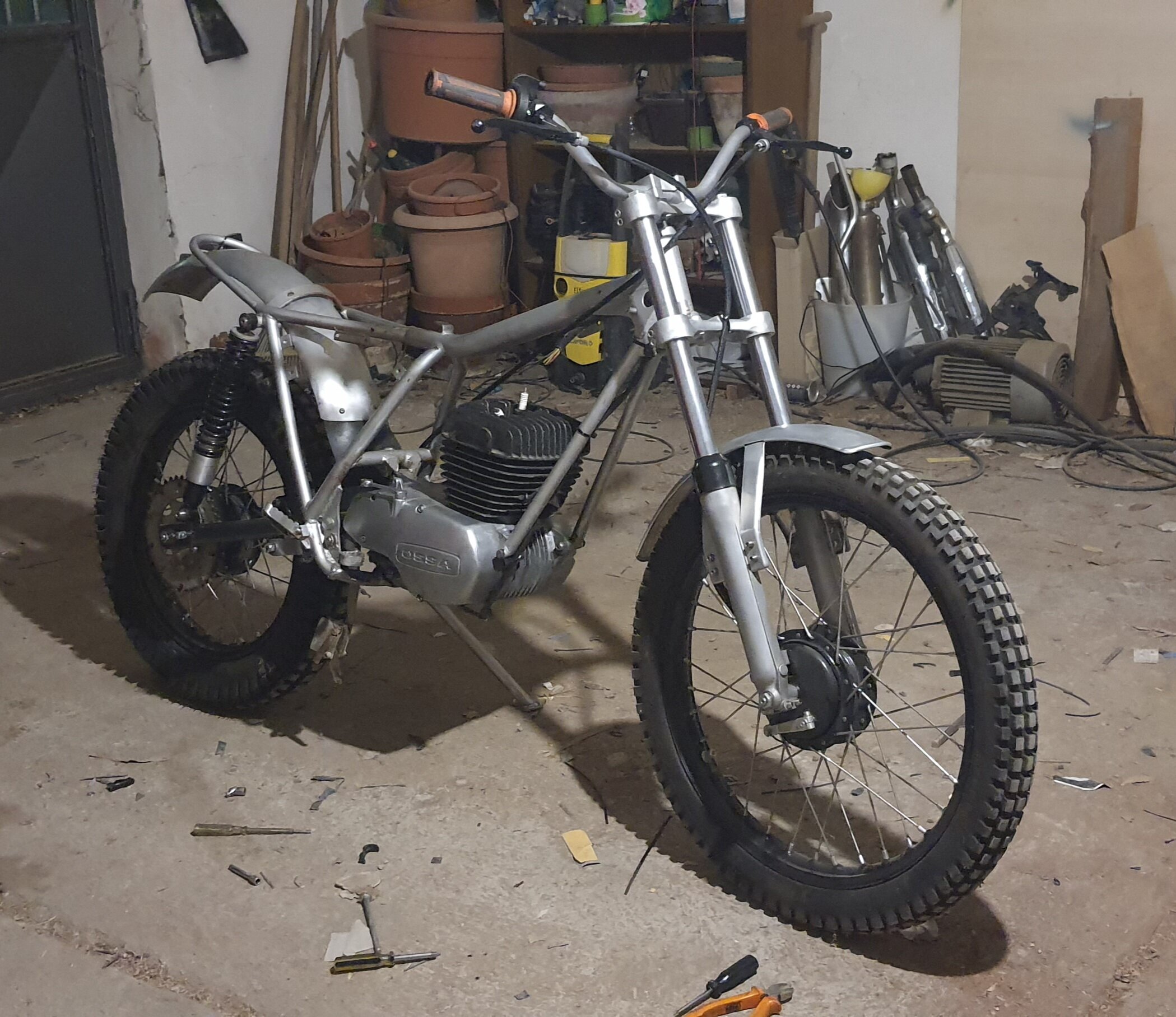

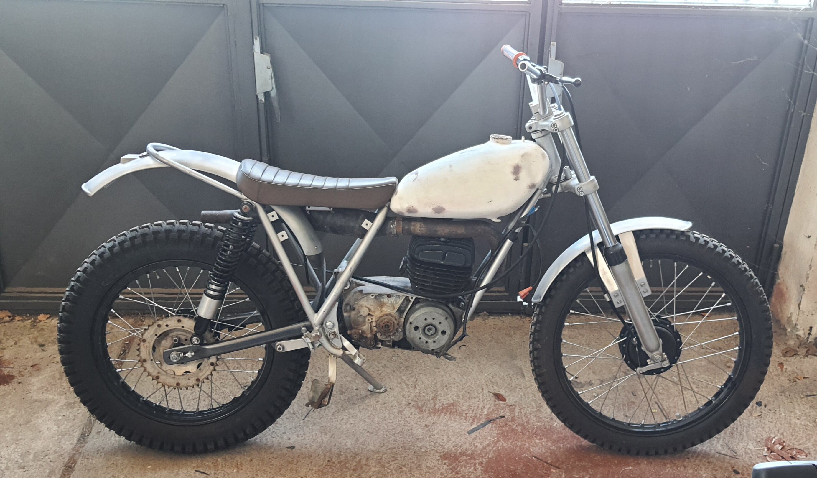

Triad Posted October 14, 2025 Report Share Posted October 14, 2025 (edited) Hello guys, last year I've got a 1973 Explorer with a semi-seized engine. Managed to find another one that should be in working conditions but the owner doesn't know which model it's from. I tried putting the engine in, it looks the same when it comes to frame brackets but it doesn't fit... it's like it's slightly thicker than the stock one where the engine meets the frame in the swingarm/filter area. Also noticed the right side sprocket cover is different (longer)... any idea? Is it better to slightly file the engine bracket or the frame? Edited October 14, 2025 by Triad added pictures Quote Link to comment Share on other sites More sharing options...
konrad Posted October 15, 2025 Report Share Posted October 15, 2025 (edited) 16 hours ago, Triad said: Is it better to slightly file the engine bracket or the frame? Those engine brackets already look pretty insubstantial by modern standards. I would not want to thin them. How much material do you think needs to be removed? Make some measurements. P.S. It may be preferable to heat and bend the frame mounting points. In general, I try not to make modifications that can't readily be undone. Edited October 15, 2025 by konrad Quote Link to comment Share on other sites More sharing options...

Triad Posted October 15, 2025 Author Report Share Posted October 15, 2025 Well, the original Explorer engine turns but it takes a lot of force... probably a seized bearing on the bottom? Also not sure the Motoplat works, as it requires 500rpm to make a spark and there's no way to make it turn that fast as is. It's been outside for years, I think, so rust might be the issue... and the reason for being there might have been a broken Motoplat unit (no spark)? No way to know for sure. The "new" engine was stored on a shelf with the inlet taped, and the guy told me it was bought from a reputable seller, so IN THEORY it should run. I plan to make the engine brackets slightly thinner as they're massive, while the frame brackets are already thin. I'll have to measure them, but as I said I'm now worried other parts might be different and I might find out the hard way. Quote Link to comment Share on other sites More sharing options...
woody Posted October 15, 2025 Report Share Posted October 15, 2025 The centre cases are all the same casting so are interchangeable. The reason the ignition cover might look different is because the rear most part sometimes gets cut off or modified, either to stop a build up of mud or they simply get broken by derailed chains The replacement engine is an enduro engine, the Explorer is a trials engine. The enduro motor will have a different state of tune/porting and different gear ratios. They also use an expansion chamber motocross type exhaust although your Exporer exhaust should still fit into the cylinder. They use a 32mm carb as they're basically a race engine It's not an uncommon problem to find a different engine won't slide into the rear frame mounts. You might find that the mounting brackets have been squashed inwards slightly with repeated tightening over the years. You can try puting a piece of solid bar against the inside face of one and putting a solid bar through the hole in the other and tapping outwards, then repeat on the other side to try and open them out a bit. Or just take a bit off the engine to enable it to slide in 2 Quote Link to comment Share on other sites More sharing options...

woody Posted October 16, 2025 Report Share Posted October 16, 2025 The stator can be checked, you'll need the workshop manual which will give the expected readings, I've no idea, electrics are a mystery to me. In the UK we can get them repaired. The motoplat coil for the Ossa is a combined coil / cdi so you need the two connector type. New replacements are available (at least here in the UK they are) When I saw the picture of your replacement engine I assumed it was the same year as yours but someone had changed the cylinder head for a later one. It seems the chassis number list I have incorrectly lists the engine as a 1972 but it's actually a 1976 enduro version, so, the kickstart and gear shafts have a different number of splines from your explorer engine. I think that the exhaust fitting on the later enduro motor is push fit with springs, not threaded collar, so your exhaust header isn't a straightforward fit To be honest you're probably better off fixing your explorer engine, all parts are available. 1 Quote Link to comment Share on other sites More sharing options...
