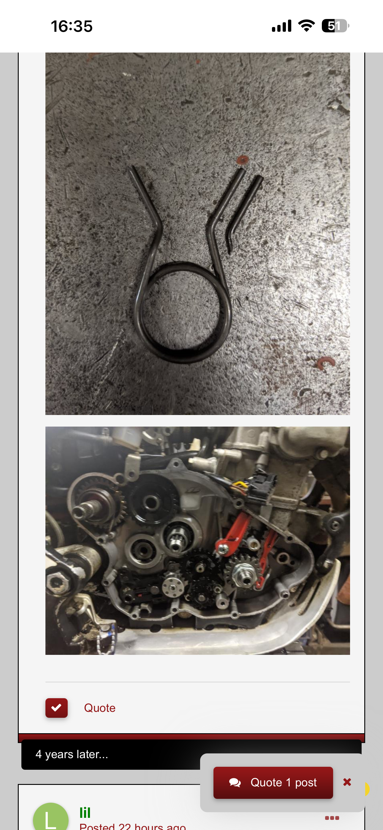

lil Posted October 25, 2025 Report Share Posted October 25, 2025 I have a problem with the gear shifter. When I shift up, it stalls and the shifter gets stuck up and doesn't go down, but from up to down it goes easily. What could be the problem? Quote Link to comment Share on other sites More sharing options...
lineaway Posted October 26, 2025 Report Share Posted October 26, 2025 The weld broke on the shift shaft. You need to take the clutch off to get the shaft assembly out. Quote Link to comment Share on other sites More sharing options...
lil Posted October 26, 2025 Author Report Share Posted October 26, 2025 you mean this is problem or not because i dont uderstand can u help me if u have same problem? Quote Link to comment Share on other sites More sharing options...
