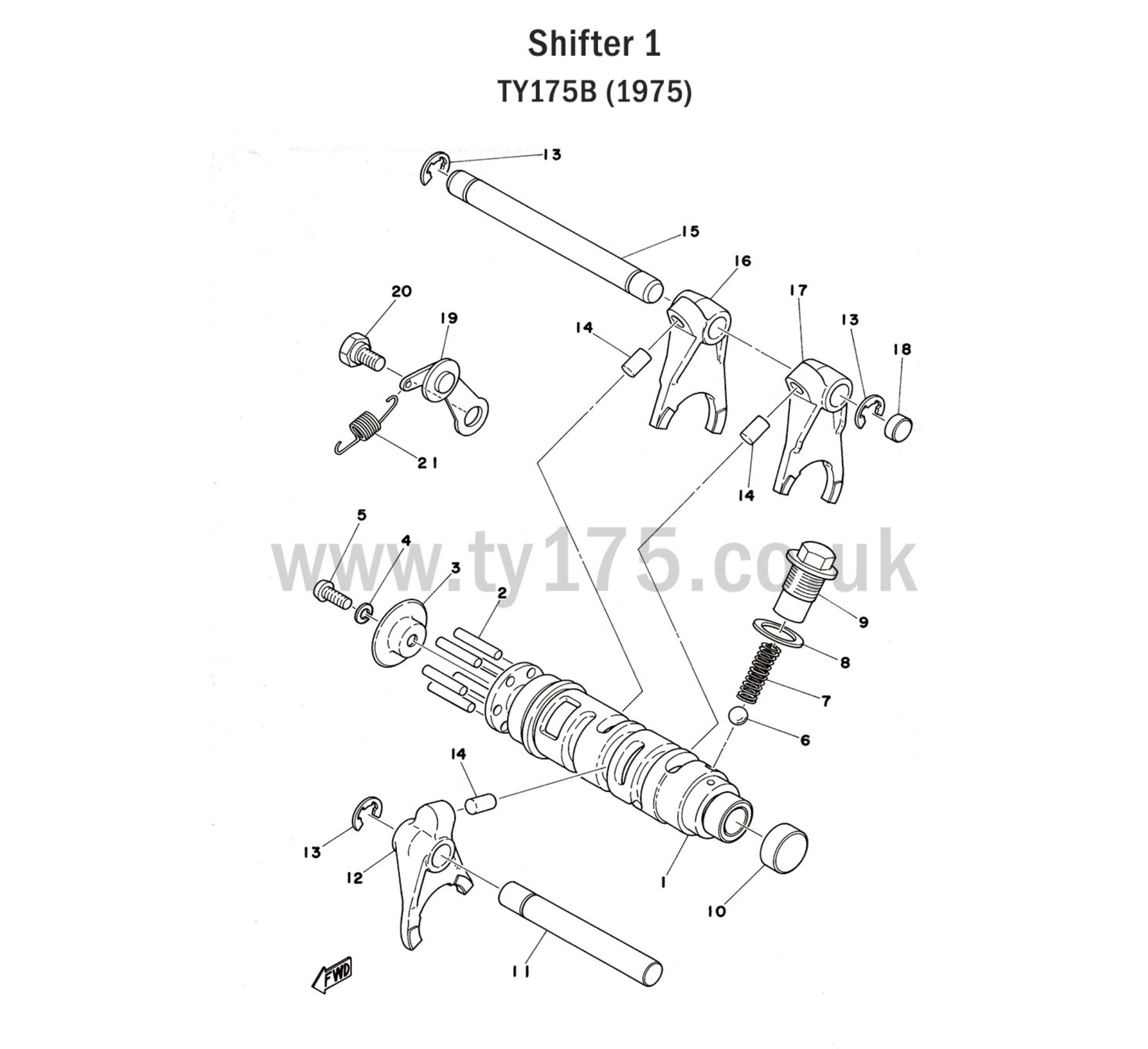

Niro Posted December 23, 2025 Report Share Posted December 23, 2025 Hi, The ball and the spring for the shift cam can be installed through the threaded hole when the cases are put together? or only when the cases are split? (the cases are currently split, and there actually no ball, just spring) Part number: 93505-16006 (#6 in the attached picture) thanks Quote Link to comment Share on other sites More sharing options...
feetupfun Posted December 23, 2025 Report Share Posted December 23, 2025 12 hours ago, Niro said: Hi, The ball and the spring for the shift cam can be installed through the threaded hole when the cases are put together? or only when the cases are split? (the cases are currently split, and there actually no ball, just spring) Part number: 93505-16006 (#6 in the attached picture) thanks The ball and spring can be installed or removed with the engine assembled Quote Link to comment Share on other sites More sharing options...
