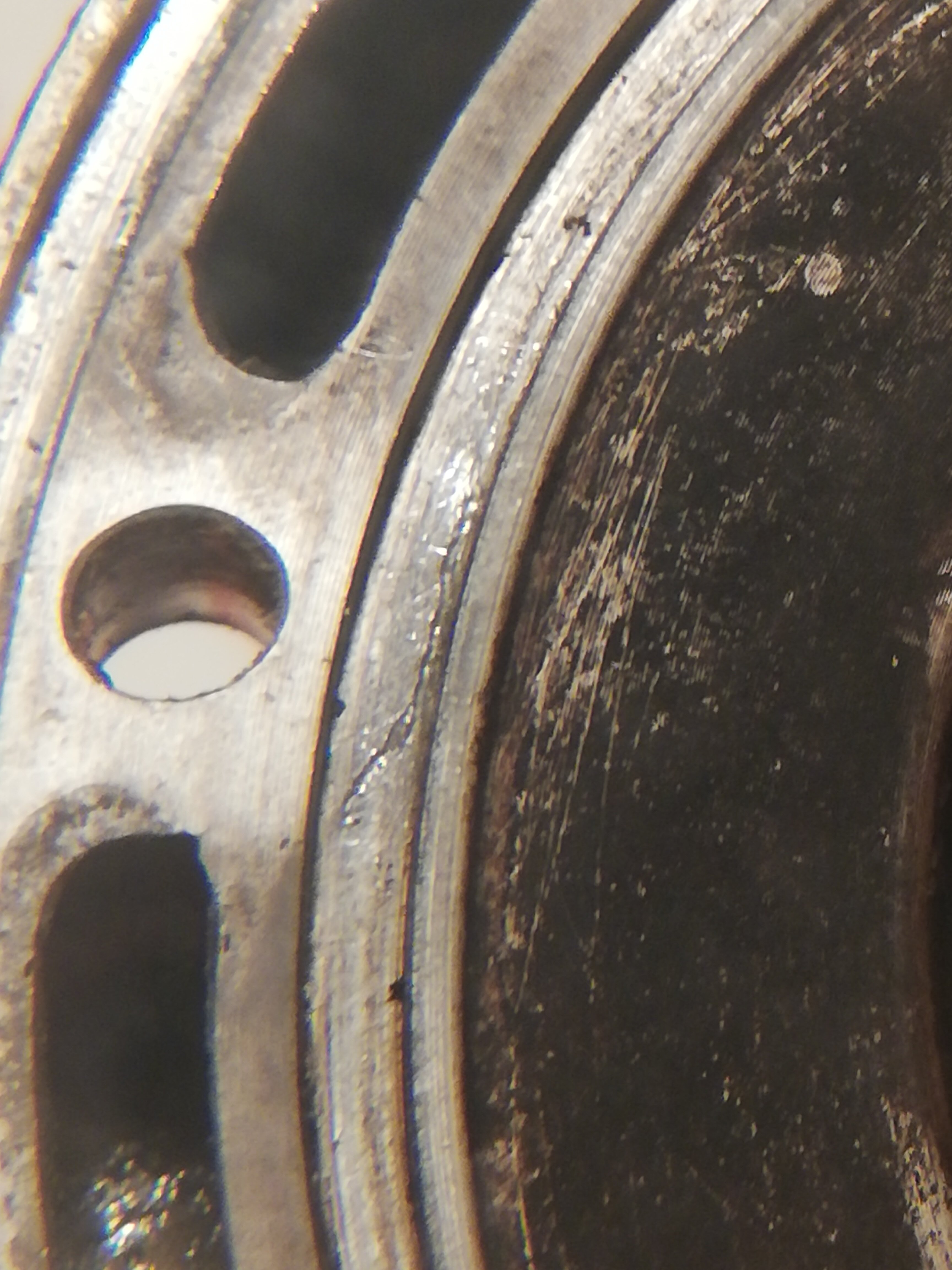

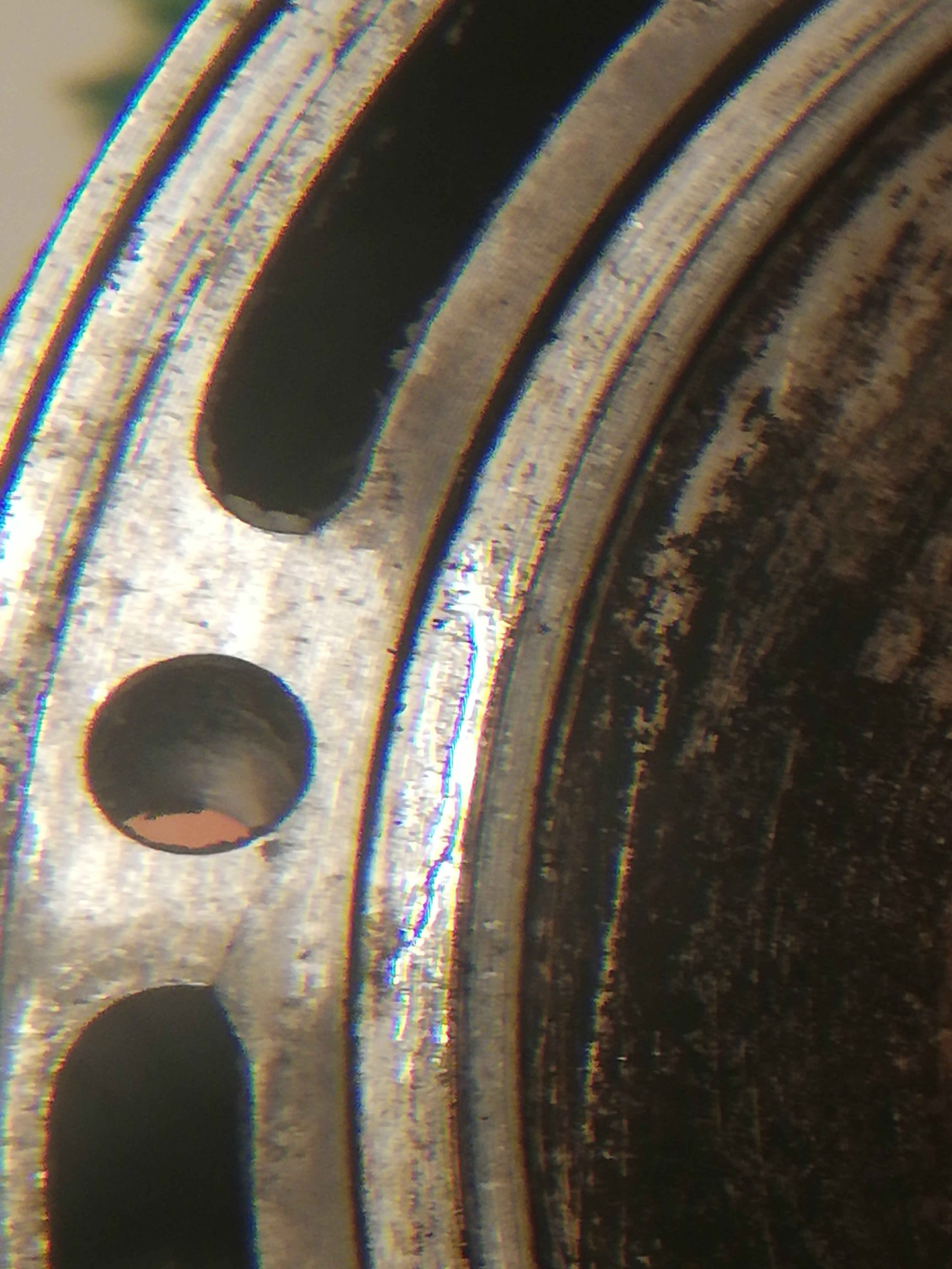

Joda76 Posted February 18 Author Report Share Posted February 18 (edited) I have found two, next to a muffler mount (photo1),it was almost invisible util I started digging into it.... next one in line further away from muffler mount (photo2). Edited February 21 by Joda76 Quote Link to comment Share on other sites More sharing options...
Joda76 Posted February 19 Author Report Share Posted February 19 (edited) Pauls320 thank you so much for your comment. If I did not inspect head grooves I would of slammed it back with a new o-rings and afterwards would be like🤔 I was suspicious though, because when disassembling I figured by the head bolts that the head was done before, and when I inspected o-rings they were flexible an in like new condition. Previous owner must of bin frustrated for not fixing it and sold it Edited February 19 by Joda76 Quote Link to comment Share on other sites More sharing options...

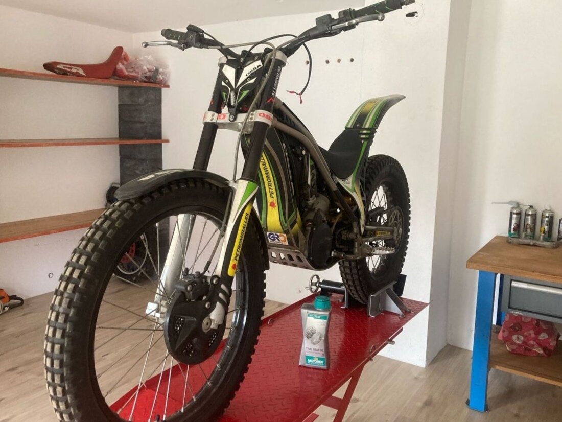

Joda76 Posted March 9 Author Report Share Posted March 9 (edited) On 3/6/2026 at 4:48 AM, pauls320 said: Sorry to hear that this was indeed the problem. If I remember correctly, the later ones had a larger bottom out bumper on the shock shaft...? Depending on your ride weight you may want to adjust the spring a littler stiffer and/or possibly modify the header pipe,where it tags the swing arm, before trying out a new head. Hope you get her sorted out I have ordered S3 head and O-ring set from Spain, slipped in magnetic kill switch for free shipping😎...206e total, not the end of the world. I will update when I find time to finish fixing it...I am seriously considering to detach muffler from head and modify it so it is attached to a frame instead, because this is seriously bad design decision. yes, planned to stiffen it a bit while muffler is off. had to put a photo since u called it Her😂 Edited March 9 by Joda76 1 Quote Link to comment Share on other sites More sharing options...
