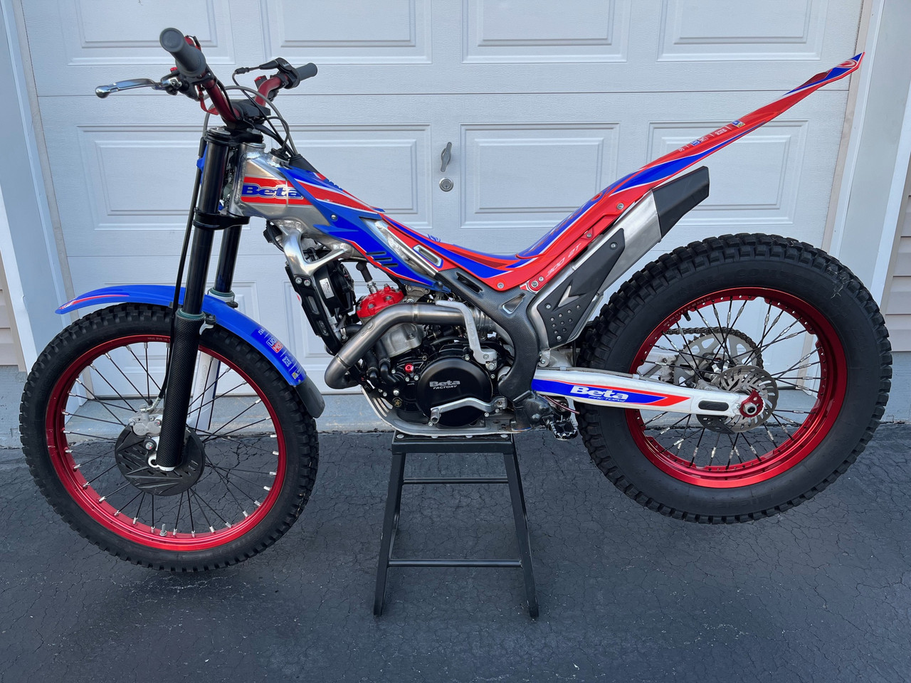

Got some maintenance and mods done today. Looking forward to seeing how it responds!

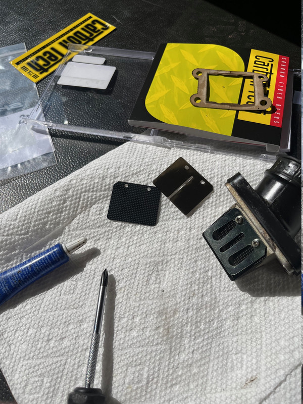

C-F reeds
IMG 7386

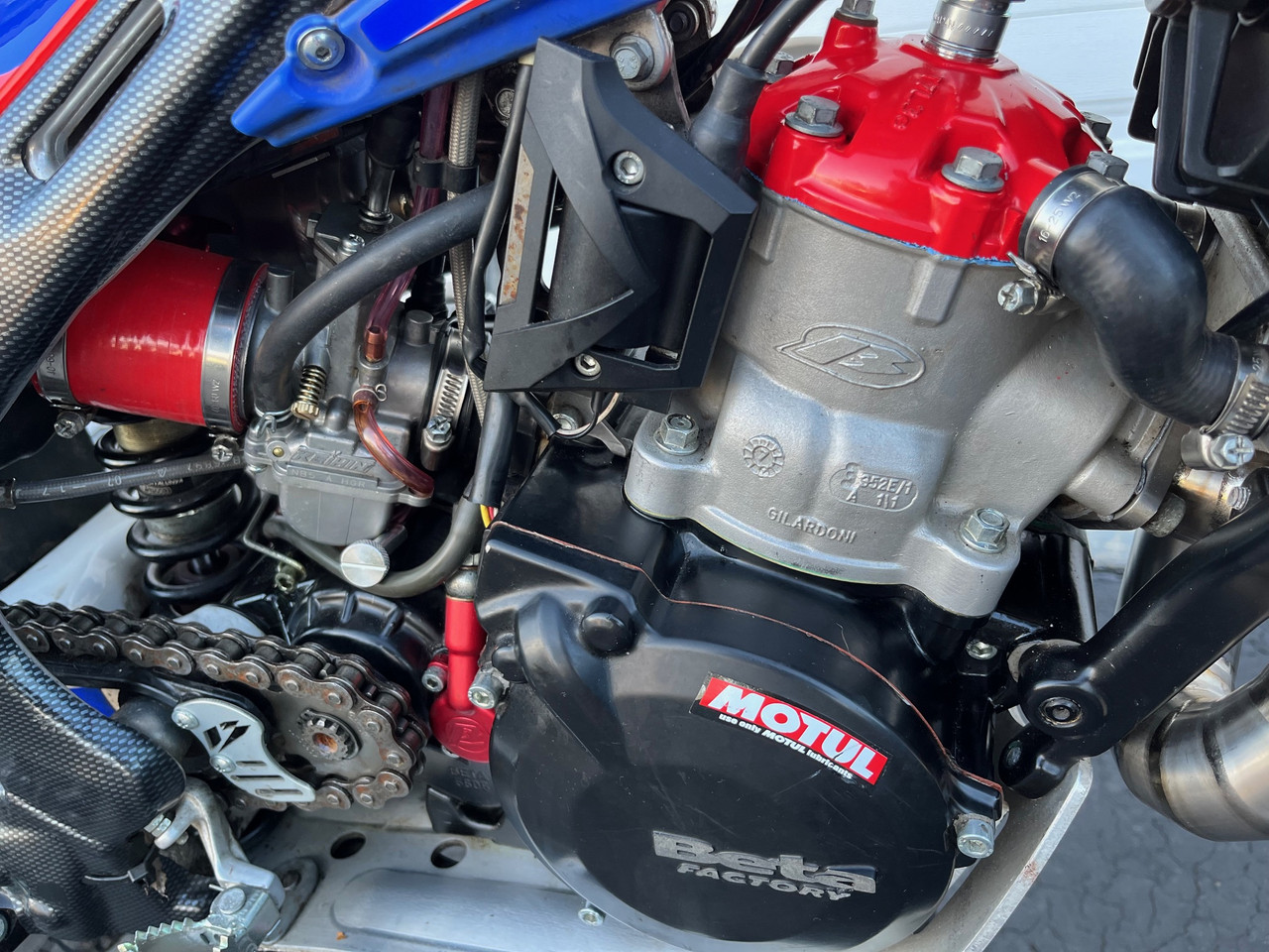

Head insert from a 300ss to lower the CR from 10.6 to 9.6
IMG 7380
Jet block gasket
IMG 7388
New fuel line, remote air screw knob and swapped out the 10t sprocket for an 11 (hoping gearing up will actually make it less jumpy)
IMG 7390
and a long S3 head pipe
IMG 7391
