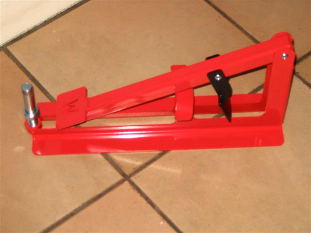

I bought a bead breaker off Wiggy - bloody useful, but that doesn't help you.
