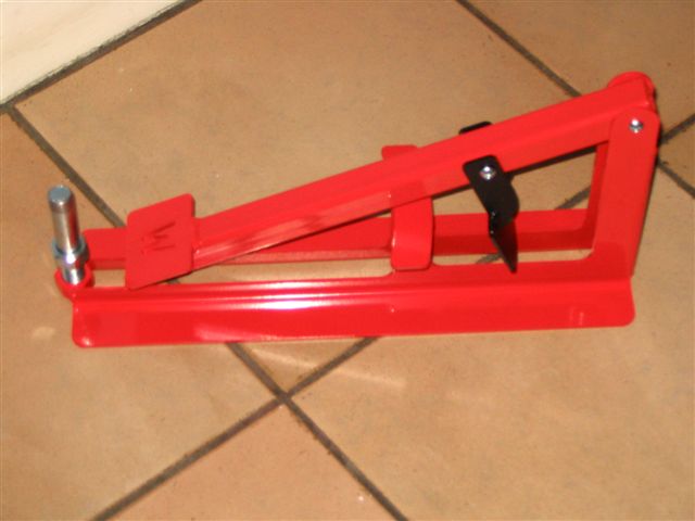

All these very sensible people using wierd & wonderful ways to knock a tyre off when most of them have the talent to knock up a bit of kit just like dabsters. One a mate of mine made earlier:-
It needs so little pressure to work it my 6 year lad could knock a tyre off.
