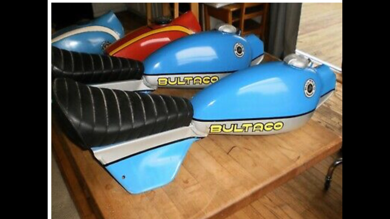

  8. Hello Gentlemen, I am from the USA and I am seeking some information regarding the Homerlight tanks as fitted to your U.K. Sherpa T's. In the photo's below can you tell me what the differences in the right side panels are for. That is which tank fits what? The tank on the left has straight side panels and the one on the right has an outward bulge. thanks! sincerely, Glenn Ranz aka Alpthusiast
