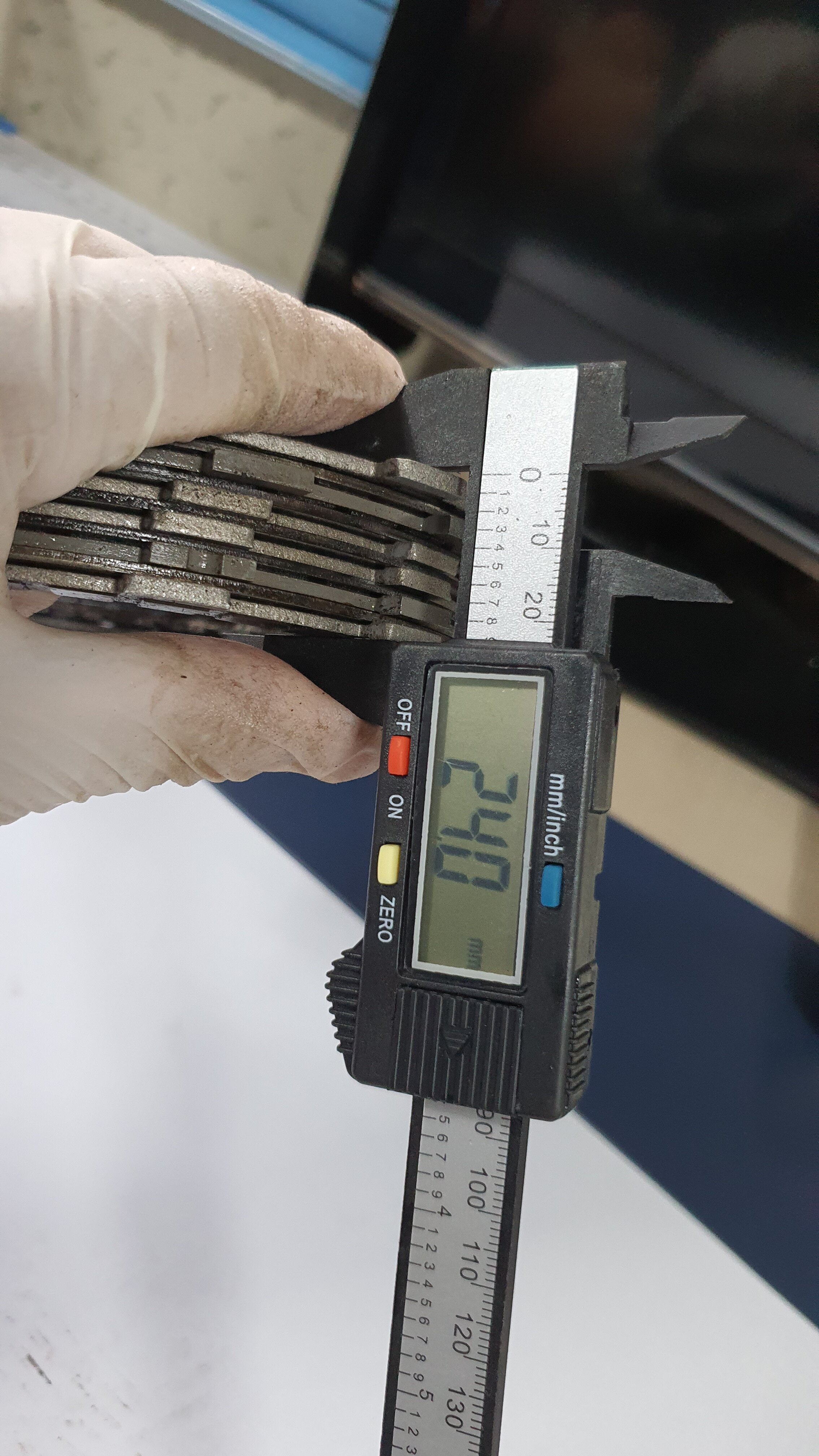

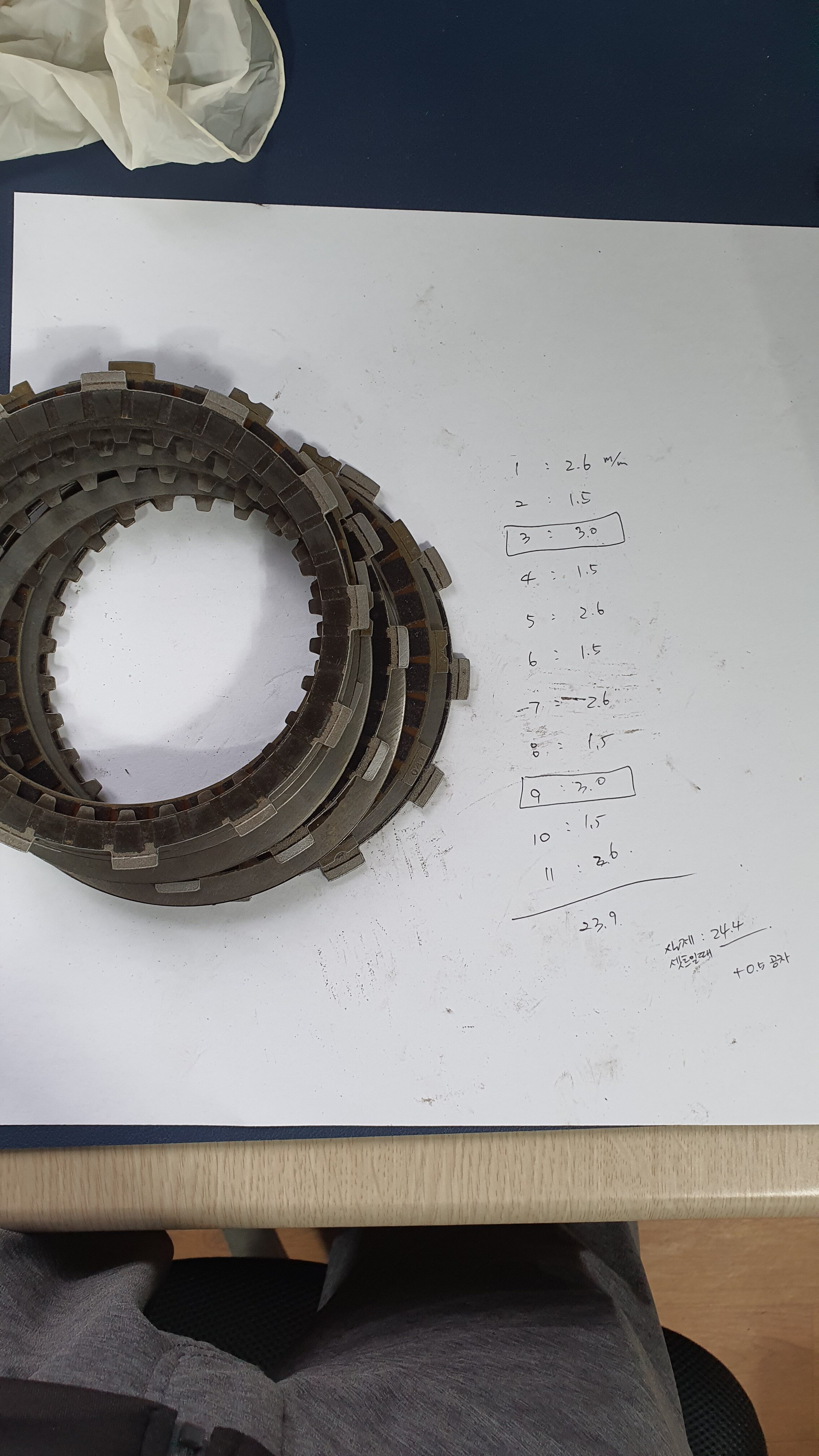

  9. Hi, friends. I have a Sherco 2016 st300 trials bike. The clutch's too heavy. I'd like to know the clutch replacement cycle. The manual says the clutch is up to 2.6 millimeters thick.(per 1 plate) When I measured mine, four were 2.6 millimeters and two were 3 millimeters. I don't know why there are two 3 millimeters in here.I wonder if this is how the new clutch pack works. And the total is 24.0 millimeters. Let me know the thickness of them when combined. Or tell me if I need to replace clutch mineral oil. Thank you, fellas.
