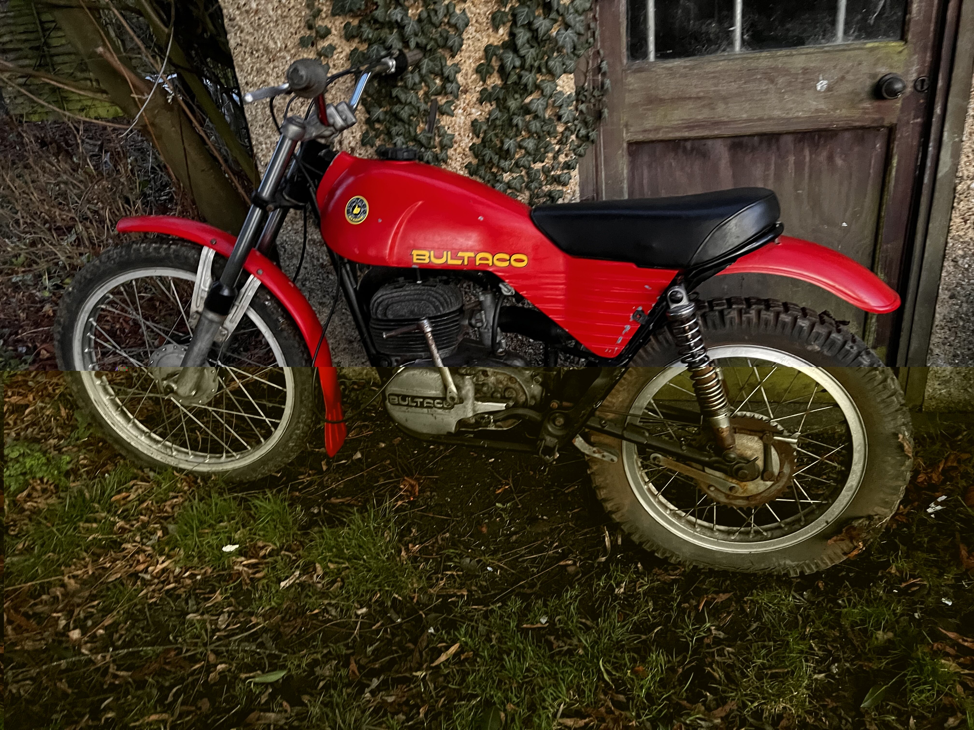

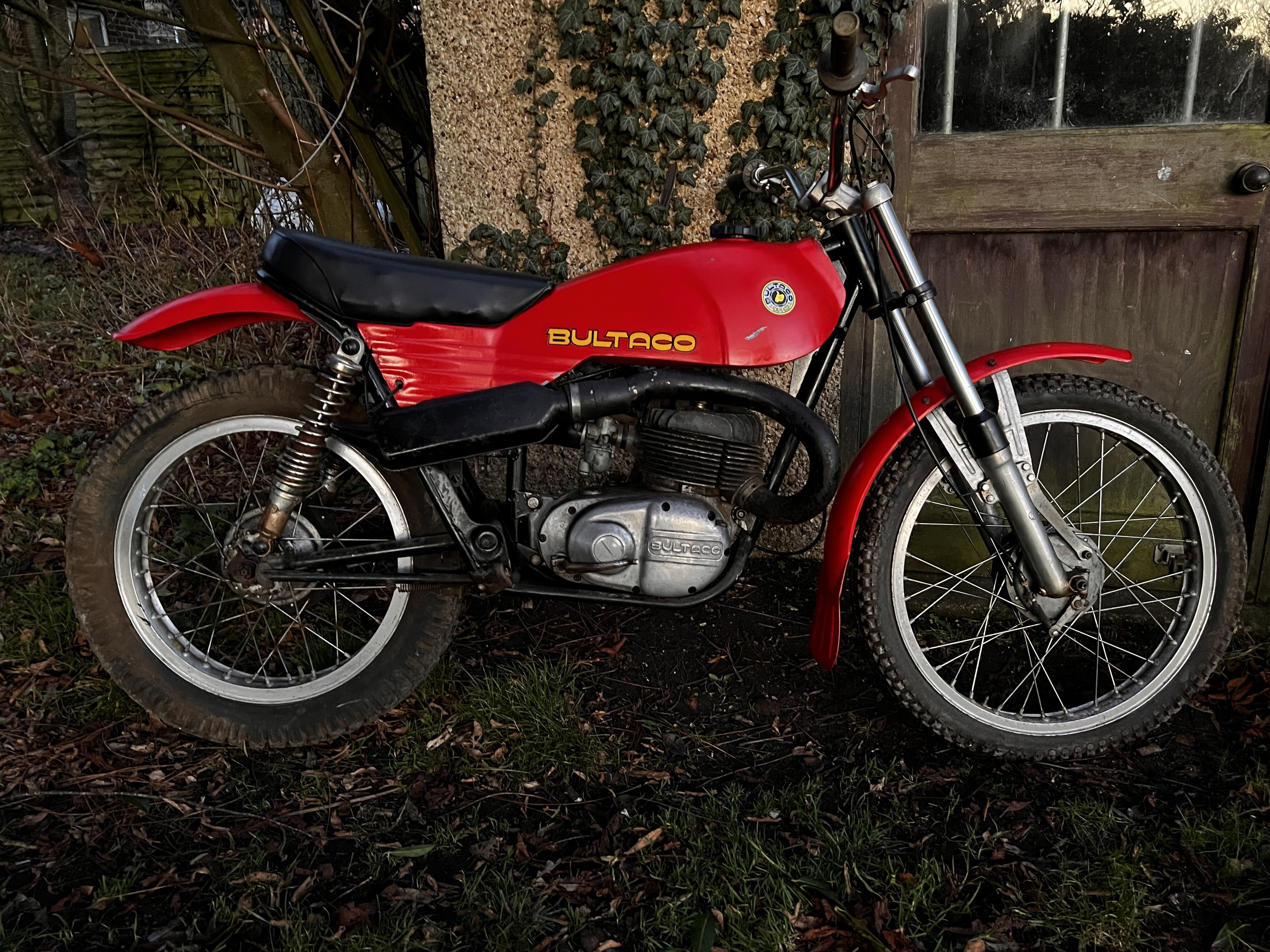

  10. Thanks for the reply's. I tend to agree that buying a proper Sherpa is the best route, but since I already have this now I'll see it through with what I have. Half of the outlay is already done. The exhaust isn't fitted properly and will go behind the frame once I get started on it. I will be stripping the engine completely, so if it's just a case of swapping the gears I'll look for a set. Inmotion are selling new gearbox components at the moment, it's just a mater of what model Sherpa to use? probably model 80. This is the model reference I have found using the engine number. I can't find references to frame numbers alone. I'm inclined not to think it's a 125 with a Sherpa engine, if it were I wouldn't need to change the gears. 85 Alpina 250 (1 st Model) 6638 7/1972 85.000.001 a 85.006.638 Trail Thanks for all your input,
  11. When I was 15 my father bought a brand new Bultaco Sherpa, needless to say I spent more time on it than he did due to his work commitments. I loved it, super reliable and great to ride. Come forward 40 odd yrs and this (what I thought was a Sherpa) came up for sale locally at a reasonable price. it's all there, yes needs some work and a restore/rebuild but it doesn't look too bad. After checking the engine and frame number it seems it's an early Alpina M-8500619 and 9700356. I have had a quick search and it seem that these early Alpinas are basically a Sherpa with slightly different gear ratios. So here are my questions, I know this is the place to ask. Does it look like to you that is has a Sherpa tank seat until or any other Sherpa parts? and am I correct in my assumptions that it's not too far off a Sherpa? I am basically pleased with my purchase either way, I'll restore it anyway but I just wanted some expert eyes to see what others think. Thanks
  12. Well you were 100% spot on. I saw the bike today and the number make it a Mk7 Lobito 125 1973/4 . The owner was trying to tell me it was a 350 Sherpa. I knew that wasn't right but wasn't sure what it was. Problem solved, thanks
  13. Ah, now I did start thinking that but the owner says it's a 350. so I started to lean towards Alpina around 1973. I'm going to look today but I thought Lobido's were only 175's. Thanks for your reply, I feel I'm getting somewhere now.
  14. What year is this Bultaco Sherpa? I'm told its a 1974 but I'm not so sure. What do you think?
