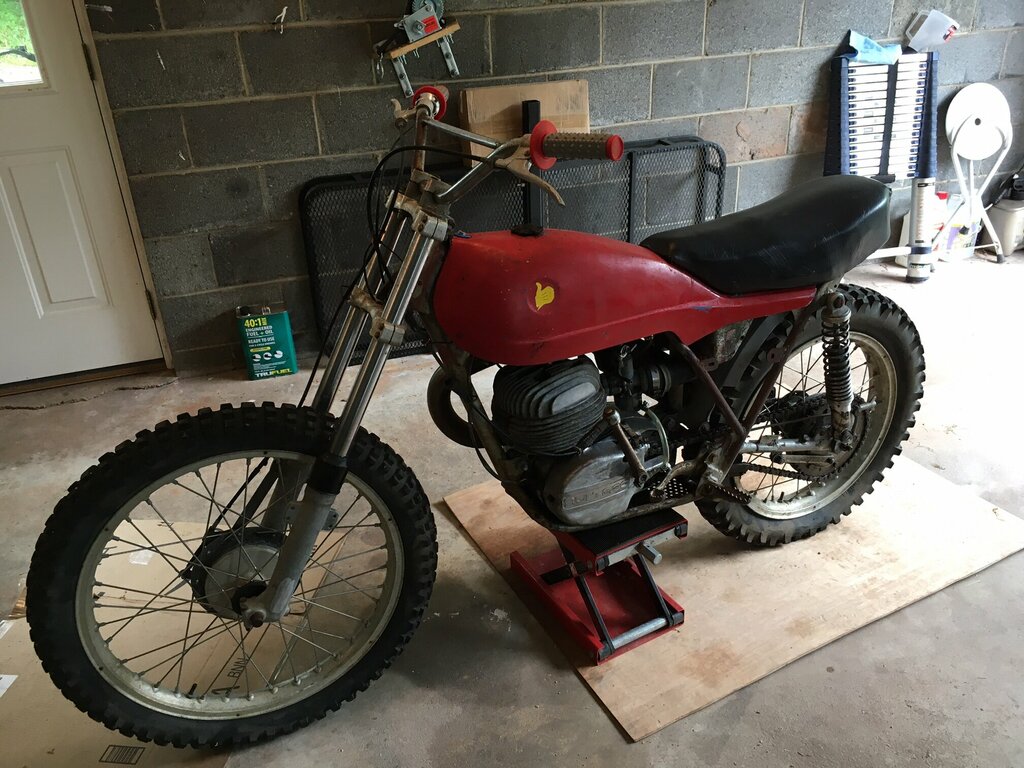

Rebuild a 250 Alpina 1974 type 115
Hello
The bike, the first target is to start the engine with a clean carburetor / exhaust and of course wheels (Tires/ spokes).
I will manage to have a Vermont registration : its's means lights, horn with probably a new ignition with 12 volts supply.
A long way to go 😪

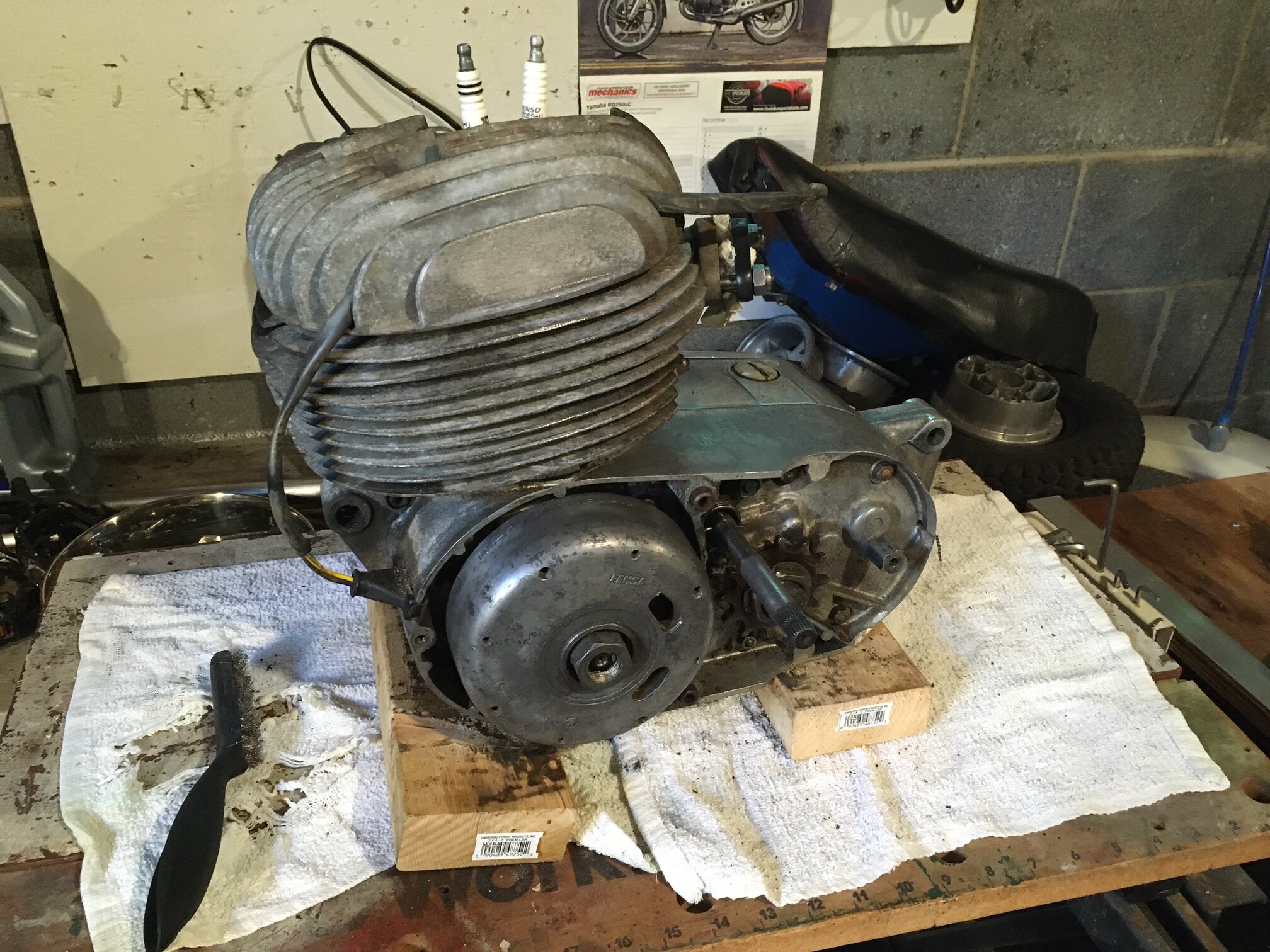

  • Engine is out 🙂, I wish to open it asap but the frame is the priority...

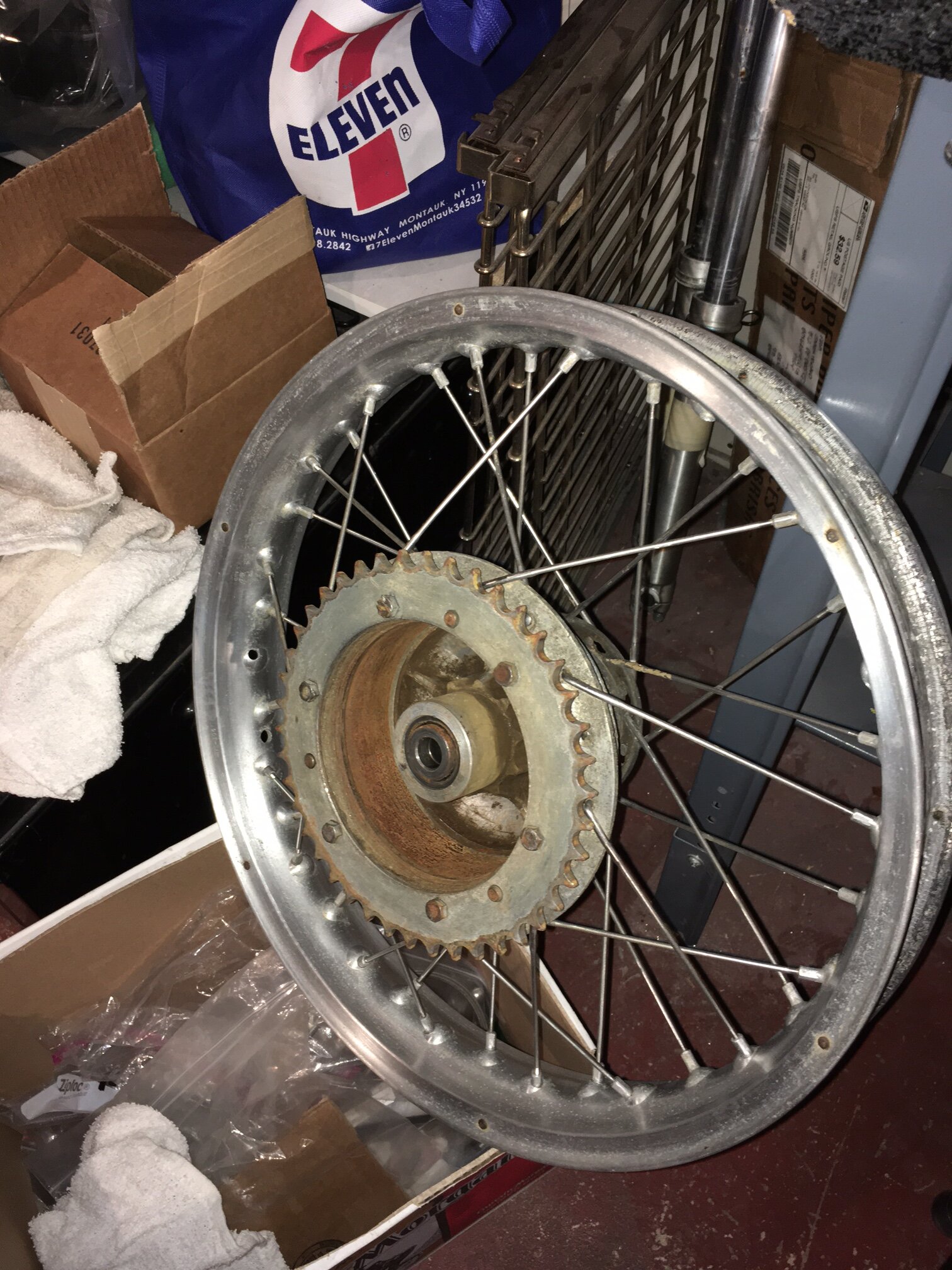

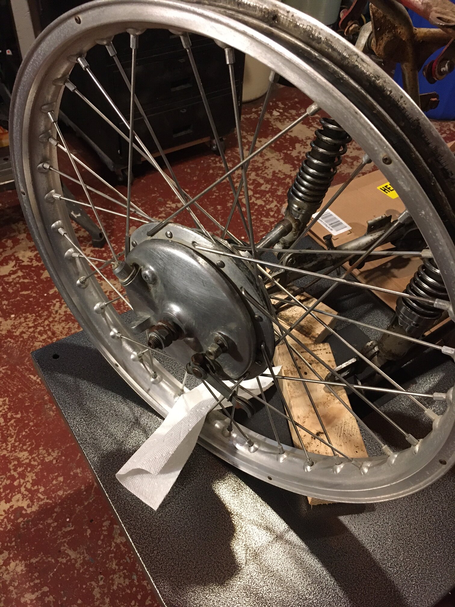

Today I cleaned up the rear wheel, waiting the spoke to replace the 2 broken one.

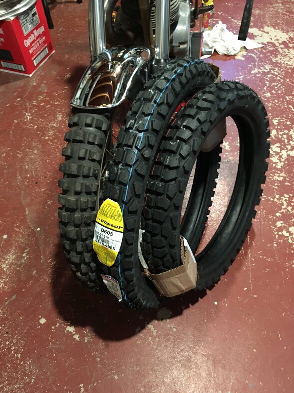

I also got the tires at a fare price (105 USD).

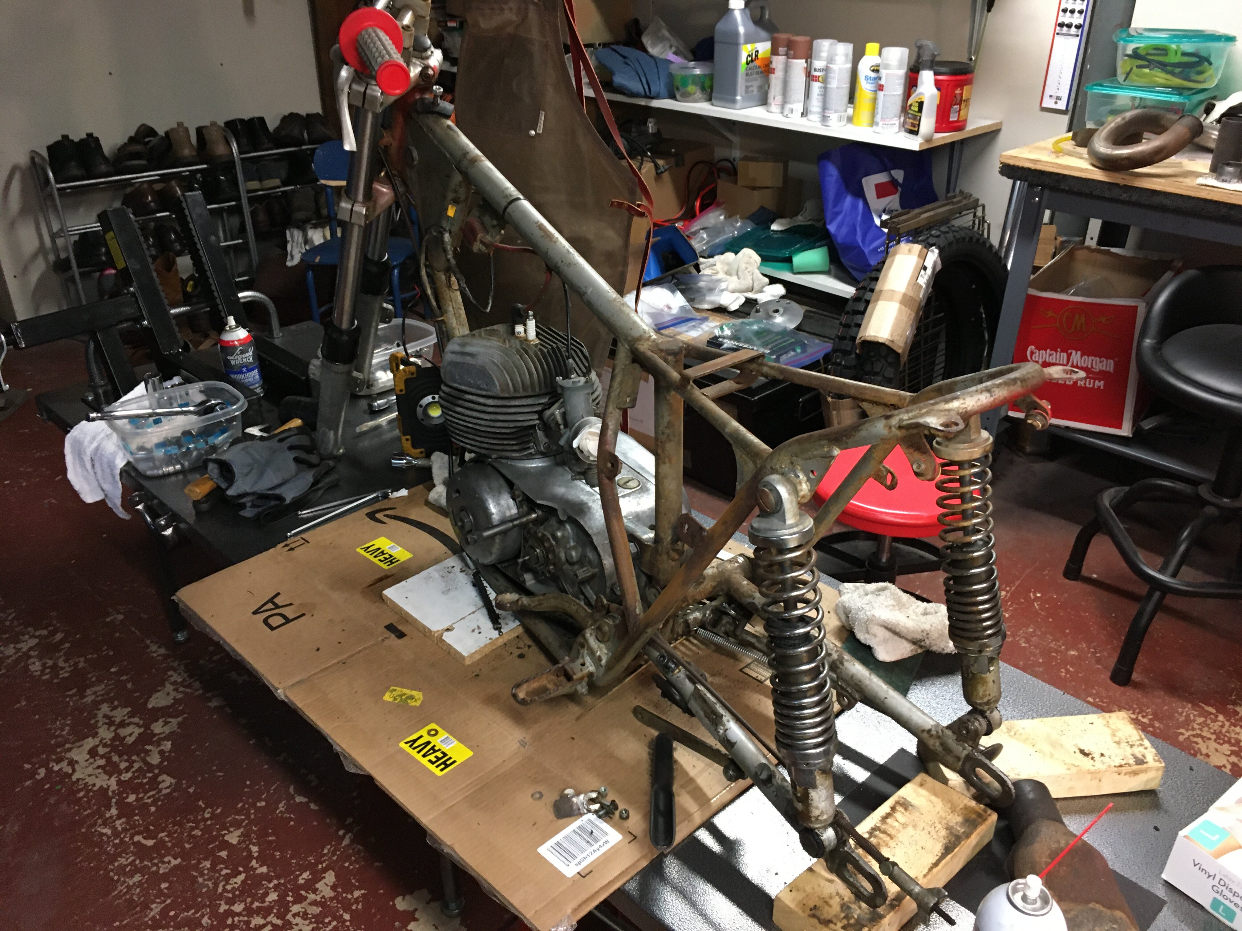

Today job: Kickstand...
The kickstand was broken and the shaft rusted inside. I had to cut it and to do a new pivot.
I need to find a spring: Could you give me the size from the original one 😉?

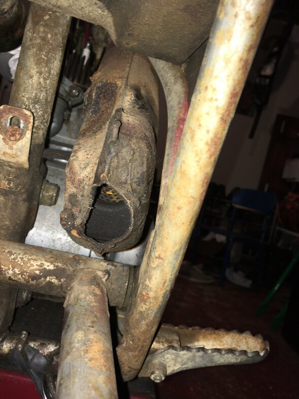

Other item is the exhaust, my is badly cut 🤮
I found a cheap one in UK, to repair the old one is possible however the final cost will be the same (Welding, sand blasting, painting....).
Wait and see...

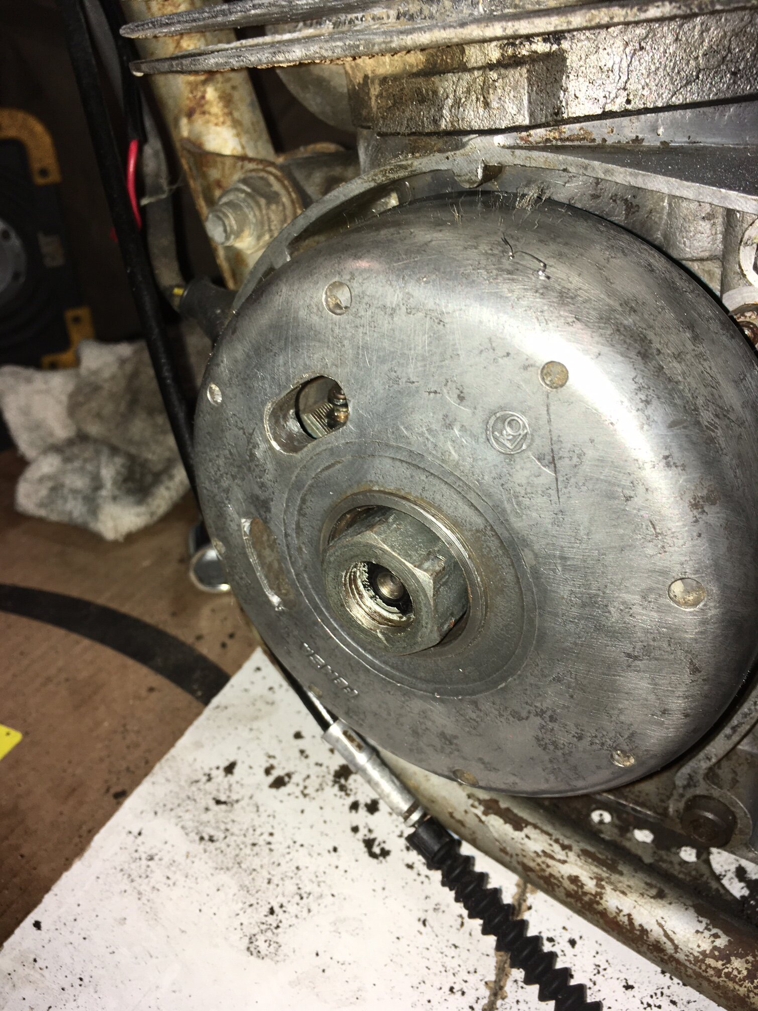

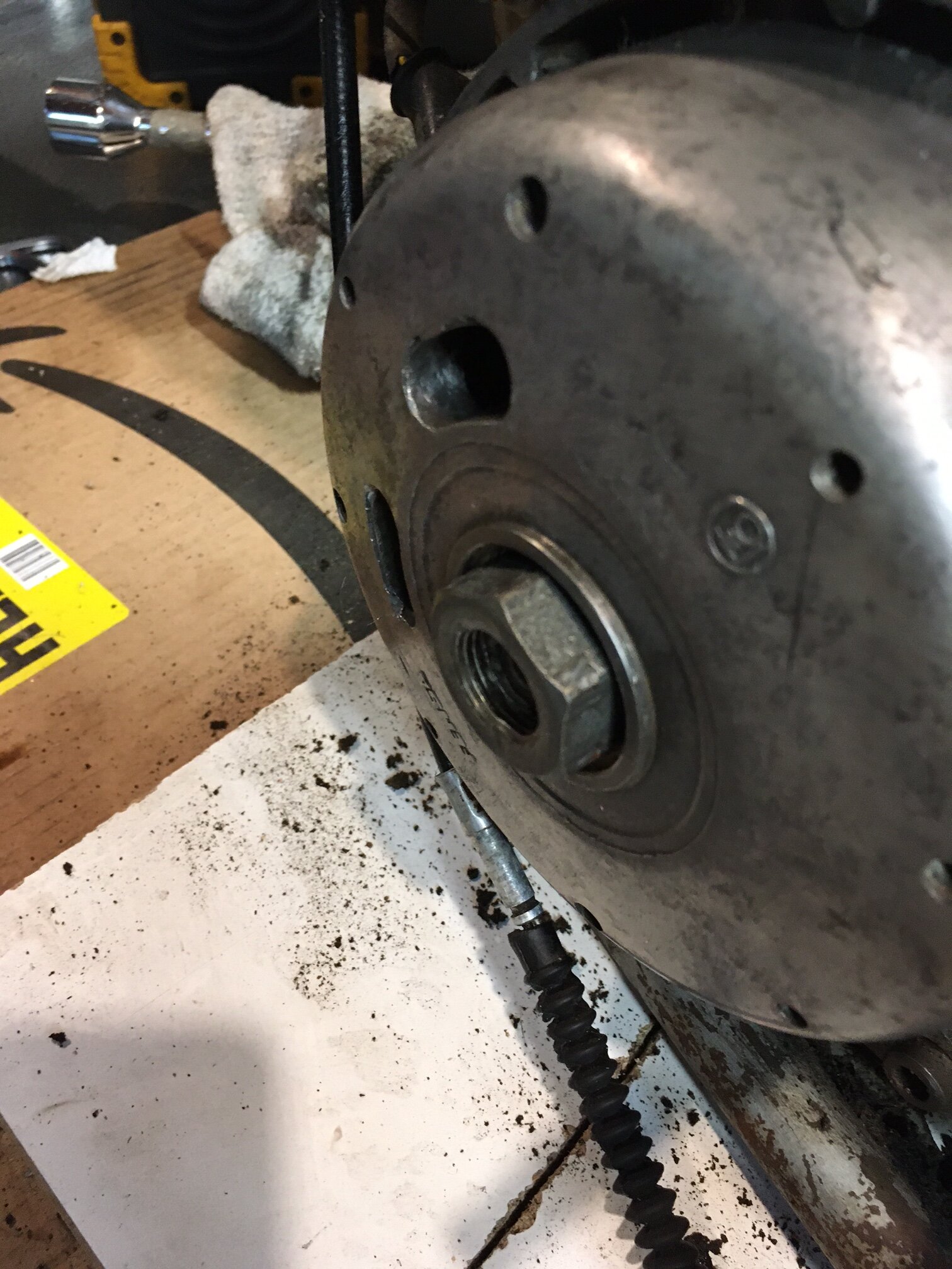

Question:
The nut from the flywheel seems not correctly in place ?
Thanks for the advices 😏
20 hours ago, Divouneh said:
Question:
Yes that's the normal arrangement

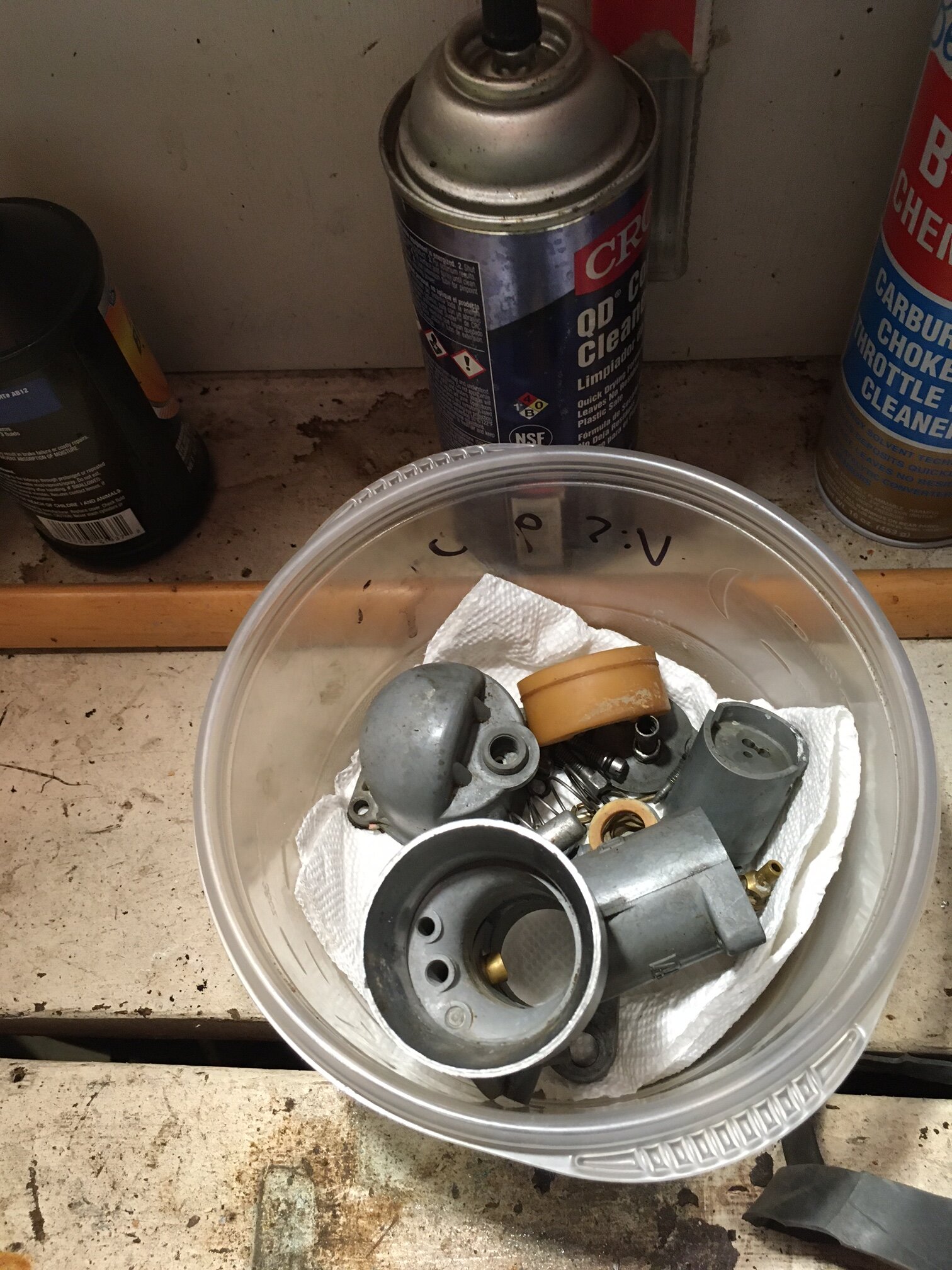

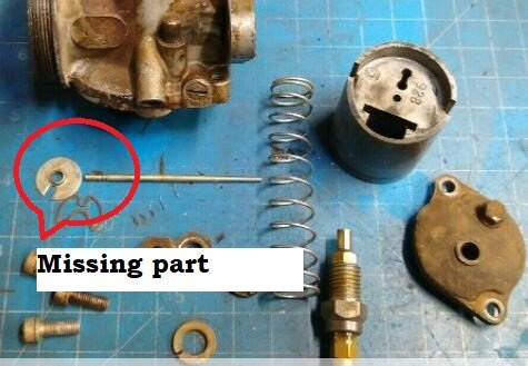

Carburetor is ready for inspection, the plate to keep the cable in place is missing 😔...
After investigations, it seems some Amal have no plate to keep the cable in place.
no one has had such issue ?🙄

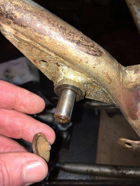

Broken screw, the one to keep the rear shock in place 😪.
The others one are removed.
I will try to drill it with a "reverse" bit later, it's not a big issue..
