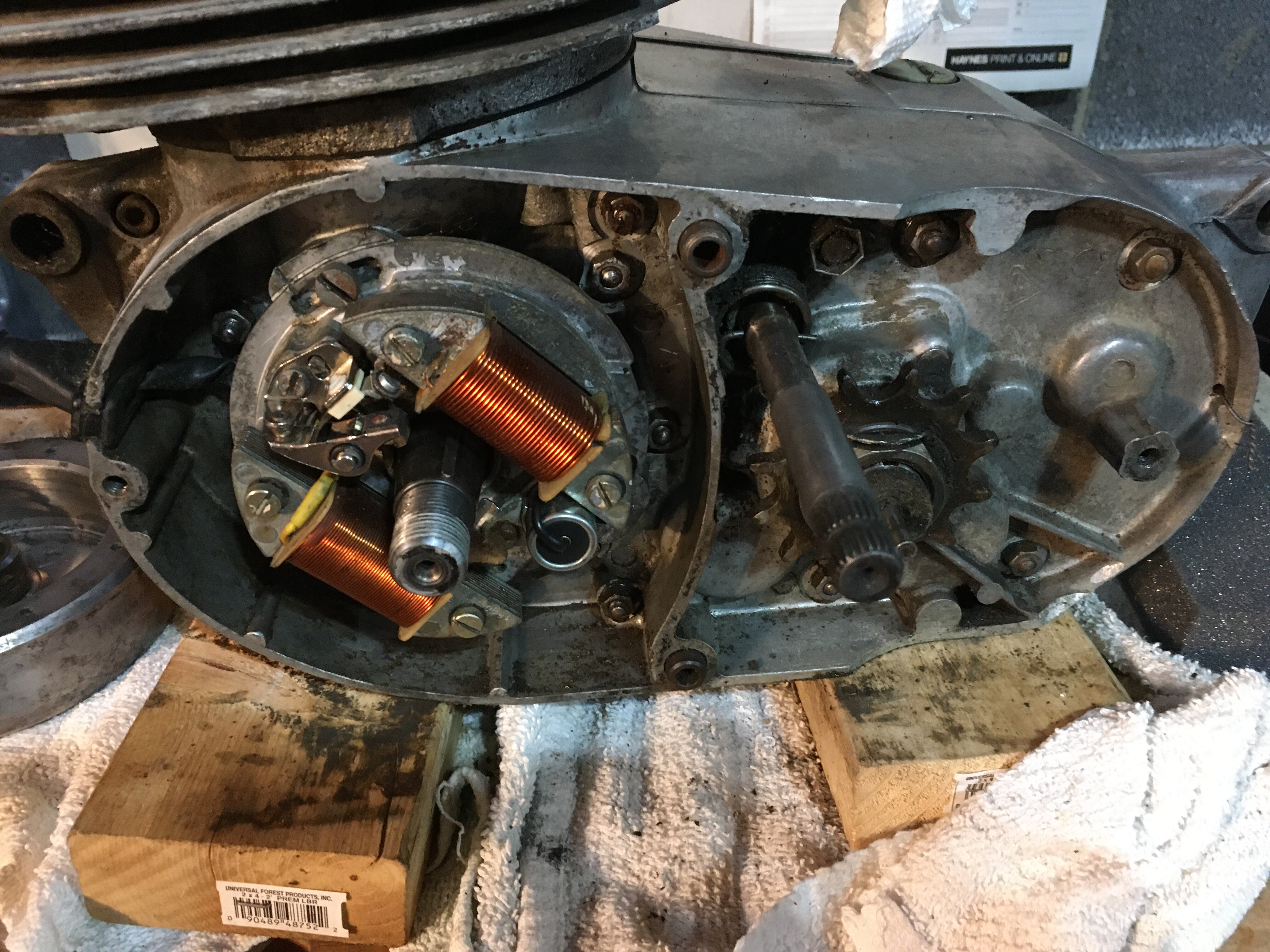

Fly wheel is removed, no real corrosion. Electronic ignition is schedule with 12 DC for the light and accessories.
