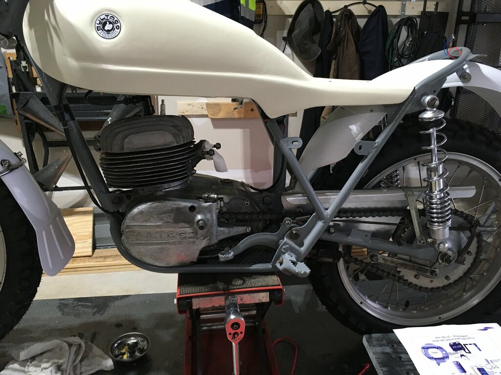

I am working in the left side, needs the carburetor and clutch cable (next job in the schedule 😊).
I have a lot to do in the right side: tightening and adjusting the clutch, exhaust to install with custom parts.

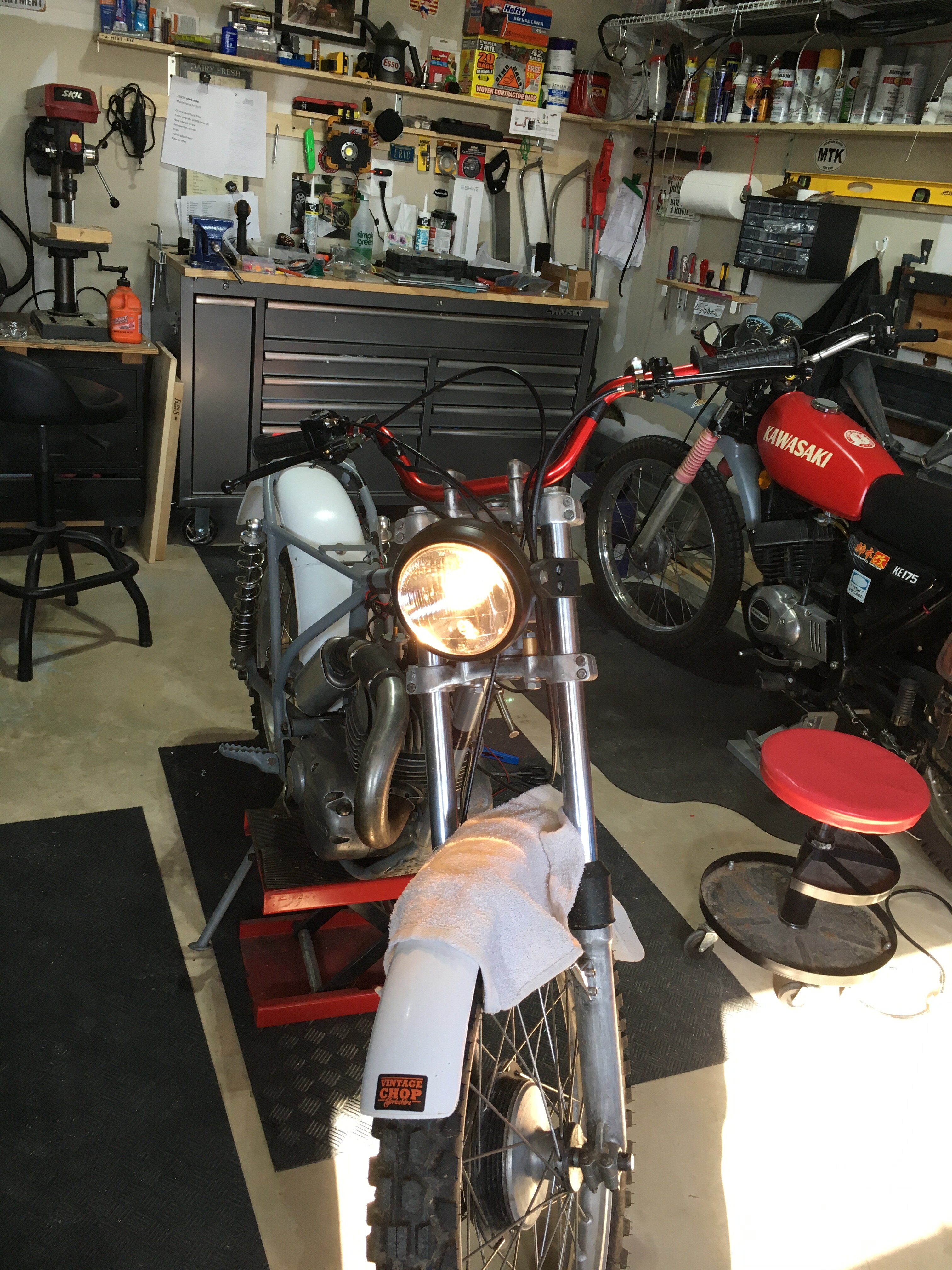

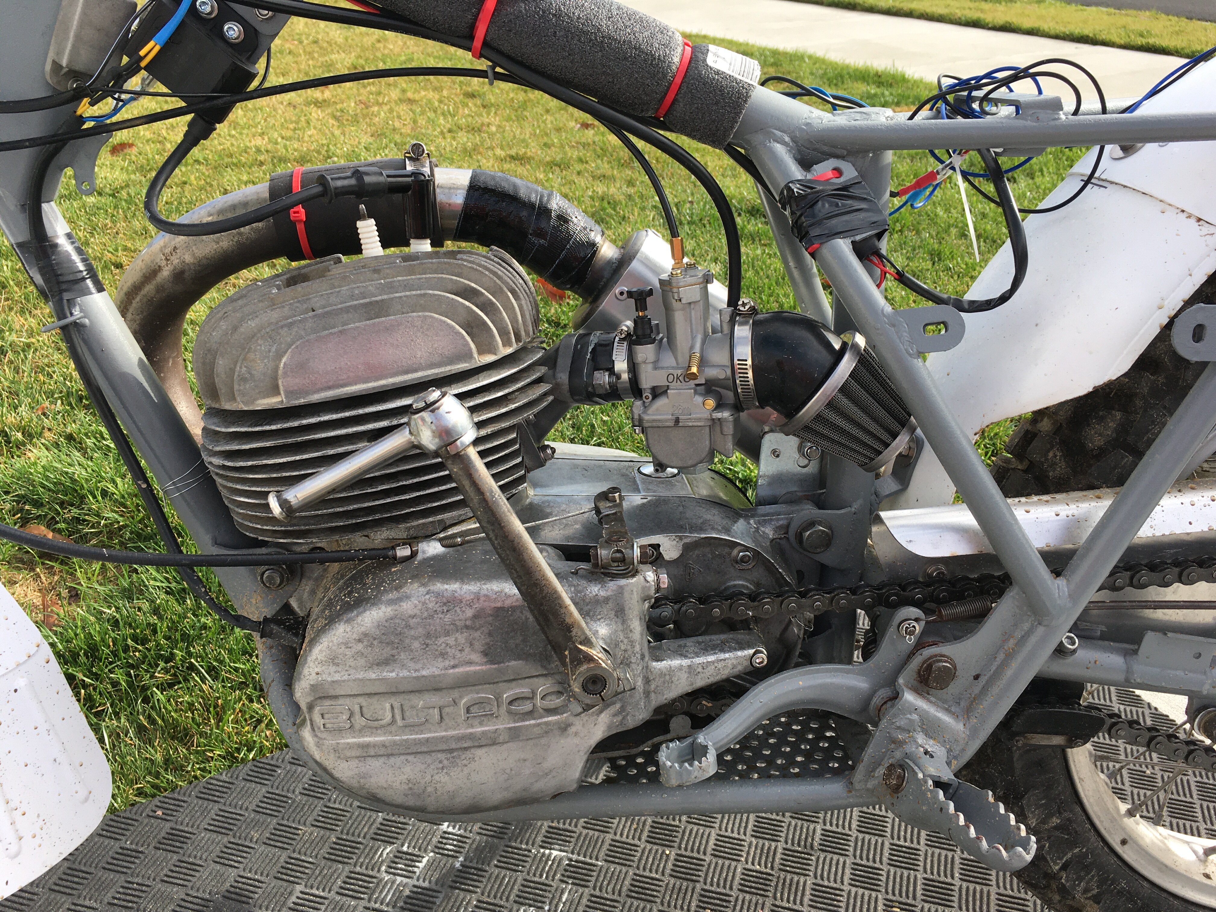

Today new jets for the carburetor, air filter, lights  connected for tests. Without battery you need to proceed the electrical tests when running 😉....
Great progress, engin is now running without choke, restart easily, final adjustment will be done with the final exhaust. Tail light has some minor issues as loose contacts, ...

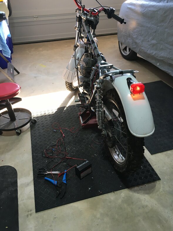

Electrical circuit done (using my Honda 12 volts battery for tests)...

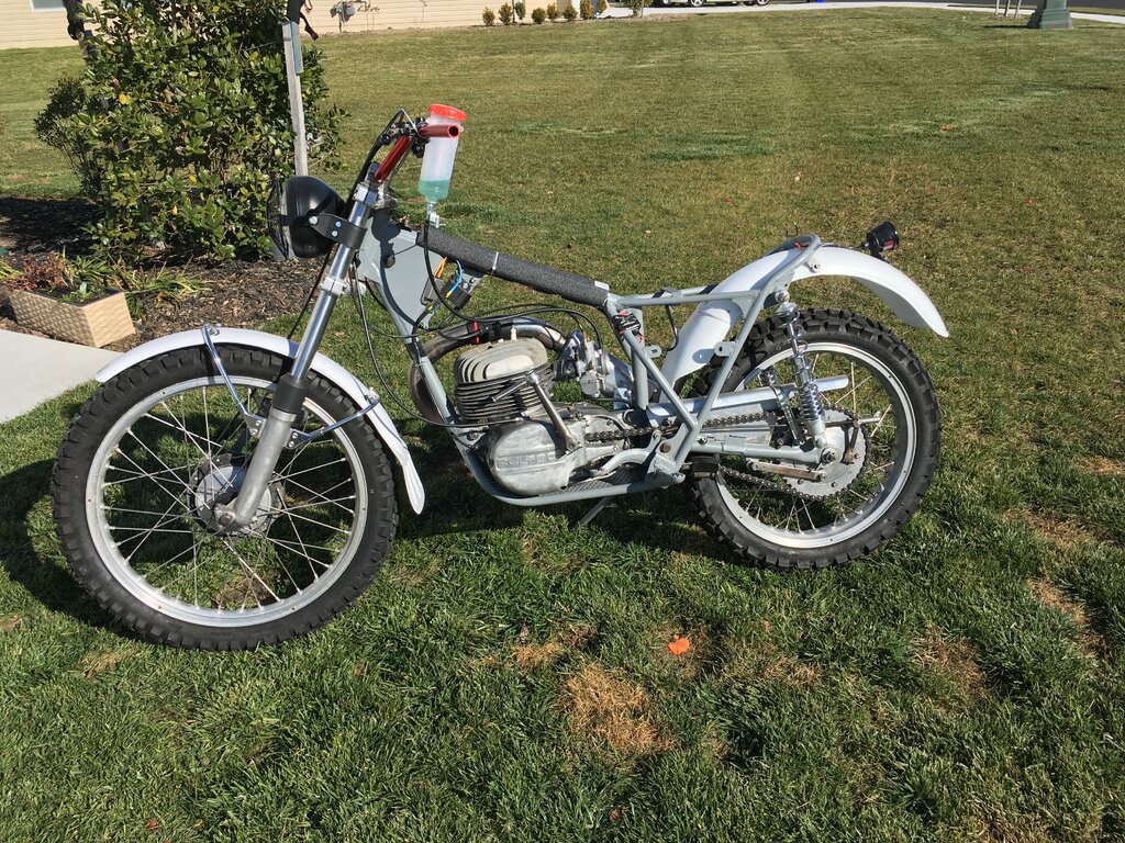

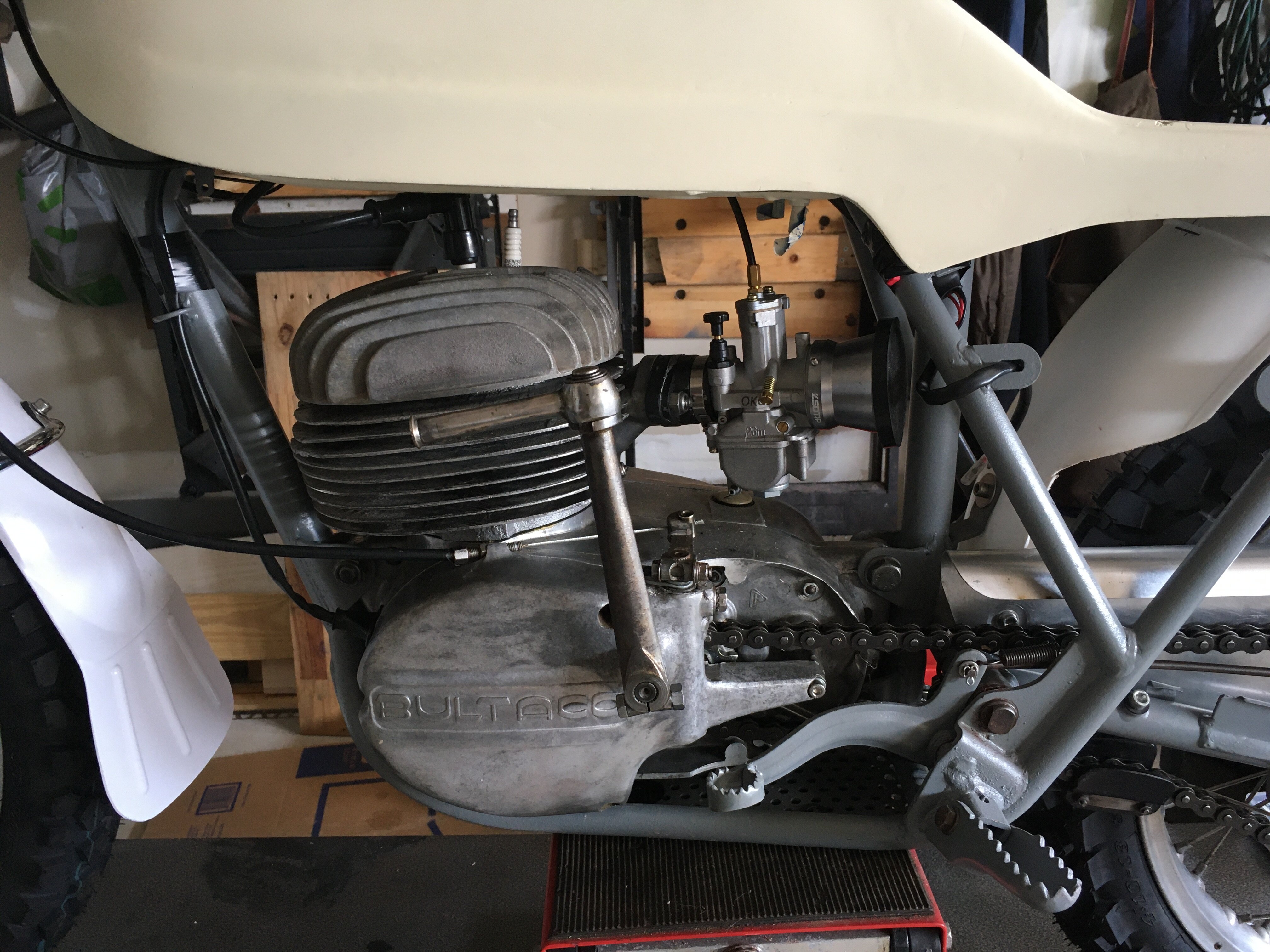

I already did some short running tests with a small gas tank. Soon on the road 😏
IMG_2260.thumb.JPG.12ff213f99820f1430e8f48dddb009fe.JPGIMG_2263.thumb.JPG.99aff40dd8d07724817240f365e0c9ed.JPG

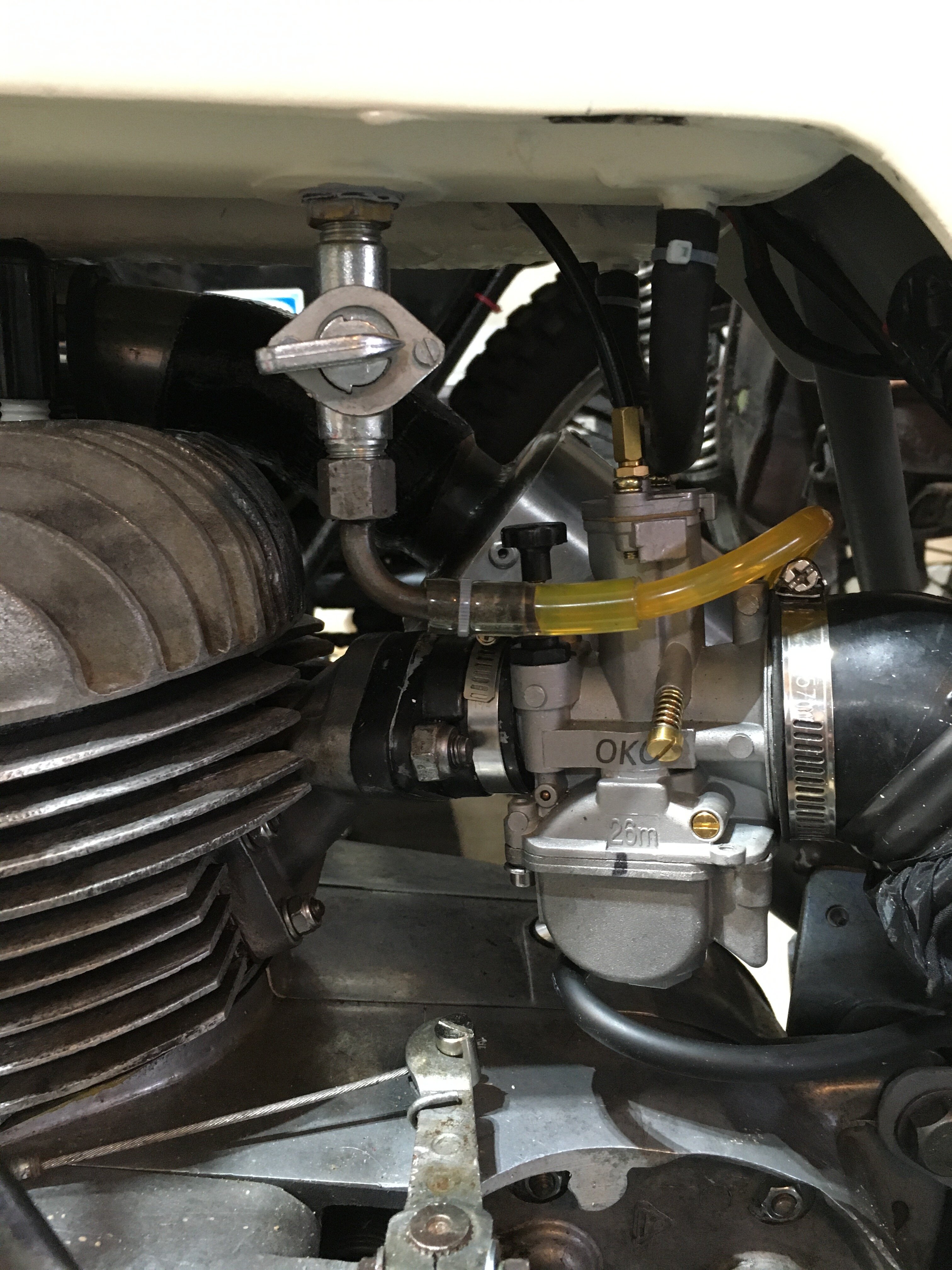

Waooh 🤣, first real run today with little dirt 🙂: This bike is amazing 😋...
Of course all is not perfect: gas tank went to close to the exhaust 🤥, idling is not clean 😒, front brake needs some adjustments 😌. Nothing very difficult .
We are far from the Japanese bike, good boots and the gears are going well 😏. Waiting my side covers and I will send my application for the registration... 2 years after the first post 😬.
Funny, don't forget to fill the gas tank for the carburetor adjustment 😝. During the first tests,  the idling was not stable, I refilled the fuel and have now a much better situation. Starting cold or starting hot is easy 😏. Brakes are working now 🥶...
I installed shorter rear shocks (320 mm now were 340), I am short and starting is easier, look is better for me (more trial style).
