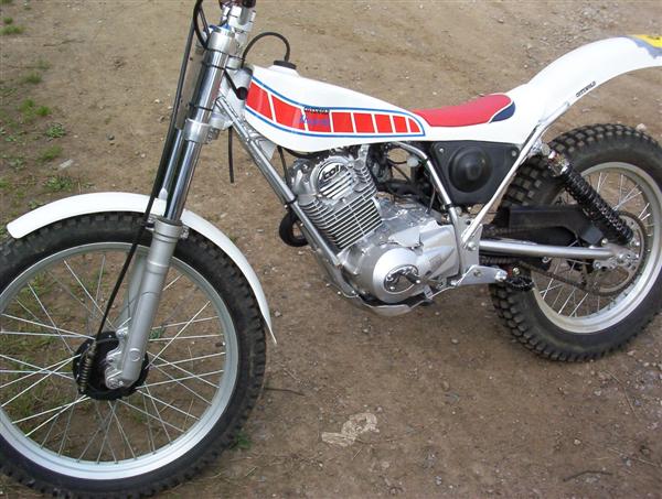

Fancy doing something a bit different, I've seen a pic of a fourstroke engine in what looked like a TY twinshock frame, lovely looking machine.
I understand you can buy Chinese engines (Honda copys) off John Bliss for right money, I've heard one of these engines running and it did sound very sweet.
Has anybody put a fourstroke engine in a yam frame?? any major problems?

Hi there. Is this the kind of thing your thinking of? Honda clone engine in a mini majesty frame.
There has been some mention of these on the Yamaha forum in the past. i think yer man John Bliss builds them?
They look quite tasty eh
I got this photo off the web months ago.
Edited by LesGamble
Yes Lesgamble, thats the sort of thing I was thinking about, don't they just look lovely...better than any TLR eh :D
To buy the complete machine of Mr Bliss is quite expensive from what I've been told, I was thinking about doing something myself with and exsisting TY running gear and looking into buying a lump off Mr Bliss, I think the engines were going for
Edited by Marky G
Nice bike. Look how tight a fit that motor is in the frame. I wonder how much bickering goes on when it is entered in the twinshock class, seeing as it was built recently with up to date geometry etc. I know my Scorpa 125 a/c is frowned upon. Even though I will never win any medals. Jobsworths= not only in the work place. :D:D

can't be a bad idea, if it looks right it is right my father says and the chinese engine looks the part in the Yam frame, anyone any contact details for mr. bliss..
The Cotswold Majesty is indeed a good bike and performs very well. There's never been a problem with anyone moaning about them being ridden in the twinshock class as no-one, quite rightly, considers them a fiddle bike. The frame after all is a mini Majesty frame dating from 1982 and the engine just a copy of the xl/tlr type motors from the 70/80s. It's got modern forks but so what, it's not the only bike to have them, others fitted them a while ago. Drums not discs also.
I remember Jon telling me it is a bit of a shoe-horning job though to fit the motor and all the ancilliaries like airbox, exhaust etc. However, if you're planning to do your own, remember you will be starting with a Yam frame (175, 250 ??), not one of the Godden mini Majesty frames, unless you're planning to buy one of those of Craig Mawlam, so the frame will be a bit bigger with a bit more space available.
Thought about the TY175 frame and running gear Woody, there's loads about and right money too... my only concern would be height in the frame for the lump, I'll have to get me tape measure out on the 175 and the 250 frames.
