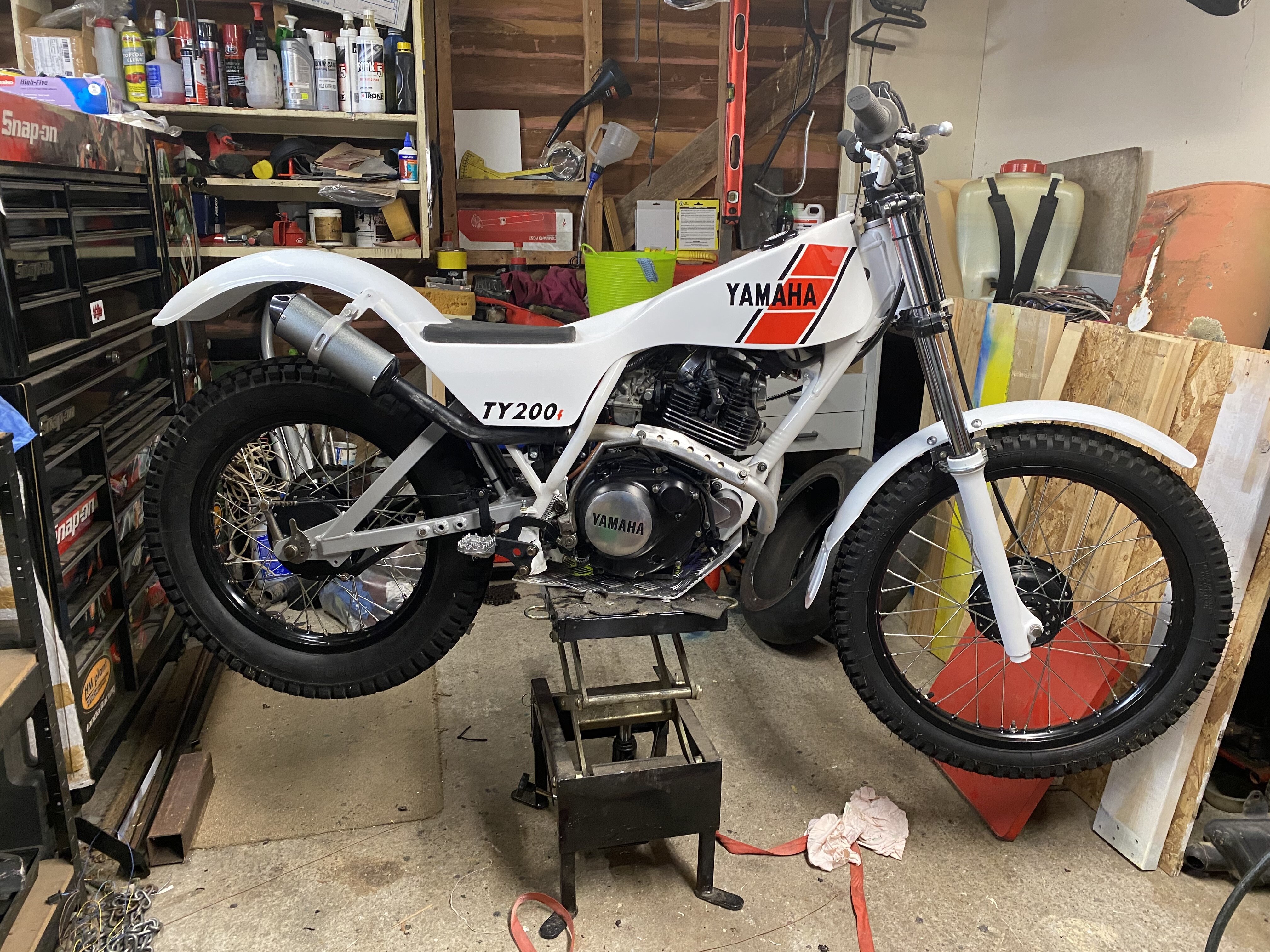

This is something ive been working on and is almost finished now. Just a few jobs to finalise to make it complete and lots of ride time to hone it into something hopefully competitive.
Wanted to build a Yamaha with this rear suspension just like Mick Andrews factory OW10. Ive built another one which is slightly different in areas with help from a friend who's helped me design and build the fibreglass tank/bodywork along with the paintwork.
A nice feeling knowing that there are only 2 in the world like this and we built them both.

fordigas, your NZ Yamaha 200 creation looks like it will be great fun and I can imagine it was great fun making it. Well done
