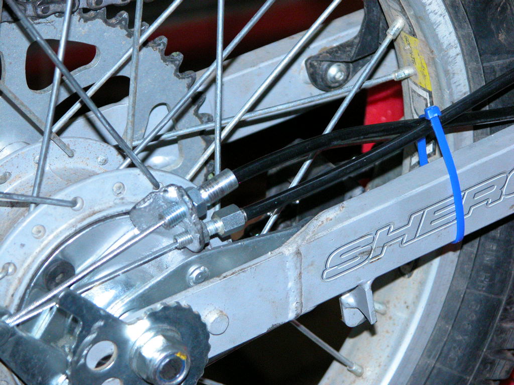

I did the Sherco 50's which is really the same principal, I just added the foot portion.
Anyway, not much too it, you could search on the Sherco pages here and find pictures of how I did it.
I chose to use Thomaselli levers that were available and had superior leverage.
You just need to pick what you are most comfortable, what is easily available too you.
You will need to modify slightly the rear drum, the pictures of how I did the sherco's are there, and they use the same assembly.

OK, trying to use this search feature is like pulling hens teeth.
Let me try and attach a picture.

Alan,
Once again many thanks for your advice and thanks for attaching the picture, it simplifies things.

The piece welded onto the top is a piece of 1/8" X 3/4" (I think) strapping. Should be something like 3mm X 12mm strap, bent 90, welded neatly both sides, drilled and tapped for the adjuster.
It just hangs about 1 1/2 threads, but you lock it in place with the nut (gently)
I do not believe that any have failed.
You have to open up the pinch bolt hole a bit too.
I chose to use heavy duty motorcycle universal cables for front brakes on both the controls, it gives a more positive feel with less stretch.

The brakes are effective but just like most drum brakes meticulous set up, cleanliness and attention to detail are very important.
Watch, check, insulate, and check again, where you run the cable over top of the engine.
